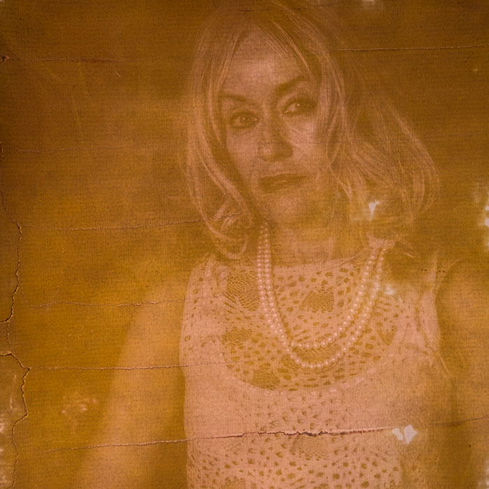

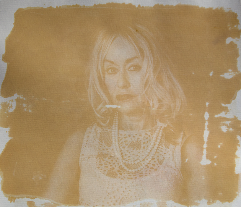

In my test I found that fixing for extended times in near-saturated salt solution causes the photogenic drawing to go pale yellow.
When redeveloped in Rodinal, after about 1hr fixing the print is still blackened but after 24hrs in near saturated salt solution there is little darkening , indicating the print is almost completely fixed.
However, IMO the pale yellow prints are of no use for display.Technically, the yellow color is probably produced in the same way as thiosulfate fixing as discussed by Dr Mike Ware:
https://books.google.co.uk/books?id=yA2N8Zl7JL4C&pg=PA78&lpg=PA78&dq=photolytic+silver&source=bl&ots=9HPDaehwET&sig=e_lrnsqPNT83GHU7M5zcm1qV4F8&hl=en&sa=X&ved=0ahUKEwiIy8jX65_UAhUFBMAKHbslAaQ4ChDoAQg6MAc#v=onepage&q=photolytic silver&f=false
I gave up on extended salt fixing and made a print by the traditional Fox Talbot stabilization method described in the link( pic), it is rust color rather than lavender.
https://jkschreiber.files.wordpress.com/2016/02/theartofphotogenicdrawing.pdf

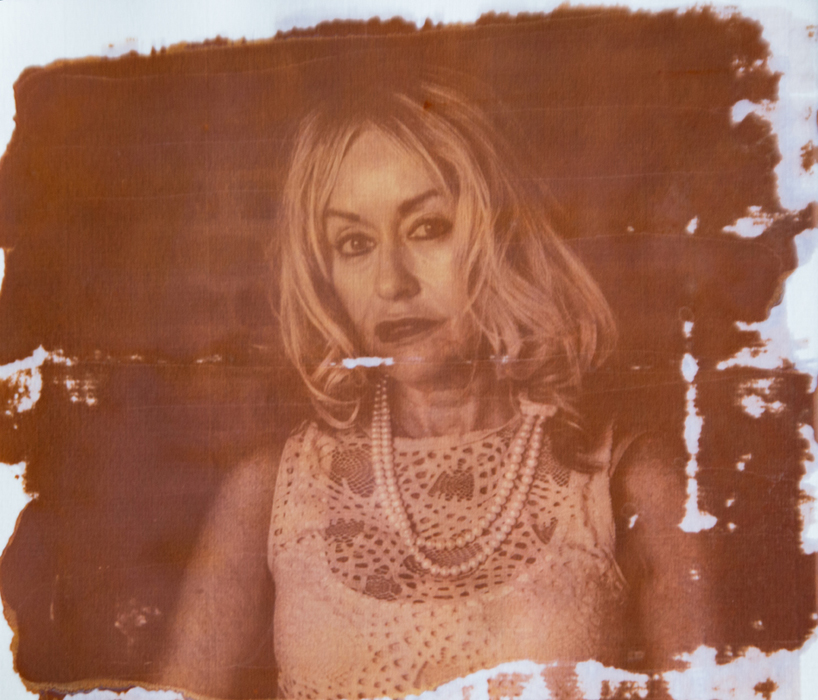

http://resources.conservation-us.org/pmgtopics/1993-volume-five/05_10_Reinhold.pdf
Here is a description of Fox Talbot's early process (though any negative could be contact printed on such paper).
Since the stabilized print is darkened by light I tried to fix one instead, by immersion in near saturated salt solution at room temperature for 24 hrs.
The brown-purple pic is of the paper after exposure to sunlight for 3 min and washing ; the yellow pic shows the same after fixing in salt solution for 24 hrs.
A sample of the yellow print was placed in Rodinal !:50 for 20 min with some agitation, it did not darken, confirming that the yellow print was fixed.
So fixing of prints in salt solution is possible but who would want a yellow print.

Hi, Alan:
Thanks for sharing your results. These simple but well thought-out experiments go a long way in clarifying, at least to my mind, what is happening when using the salt as stabilizer/fixer. My sense is that the color change is related to physical removal of the silver chloride resulting in smaller effective grain size responsible for light scattering - yellow being shorter than the red wavelength. Therefore, it would seem that unfortunately one can not remove the chloride (complete fixing) without the color change.
A question: How would the color of the exact same print post-salt compare with one that is fixed with hypo?
Good work!
Great link as well, by the way. Interesting that the Getty people learned their lesson for displaying an original Talbot print out in the open.
:Niranjan.
I don't pretend to completely understand this. You are suggesting that somehow the silver chloride contributes to a larger grain size, for example, some AgCl could be involved in "holding together" the larger grains. If that is true, and it fits everything I've seen, then it does mean that it is physically impossible to fix the print without changing the color.
And in some ways the situation is even worse than you have suggested ( from the standpoint of trying to preserve the color ): if it was just that simple, it might be possible to heavily overprint and then recover the original color in the fix. But that doesn't work, and a heavily overprinted salt print will still turn brown in salt water and in hypo. So even if we overprint to the point of bronzing, when the AgCl is removed it divides even the biggest grains into small ones, just more of them! i.e. the AgCL is throughout the grain structure. Making bigger grains during printing cannot help.
I don't know if this is all true, but it sure fits the facts of experience very well. Honestly it's a little disappointing... I was still holding out some hope that the original color might be preserved somehow. Clive's approach of photographing the original with color film might be the closest we can get to "preserving" the look, short of storing an unfixed and unstabilized print in a dark drawer.

Ned:
That is my working theory at this point. I am sure it probably is simplistic and there are other interactions as well that affect which light wavelength gets out of the paper. Unfortunately there is no way of telling for sure unless one (not me) has access to a high powered electron microscope that would be required to test the theory.
As far as trying to manipulate the scattering particle size, I wonder if it might be more effective if you start with bigger AgCl particles in the first place - may be by eliminating gelatin to name one possible knob to turn. Or do an equivalent of emulsion "ripening" to grow the grains after sensitization. If you start in micron range before exposure, the resulting exposed print should be neutral. Then let the fixer "leach" it back to the particular sub-micron size that gives you that magic color. It sounds like a lot of work to figure out the exact conditions, though. Another route could be to do partial toning and additive toner like selenium or sulfide to build back the size to the desired color.
Happy experimenting!
:Niranjan.
