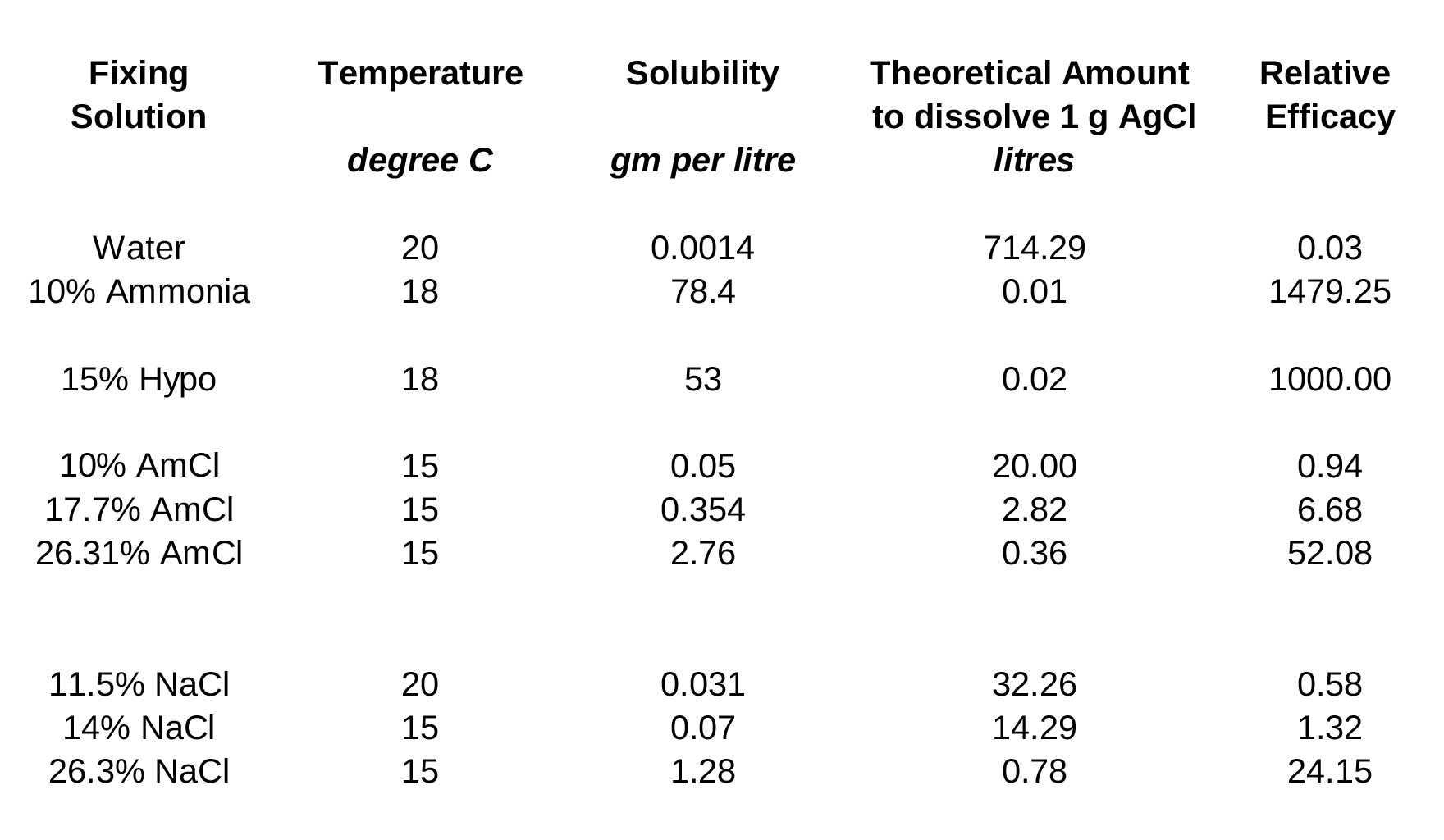

Based on those tables in Salt Lake Metals, I did some quick calculations on what it would take, theoretically, to dissolve 1 gm of silver chloride in various solutions. See the attached table. The temperature vary slightly but for comparison purposes, they should be close enough. The last column shows how the others compare to 15% sodium thiosulfate (set at 1000) in terms of efficacy to dissolve AgCl.
10% Ammonia is actually better than hypo. The others are at least an order of magnitude less effective. Increasing the salt concentration towards saturation will obviously improve the solubility, so will higher temperature. However if I were to venture a conjecture, the kinetics of dissolving and carrying the silver chloride out of the paper will become a significant countering factor at higher concentrations.
So it would seem that, yes actual "fixing" can be done with sodium chloride in addition to just 'stabilizing" the silver nitrate. But how fast and how efficient is a question.

So it would seem that, yes actual "fixing" can be done with sodium chloride in addition to just 'stabilizing" the silver nitrate. But how fast and how efficient is a question.:Niranjan.
If your interest is in how fast and efficient, I would suggest you have lost the plot about the aesthetic of photogenic drawings.
