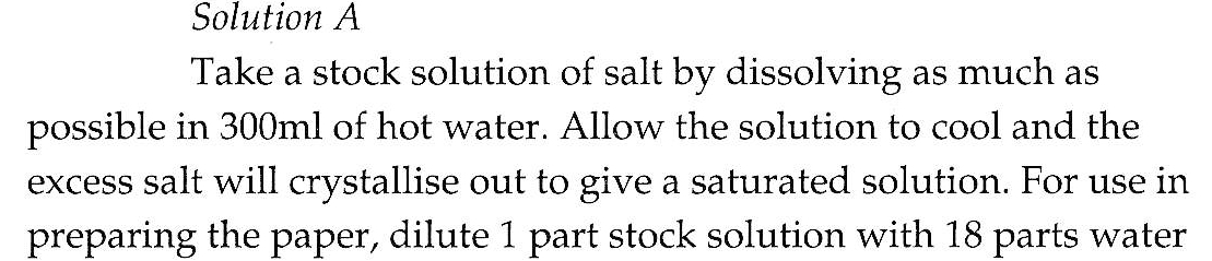

https://jkschreiber.files.wordpress.com/2016/02/theartofphotogenicdrawing.pdf
maybe the dilutions are different between salted paper prints and photogenic drawings ?
the pamphlet talks about talbot's photogenic drawings .. unless they are the same thing?
I don't own them, but I have read the original notebooks stored in the Bradford museum. The 50% you mention is in fact about 20% for sensitisation and not for stabilisation.
Let us be clear: Had you read the post of mine you actually quote, you would note that I am quoting the data sheet from the FT Museum linked by john's post above. You can find it here, for reference:
The relevant parts can be found on pages 6 & 7.
On page 6 you will find the following:
Take a stock solution of salt by dissolving as much as possible in 300ml of hot water ... for use in preparing the paper, dilute 1 part stock solution with 18 parts water
That equates of course to the normal 2% we normally use for salting paper.
On page 7 you will find the following:
Fixing the image ... immerse it in a strong solution of salt for a few minutes [use the stock salt solution diluted 50%]
Furthermore, CLive, please don't post obscene personal attacks on me which have to be edited by the moderators to remove. I doubt you'll have the grace to apologise to me, but your attitude leaves something to be desired to say the least.
