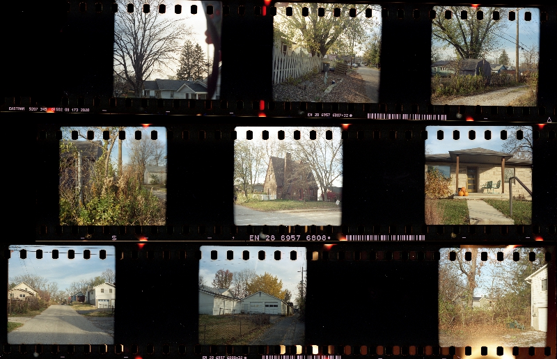

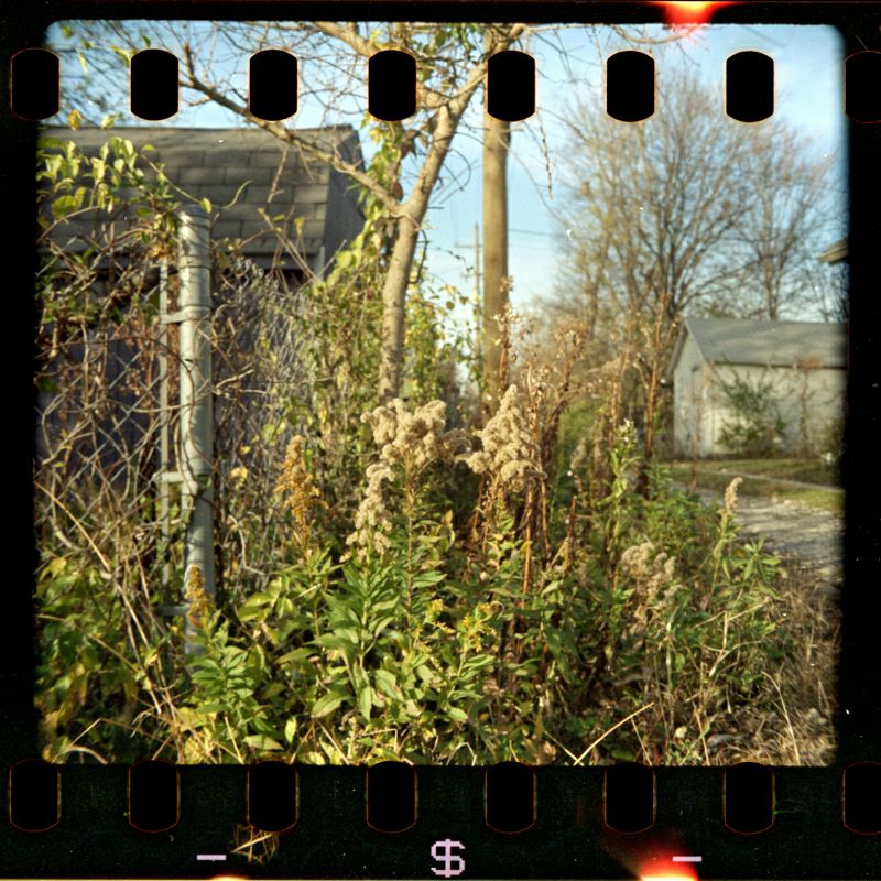

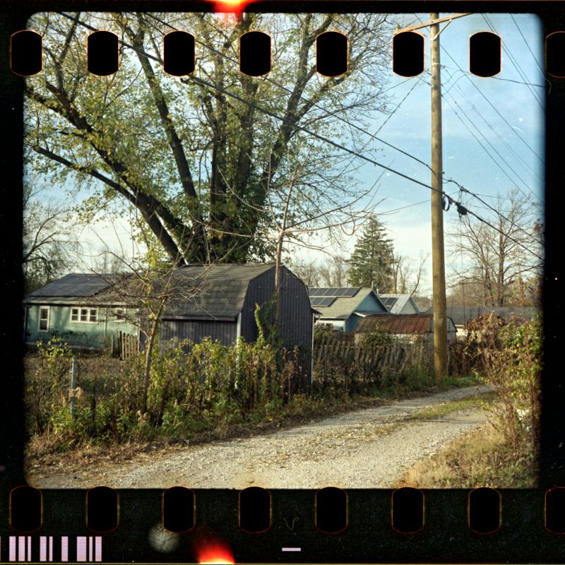

I had to avenge the C-22 Kodacolor, so I exposed an ad-hoc load of Vision3 250D a bit earlier. It went in before some 35mm & 16mm, so the chemistry was fresh.
The results seem mushier than the b&w but I still like the rendering.
This C-22 Kodacolor had a silver based antihalation layer which would further complicate b&w processing.
