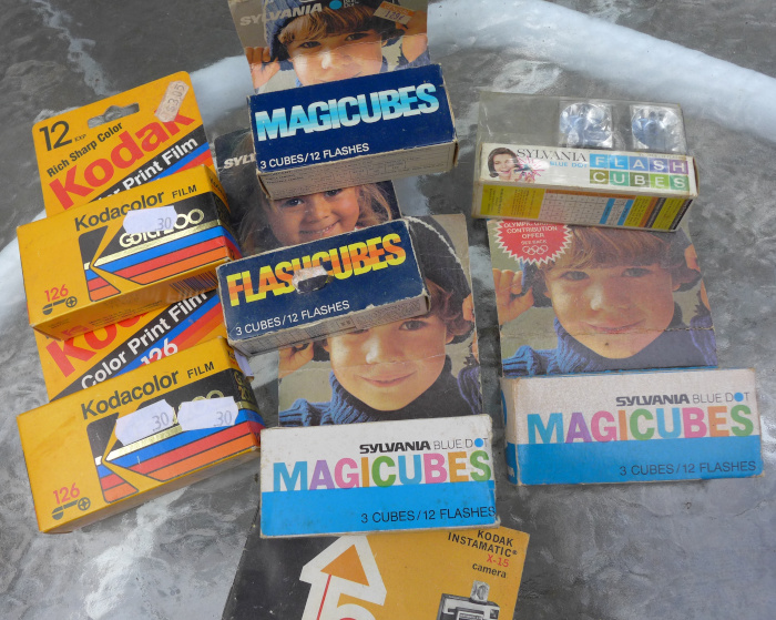

I had no idea I had these, probably a yard sale a few years ago?
Film dated 1990, 12 Magicubes blue "X" type (the good stuff?!?)
How to process the 126, no idea!

Some of those are the older electrically fired Flashcubes, rather than Magicubes, unless they've been reboxed.
The Kodacolor, dated 1990, should be C-41, so anywhere that takes 35 mm film should be able to handle it (if they know how to open the cartridge, that is). Film that old does require actual stabilizer, so you might want to plan to send it to a lab that can give it that little extra.

If you process it yourself there is no difference from 35 mm C-41 color negative film as Donald said. The cartridge would usually be opened by brute force (twist and rip open). It the film is not exposed you might be better off selling it to collectors and getting fresh film instead. In my opinion it is not worth the effort provided it is a 12 exposure cartridge for a pretty basic 126-type camera.

That is correct but with a film that old ( 30+ years) I wouldn't be too worried about stabilizer or lack of it. Modern C41 (since around 2000) doesn't use the stabilizer (with formalin), it uses a final rinse.
Honestly, don't over think it. If you are going to shoot the film, then don't fret over the processing of it.

Yes, formalin-based stabilizer was needed for C-41 up until the early 2000s. If E-6 stabilizer still uses this, you might be okay using that for home processing -- or as suggested by @foc just don't sweat it and either get it processed however, or sell the unopened boxes on eBay and get one of the new 3D printed reloadable 126 cartridges to put your own 35 mm film into.

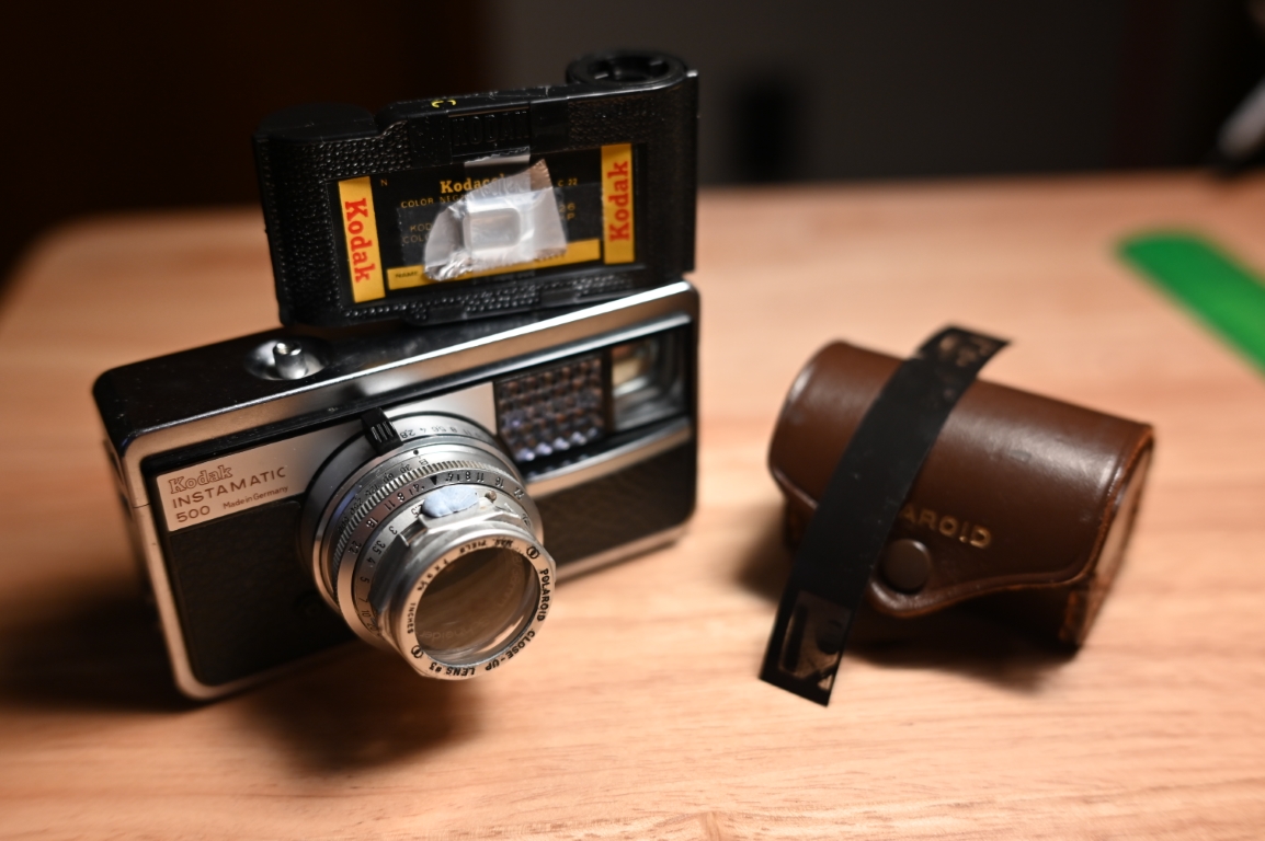

What happened to the camera? I just split a kodak cartridge for bulk loads into an Instamatic 500.
Dec 29, 2018
982
USA
Traditional
35mm film functions well with an original 126 cart in the Instamatic 500 if you do a blank exposure for the extra advance. The 126 split cart is a bit less prone to light leaks than 110 but not perfect.
The lens is partially collapsible and gruesomely sharp. The Gossen selenium meter is *dead on* with an ISO 80 cassette, according to a modern Gossen Sixtomat F2. A great little camera if you can deal with the odd film format. You won't save any film given the fussy advance mechanism.... but you do get a smaller-than-FX frame with at least one row of sprockets.

I taped a portion of the original backing paper into the cartridge to help with flatness. I can see light scratching on the first few frames on the base side but they don't appear in scans, with this film at least. The transparent windows on the cart and camera were both foiled over, but no additional sealing added to the camera back, which is often need for reloaded 110.
The results are almost good enough to saw off the sprocket feeler and source some unperfed 35mm film... almost 🤠
