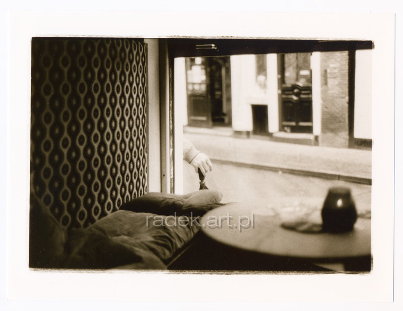

Do you think Forte Polywarmtone RC would be of any use after a few years kept in the cool storage? The last time I used it 1-2 years ago it was okay.
I've got lots of FPW-2 left (too much I think).
By the way, I managed to get it printed in sepia, but can't remember how I did it :smile: Is this possible it was Bromophen?
You can certainly sepia tone it. (Caveat - I've never used it but other WT papers sepia tone nicely as do many neutral papers though the results are rather different. I routinely brown tone Ilford MGWT.) I don't know any paper that produces a real sepia look without additional toning.

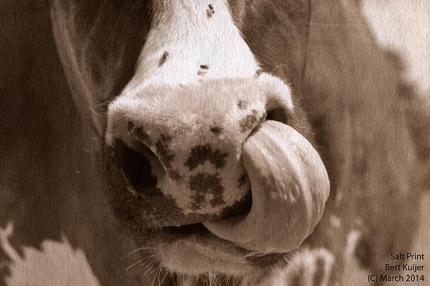

Salted paper print process does.
This is one of my prints:
attachment.php
Salt printing is an old process technique from 1833, whereby paper is treated with a solution of salt and silver nitrate and then subjected to outdoor exposure (sunlight) or an indoor UV lamp. I used a lamp this time. I love this process for its simplicity and beauty of the prints.
Well yes. I should have said - I am aware that some other process give such a result. I meant I didn't know of a regular developing out silver gelatin paper that did so in the usually available developers. I could always be wrong though, of course. :smile:
Well, the thing is that sepia appeared without any other treatment. And no, it's been fixed properly :smile:
That's really cool, but I've never seen anything THAT warm without toning (other than some alternative processes like above.) If you figure it out let us know!
