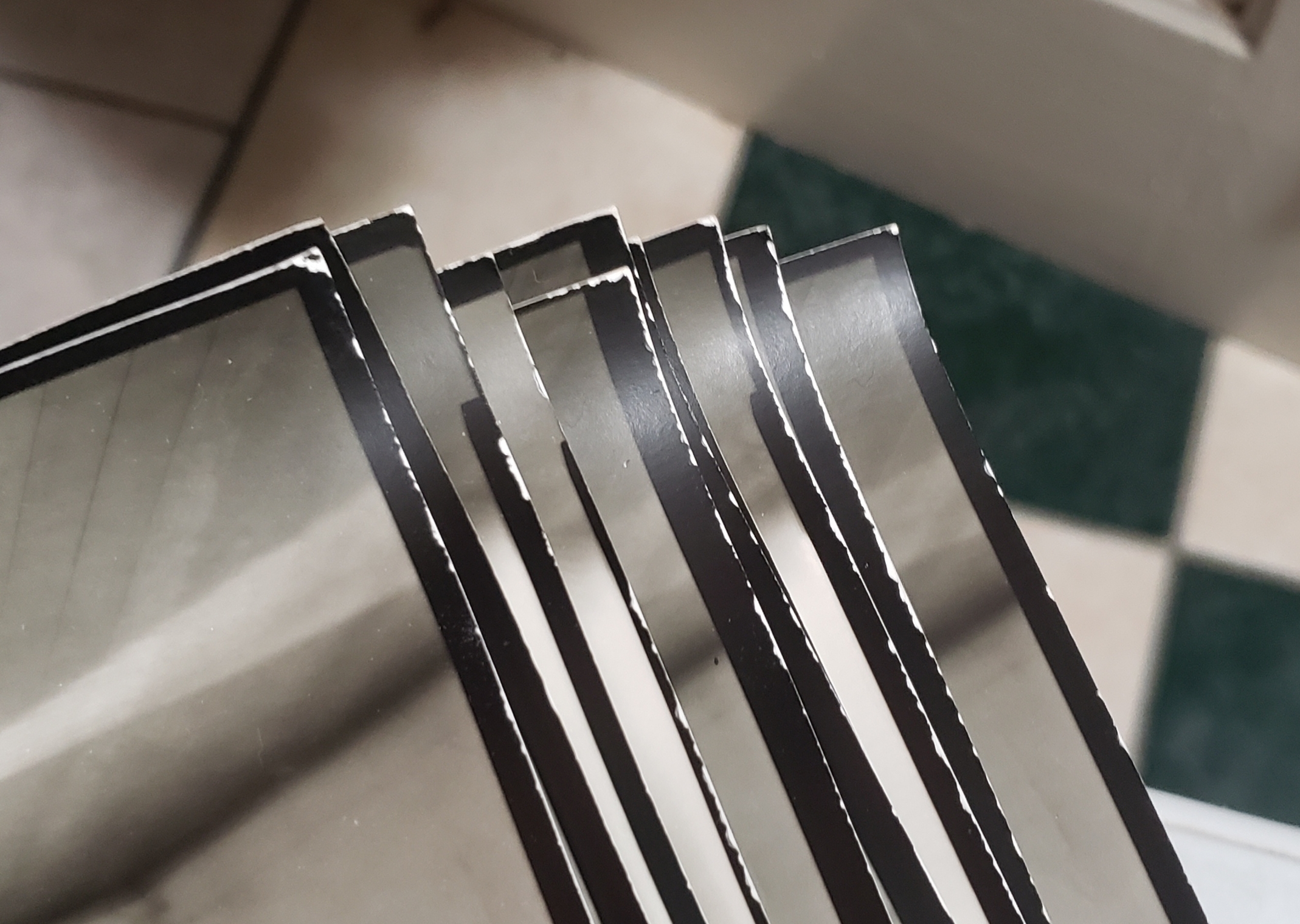

I printed on some of this paper today and noticed some edge frilling... loss of emulsion along the edges.
Anybody have a recommendation on how to avoid this?

No one will want to hear this. Hardener in the fixer. Same for other Foma fiber base paper. No big deal just use hypo clear. Followed by washing in 20 C water for 20 minutes (minimum)
I use Kodak rapid fix film strength with Hardener for a couple minutes. If you want to check for adequate fixing check with selenium toner.
No hard science to back this up, but Foma paper seems to have softer gelatin, which is (possibly) damaged slightly when the paper is finished at the factory.

@AnselMortensen you're not the first (and probably not the last) to run into flaking problems along the edges of Foma papers. I've personally never seen it happen. However, this recent thread on Fomabrom (a different paper of course, but same mfgr) at least shows you're not alone: https://www.photrio.com/forum/threads/fomabrom-variant-iii-emulsion-flaking.213430/ Sadly, I don't think it ever resulted in clear causes or solutions of the problem.
The problem has been discussed several times over the years IIRC. It's very rare for people to post examples, sadly. Perhaps you could be the change....the linked thread has one illustration which I think is the only one I ever saw. It would be useful to be able to see what it looks like on your end so that we at least can determine whether it's the same problem.

I love the olive tones I'm getting from the paper, I'm hoping I can find a workaround to eliminate the issue.
I am using it for contact printing 8x10 negs, and the black border makes the frilling pretty obvious.
I'll post a pic in a couple days.

It demands slightly more careful handling, and chucking a bunch of sheets into a tray and slamming them into each other isn't a great idea, but the only times I've had real issues were with a slightly less than fully sharp guillotine leaving a bit for a squeegee to catch on on some cut down pieces (and even then it was not a big deal) - and that sulphide toners can soften it a bit if used at stronger dilutions and longer times. I'd say Foma's papers are hardened to about 70s/80s levels, rather than with vinyl ethers. Major thing to keep an eye on is the longer fixing times needed.

The issue is a lot more evident for me when handling test strips, which might get cut and potentially bent and so forth less carefully than my actual full print pieces. I've certainly had some edge frilling in those cases.
I'll chime in here because @koraks referenced the thread I started on a similar subject several months ago.
Freestyle did replace the first package I bought and I haven't had an issue since. In fact some other sheets from the first box haven't exhibited the issue either. So it seems like it was an isolated case. The paper is very nice and I'll continue to use it, but I'll exercise additional caution while handling it wet just in case.

Reporting back....
Attached is a photo of the 8x10 contact prints with edge frilling.
However....yesterday I used @retina_restoration 's technique and contact-printed 5x7 negs with a white border on the SAME box of paper with the SAME processing regimen.
NO frilling.
Success!

Oh, that's pretty bad alright. I've never seen this, but I doubt I've ever printed all the way to the border on this paper, so maybe it did happen and I just didn't notice it.
Did the exposure extend all the way to the edge of the paper; i.e. black borders right up to the factory-cut edges?
