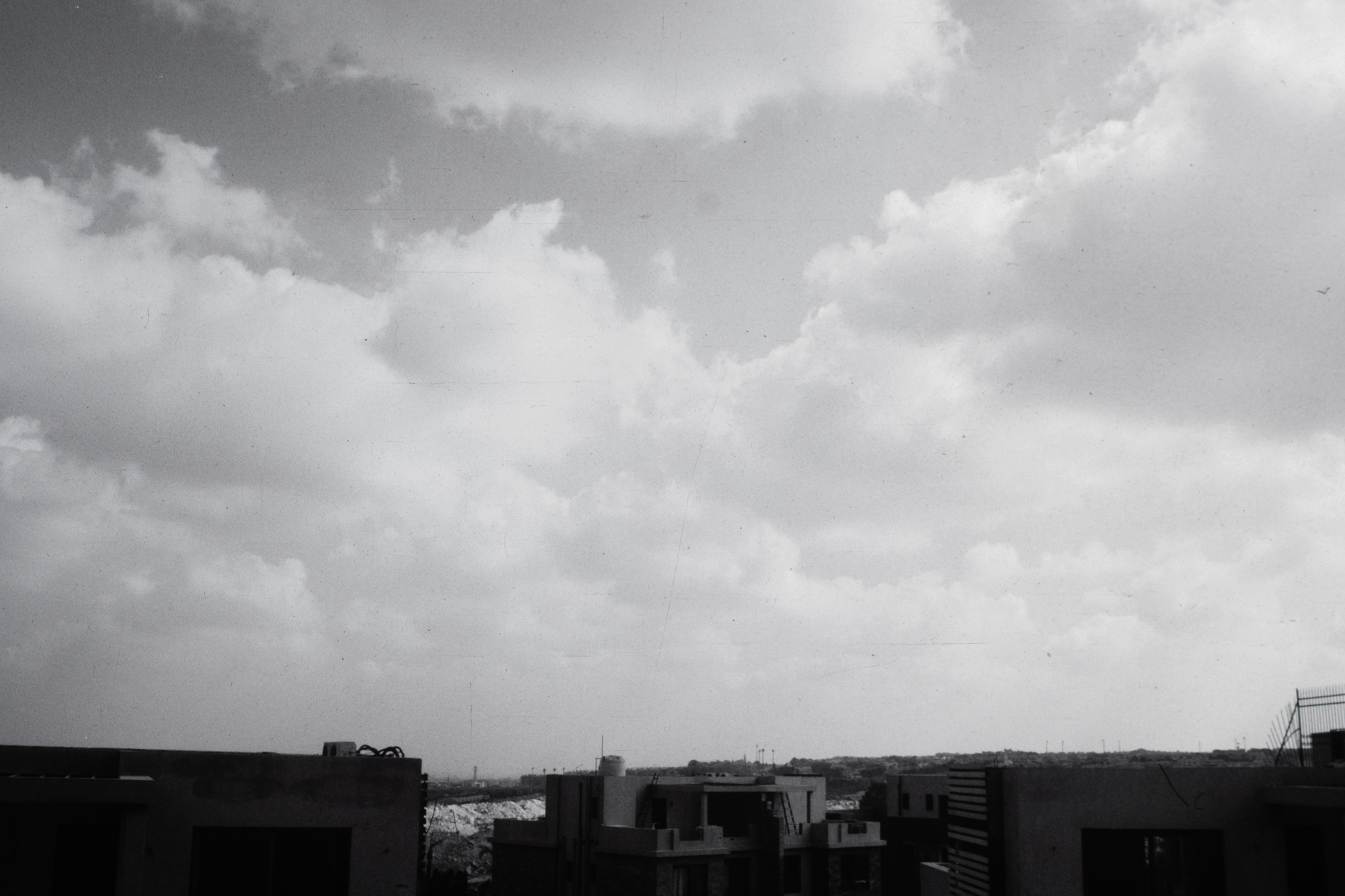

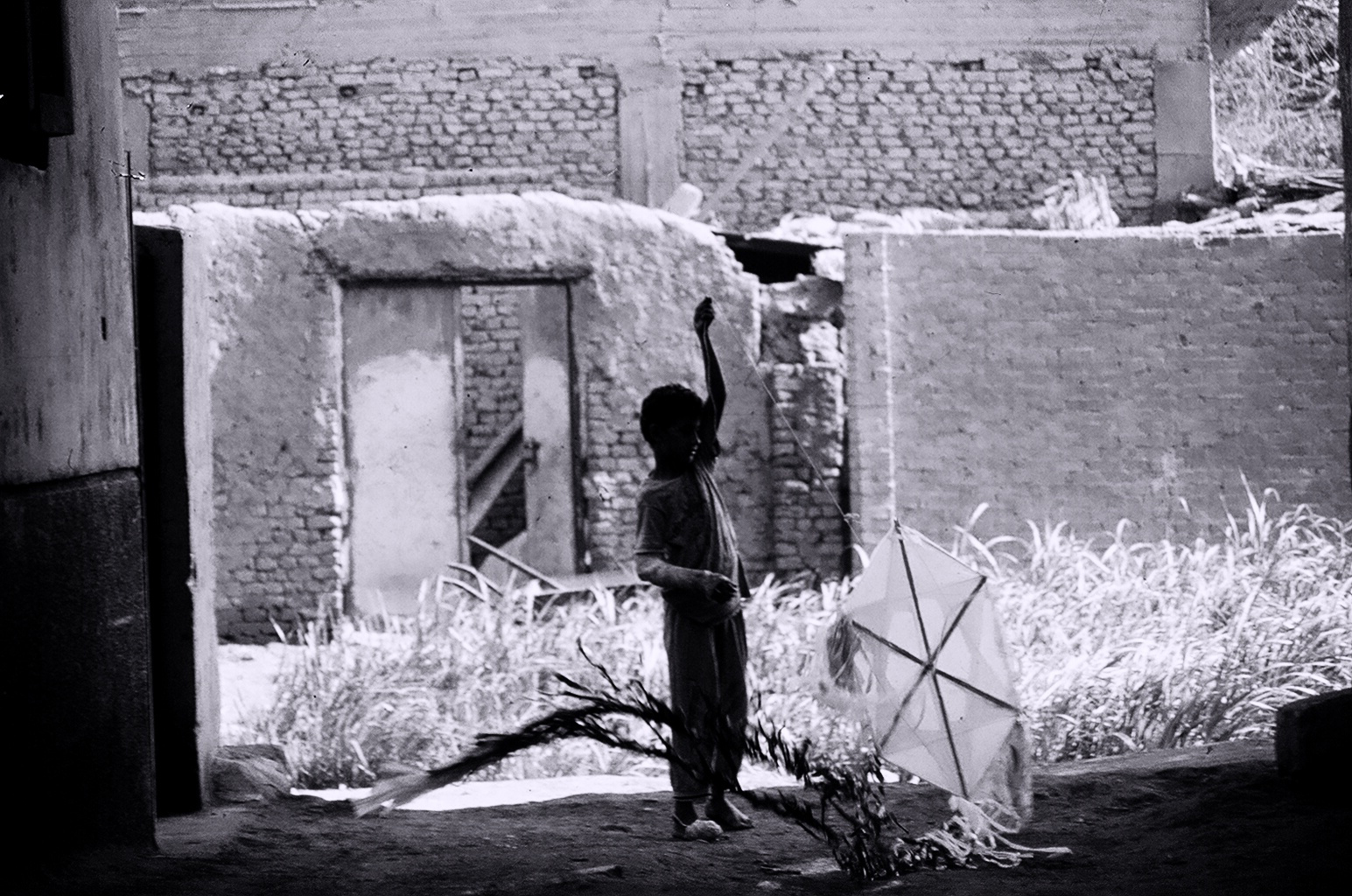

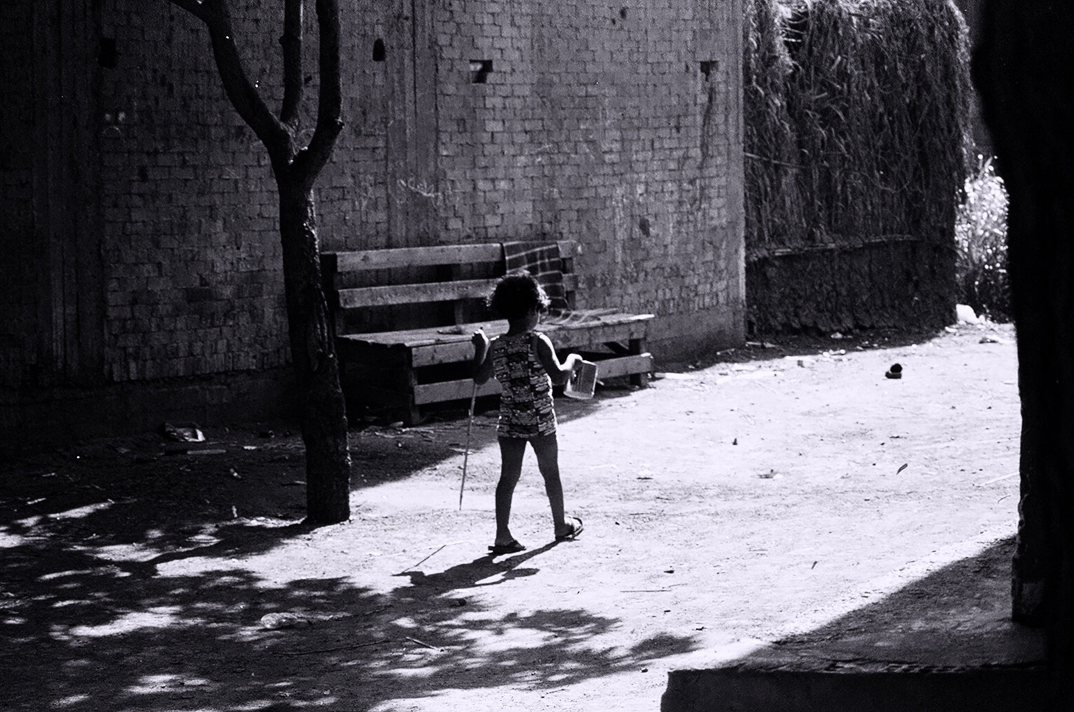

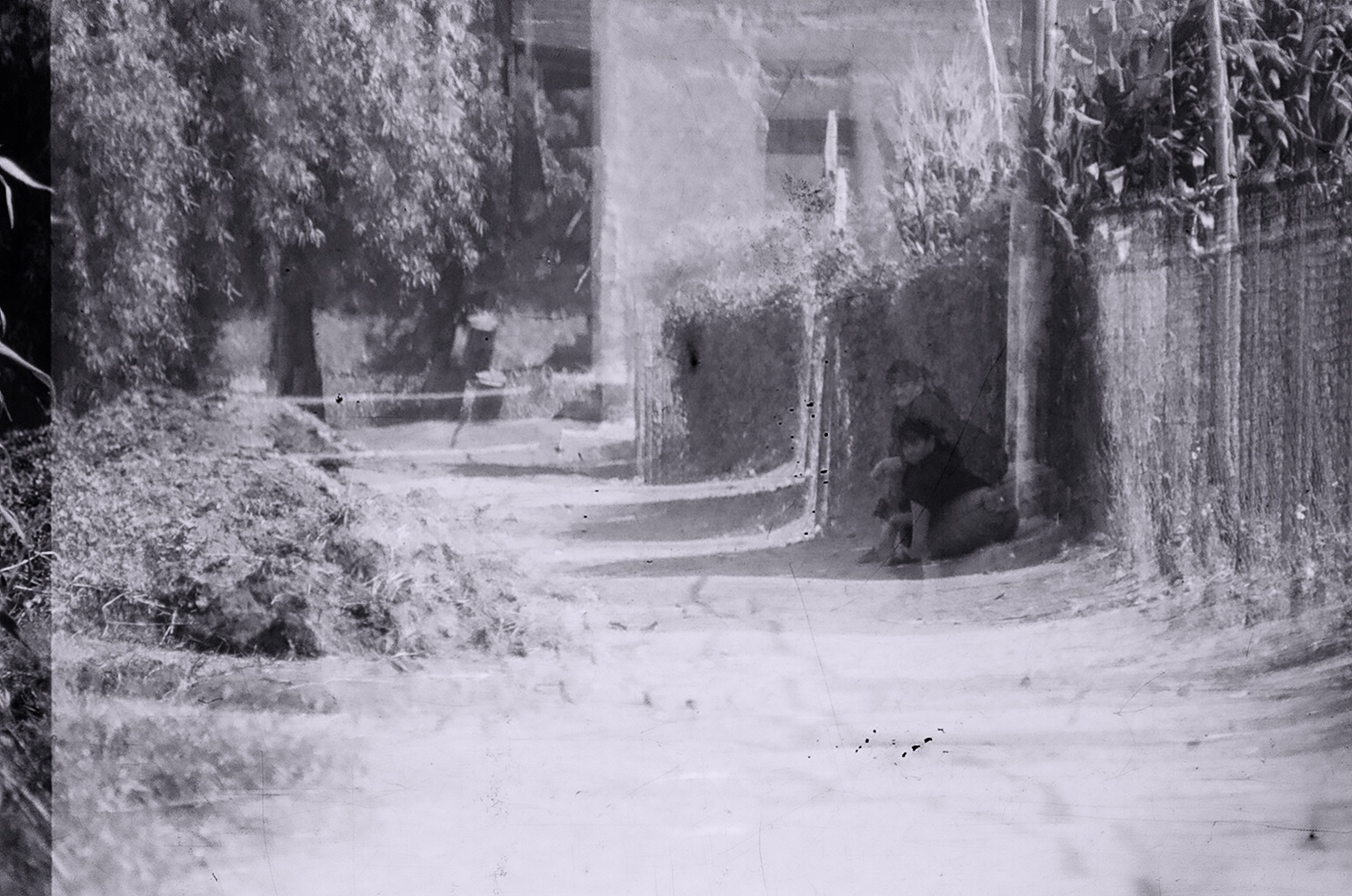

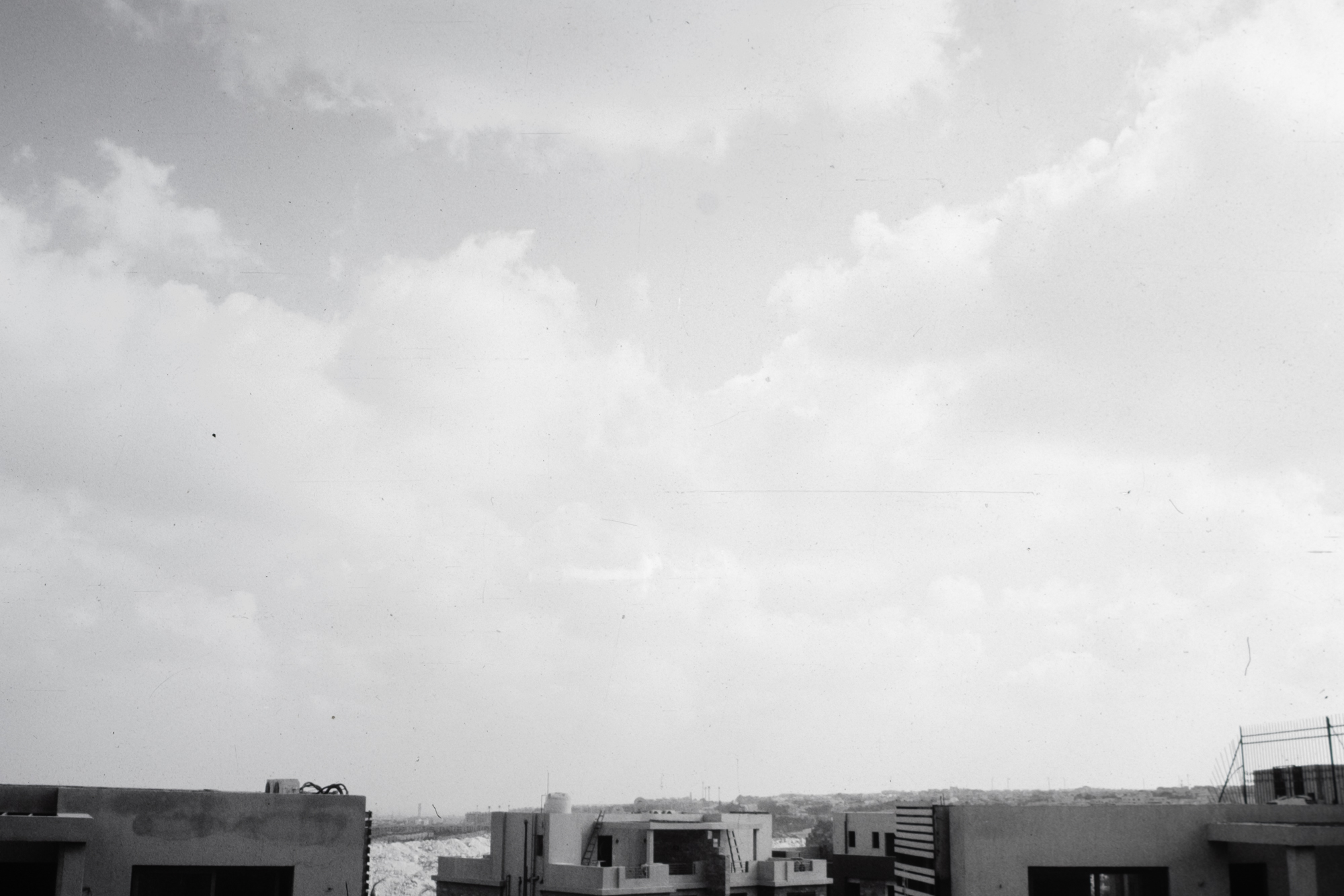

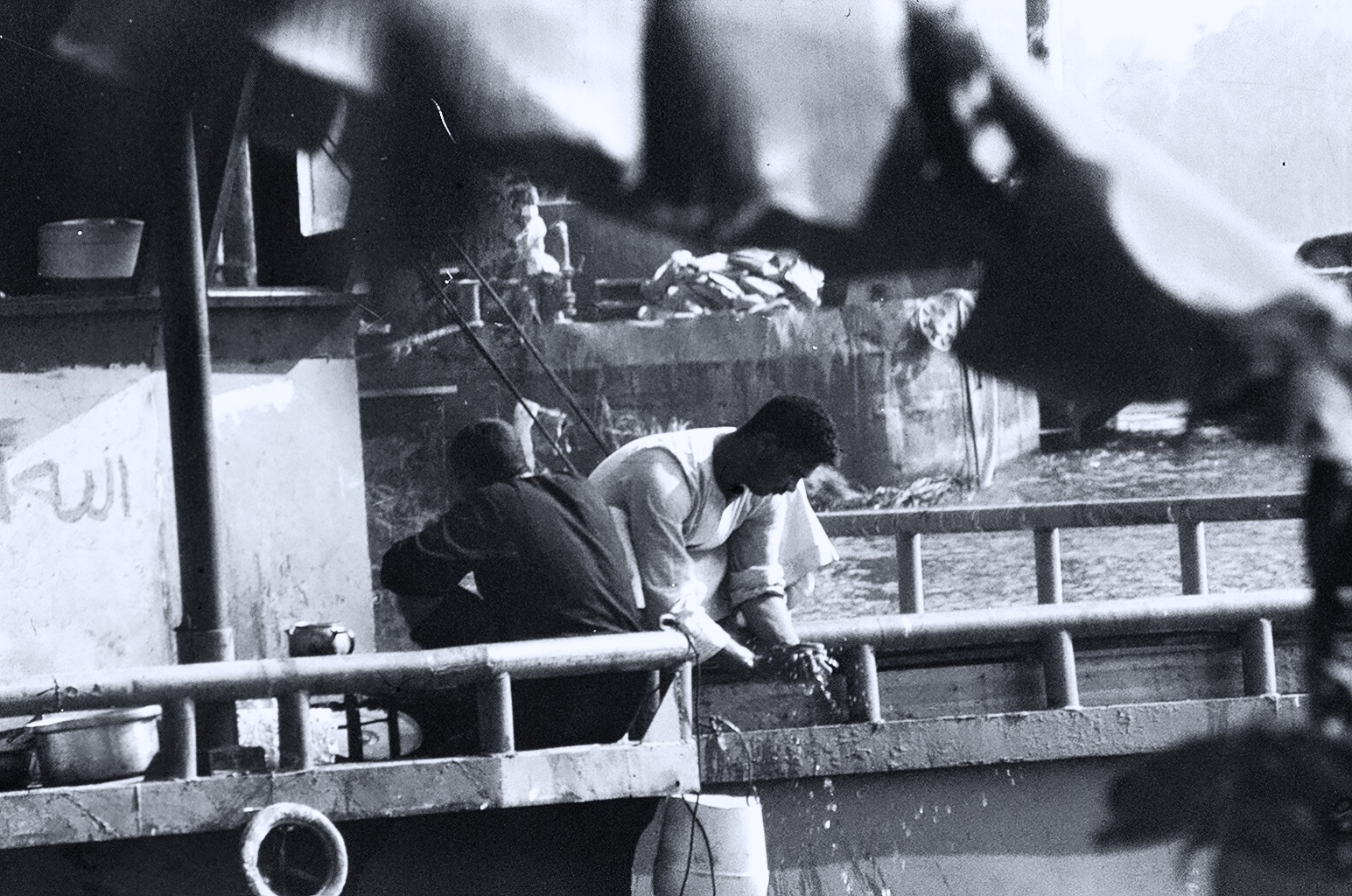

These are some of the results of this recipe.
The first and second pictures, Ukrainian Astrom ISO 200 ortho film with dichromate bleach.
Third image: Ilford Pan 100 film with permanganate.
You can notice the difference.
Note: The re-exposure step was done according to your advice (or maybe another colleague's advice that I don't remember) and is the prescription for the re-exposure solution (Fuji) ,,

These images were bleached with permanganate according to the patent that I talked about previously, and the recipe of (ORWO) company that depends on thiocyanates was used.
I came with evidence that the use of thiocyanate can be reliable and at the same time, permanganate can be used.
These are pictures made that way, I'm not kidding, nor do I invent words out of my head without evidence,

Those pictures have "closed"* shadows and blown up highlights, regardless of how they were obtained.
* without details

You don't know that the shadows have no details. I didn't see the image with your eyes.
In addition, this film has expired since 2009 and is basically a film that was manufactured by Ilford in order to record car violations that exceed the legal speed by highways and that shipment of films was the property of the government of Sudan, and Egyptian photographers have obtained it illegally, During their revolution that toppled their president, and the acts of plunder and plunder, etc., (this does not matter) ,,
Also, the girl who took these pictures did not use Light Meter and was using only her feelings, and she is my intern.
- Also those pictures were scanned by a foolish man who works as a technician on a Noritsu scanner and does not know how to deal with the positive film ,, so he made a scan for this roller and the result was negative and we used Photoshop to reverse the image until it is positive
