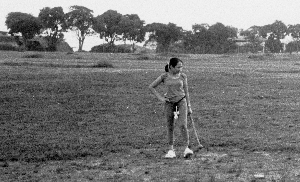

Hi there,
Yes this is the first time I use Fomapan 400. Previously using TMY. (Oh so that may be the reason..)
One example image: (sorry about the dusts and scratches, I only started learning DIY developing recently.)
A 100% crop:
Are the coarse grains normal?
Well it is not a film I have ever used but based on seeing other people scans of reversed negatives or prints the grain looks as it should to me and yes TMY film is a much better
By the way is this a reversed scan of the negative or darkroom prints. If is scans of the negatives then the best way of to judge the negatives is to take a digital picture of the negatives so they appear as negatives
I can't see any blown highlights, where are these?
pentaxuser
Fomapan 400 in 135? It looks fine to me.

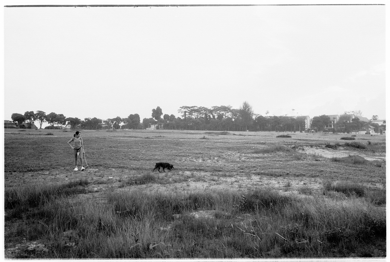

Hello miha,
Yesterday I shot half a roll of Fomapan 400 at ASA640~800 and "stand" developed it in DD-X for 45 mins. Can you take a look at the attached sample picture and compare it with what you got. Let me have your comment on grains, contrast, dynamic range etc. TIA.
Data: Leica M6+ 35mm Summaron. Probably f11, 1/125 s. Scanner: Coolscan 9000ED.
yossi
I use Foma 400 as my every day walk around film, I develop in a number of developers, D76, Clayton F76+, MCM 100, had not tired DDX, still your negatives looks pretty good, the highlights on the building in the background looks like they are somewhat blown out, not that unusual considering the lighting. I shoot Foma 400 at 320, based on testing for shadows in Zone III and highlights in Zone VII. I get best grain with MCM 100, better shadows with D76 or Clayton. If you like grain, I did try a roll in Dk50 1:3, too much grain in 35mm for my taste, really nice in 6X9 or 4X5. If you can live the grain I think your on the right path.
Hi yossi, difficult to compare an optical print to a scanned negative but as Paul wrote above you sample looks pretty good. my I ask (a) why did you choose to underexpose the film by one stop (even more actually, as Fomapan is more of a 200 film) when the light was sufficient based on your stated exposure parameters, and (b) why did you use stand technique with DD-X? You did two things that go against of what I think should be considered as an optimal technique: enough exposure and intermediate agitation. I guess you were just lucky and saved by the huge tolerance of today's material.

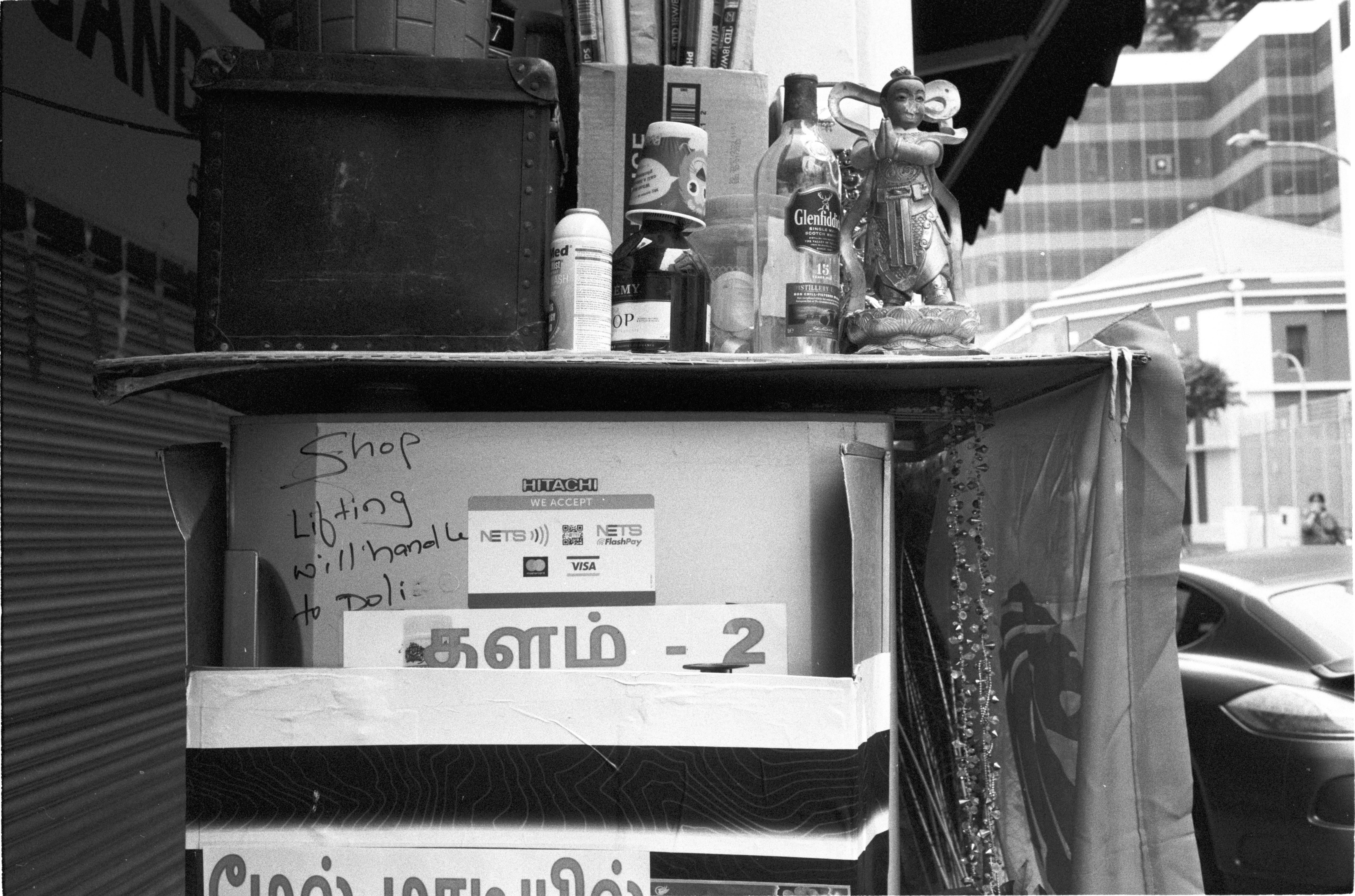

Hi miha,
To answer your questions:
For the test sample picture, the lighting was certainly strong enough to even shoot with an ASA100 film. I took that shot basically just to see how this stand development would render the brighter and darker part of the image. I like to take street shots so can encounter very different lighting situations, and most of the time I stop down to f8 or f11 and scale focus, and so even with ASA400 film, I often get too slow a shutter speed that I end up getting a blurry picture. I used to shoot Tri-X which is great, but its current price has become so high recently (about US$14/roll, and often unavailable locally) and so I look for a cheaper alternative high-speed film to use. The cheapest I could find is Fomapan 400, about US$5.5/roll. I shot it at box speed and DIY developed it normally, but was not all that satisfied (too grainy for me). Btw I also just started learning B&W film processing using DD-X which is the only developer the shop here has. Then I chance upon an YouTube video (don't laugh pls) that shows a stand development of Foma100 in DD-X with great results at +2 stops. So I just try my luck with Foma400, using the same dev recipe more or less.
The experiment was not fully successful but from the results, I think if I shoot the Foma400 at 640 and tweak my recipe a bit, I may get quite useable negative. Way better than the normal development in DD-X could give me. (A few shots did show glowy highlight though. A known issue with Foma400. Below is one example. )
This shot looks fine, yossi, but I am puzzled that it should be better than DDX developed at its usual 1+4
pentaxuser
I would shoot a test roll, in open shade use a model, light skin zone VI, darker skin zone V to IV, a swath of light cloth with texture for zone VII, dark cloth with texture zone III, a gray card zone V, shoot from ISO 50 to 1600. You will find the ISO with the best dynamic range. I take one shot, then cover the lens and shoot an empty frame, makes it easier to judge later. Develop using you standard dilution and time. Any by the way, it is really hard to avoid blown highlight when shooting lighting fixtures, I think your example is just fine, the lights look natural and your shadow are open with detail. I don't see an issue. If you really want to tame the highlights of the lighting fixtures you need to use a pryro developer or a divided developer. My guess is that will need to make from raw chemistry.
