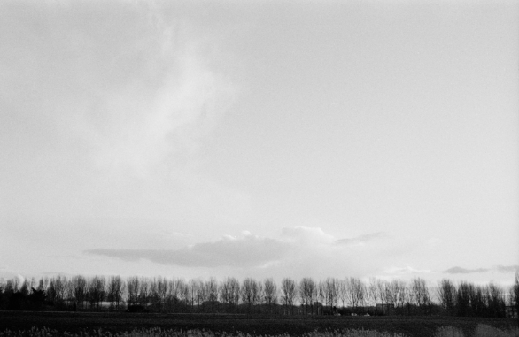

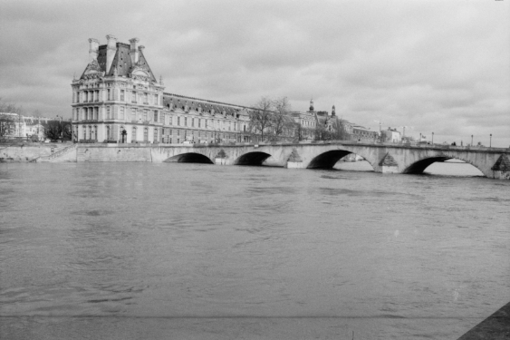

Fomapan 400, 35mm, Pyrocat HD, shot & processed in Feb 2018.
Totally fiiiiiine - of course, because there's absolutely nothing about these films that somehow makes them do weird things if you use something else than D76.

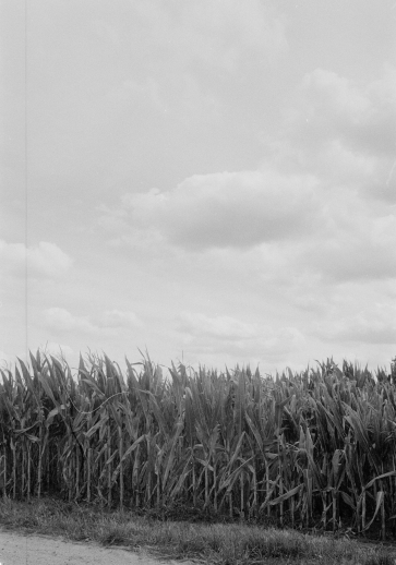

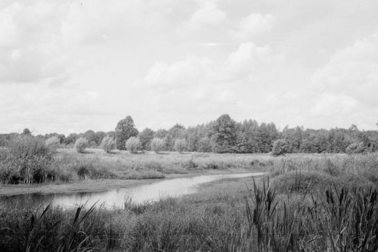

And here's the reason why back around that time (2018) I stopped shooting this film in 35mm format:
A few months later; same film but a different section from the same bulk roll, different camera, different developer:
After that I personally have continued to shoot different Fomapan films in various formats; I've just avoided 35mm Foma 400 as well as 120 Foma 200.

And I assume you confirmed those lines were actually on the film? And on the film prior to exposure?
Yes.
They're only minus density without any other evident anomalies. They're not visible as a physical defect other than that they're reduced density. Just like the defects discussed earlier in this thread in that sense - density anomaly, no physical anomalies to the emulsion.

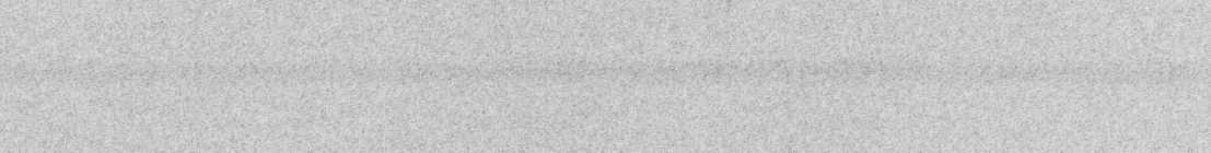

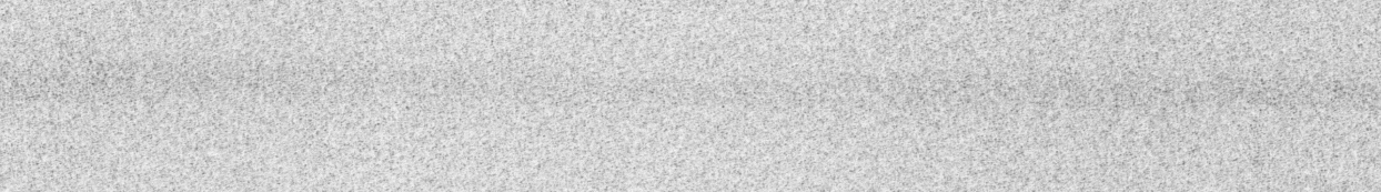

For the curious among you, here's the stripe artefact I encountered in 2018 in close-up (6300dpi Flextight scan):
Yes, it's very slightly wavy, and irregularly so, with a delta of something like 85um.
Here, on a different frame in a higher-density area:

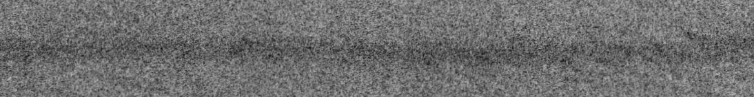

Of course, like any rational empiricist, I initially concluded that there was a process problem on my end when I first saw that stripe. Until it occurred in other rolls in the exact same place, despite there being months between shooting the different lengths of film and all other parameters being different (camera, developer, tank, agitation etc.)
Here's the artefact @6300 dpi on a later roll, again in a dense area:
Note that the difference in developer (510 pyro in the one above; pyrocat HD in the earlier 2 snippets) and development time makes a real difference in how the grain renders etc. - but the defect is really the same.
