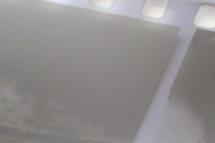

I'm not going to claim to be the most fastidious of darkroom practitioners. I'll often mix powders up just before use and end up with maybe a bit of some undissolved chemical in the developer. I generally filter the developer through stainless-steel mesh but that doesn't mean much. So I would reverse the film loading to compensate.
The streaking pattern here is not sharply defined and the emulsion-side of the film looks pristine when viewed under high magnification and oblique light - apart from the lower image density which of course shows up, subtly, due to the tanning action of the developer used in this case.
Interlayer drying marks are highly likely then. You don't see them on the surface necessarily under oblique light - they affect layers below the supercoat and are caused by too hot a dryer for your RH % causing the top layer to dry faster. Some films are much more susceptible to them than others. There is information about the how & why, deep in the old documentation for Photo Flo and a few other places in Kodak et al's old technical data for labs/ graphic arts. They are exceedingly annoying, but if you catch them fast enough you can usually get rid of them by a quick re-soak in wetting aid - if not, they're there forever. If you used a staining developer, some of them have known problems with Foma films (runaway dye formation in one case). The only really significant fault other than the inherent sharpness/ granularity/ image content transmission/ latitude limitations of the material that I've encountered with Fomapan 400 was the Anti-Halation backing leaving messy speckles after processing that they disclosed a few years ago.
If it was a coating defect other than sub-mm bubbles, it would be much longer than 'a few 35mm frames' (more like metres) because of the speed of the machine relative to the bead/ curtain reforming and not be a very thin straight line (Foma aren't using an ancient doctor blade dip-coater as far as I know).
... The streaking pattern here is not sharply defined and the emulsion-side of the film looks pristine when viewed under high magnification and oblique light - ...
I assumed that the streaks can be seen on the emulsion side of the film - but as it cannot this makes me have another idea:
If the emulsion has same thickness, it can mean that development was uneven as there are lower density areas.
What if the quality of the gelatin was not even, resulting in some of the gelatin needing more time to soak and swell during development. This then could explain why the emulsion side looks pristine, but the existence of lower density areas.
As the base moves quick through the coater, a drop of "slower-swell" gelatin is turned into a streak for the most and does result in reduced developing time.

Photographic emulsion is around 10um thick. A coating defect consisting of a partially missing bit of image layer (out of several coating layers) will be all but invisible when looking at the actual emulsion side of the film, as is the case here. It's not like you get to see a hole in the layer with the base shining through or something.

The size of the defect implies that whatever the cause is, it's closely associated with the coating process. A hose sucking in a tiny bit of air (venturi effect) could be an explanation, as would a partially blocked feed line to the coater causing gaps in the laminar flow from one of the slits, fouling of the coating head itself, etc. I know from Foma 200 coating defects that fouling does occur as I've encountered actual debris/particulate matter in rolls of Foma 200 120 format, so the notion that they sometimes have cleanliness problems isn't far-fetched.

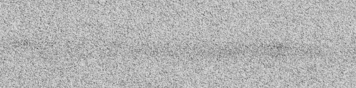

Btw, here's a closer-up view of the problem, scanned at 6300dpi with a Flextight scanner, then viewed at 50% magnification:
Note the geometry of the minus-density patches, which lacks the sharp edges you'd expect of water spot damage, scratches etc. It's a very gradual. Here's a 100% crop of a representative smear:
It's literally just lower density; that's all.
Note that apart from longitudinal smears, there are also insular spots:
(25% magnificiation)
Here's what the emulsion side looks like with light shining at an angle across it:
Closer up:
Note absence of any signs of emulsion damage, scratches etc. Just pristine, clean emulsion surface. At certain angles, you can see the density variations, although they're of course quite subtle:
The insular spots imply that this cannot be a transport problem, as that would only leave longitudinal marks. Further hints are the lack of superficial damage to the emulsion and the lack of sharp definition to the features.
Moisture damage also seems unlikely due to the lack of edges to where the water droplets would have supposed to have been, and the lack of conditions that would be conducive to this damage in the first place.
Processing/development errors are ruled out by the longitudinal nature of most of the defects, which suggest a factor in which longitudinal motion plays a role, while the film was processed with manual inversion agitation. Errors during film spooling etc. are excluded by the lack of superficial damage.
Drying damage along the lines of excessive heat etc. is excluded by the lack of any change in film geometry (too hot drying conditions tend to leave visible bumps on the film) and the lack of a corresponding superficial feature on the emulsion side that coincides with the density anomalies.
Pressure mark damage due to cassette assembly problems are ruled out by the lack of pressure marks (which result in plus-density anomalies, not minus-density) and the absence of any signs of scratching of the emulsion or backside of the film.
The likely explanation of the marks is a relatively lower silver halide density in the affected areas. Since nothing has physically removed anything from the emulsion prior to film processing, and processing itself being excluded due to reasons mentioned above, the only logical explanation is that the silver was never deposited in the first place. I.e., a manufacturing defect.
Coating faults would generally be pretty sharp edged - like pinholes and streaks or a comet and a tail - and it does not look like poor melt mixing (or just a plain poor melt - I have some Efke from the end of Fotokemika's manufacturing era that very clearly shows their plant was on its last legs) or surfactant issues (the bands would be considerably wider and clearly defined - and I think you'd generally see major coating issues in physical relief - the supercoat would 'fall' into the holes, especially if it is coated purely as a single emulsion layer (maybe - going over ISO 200 with conventional 3D crystal emulsions seems to cause a major rise in emulsion turbidity etc - as opposed to controlled crystal growth epitaxial ones like Ilford Delta) + supercoat).
Foma films are less heavily hardened than others, the 400 has a thicker emulsion - this adds together to make it much more susceptible to stress marking anywhere from post-coating roll-up, to slitting, to any of the many stages involved in confectioning, especially if the hardener takes a few weeks to hit maximum durability - and if the roll was slit early, that could be a cause. Another aspect of this may be developer related - in some circumstances (cf. the 220 Shanghai thread) some developers seem to strongly intensify any manufacturing stress marks - where mainstream ones (used for manufacturing QC) don't - that was why I mentioned Pyrocat - it has been known to cause strange and atypical faults with Foma emulsions.

elastic deformation
It would either have had to deform the base along with the emulsion, which would show up as a very nasty set of bumps along the whole length of the roll, or the emulsion would have had to locally spall off the base to accommodate for the dimensional changes. Neither is evidently the case. I'm sorry, I don't see much merit to the hypothesis of a deformation that was there at the start of development and then magically disappeared. It doesn't make sense from a physical or a chemical perspective. And once more - pressure marks tend to result in plus density. You try it yourself; take an unexposed bit of film (in the dark) and scratch your nail across the surface. Works with paper, too. Then develop it. You'll get density. Only if you scratch hard enough to physically remove the emulsion, you can get minus density this way - but that also leaves physical density.
Fact is that I don't know what aspect of the manufacturing process caused this, only that it must have happened before the film was ever loaded into the camera, and that no other factor related to logistics, storage, xrays etc. etc. fits the damage pattern.
If other users pre-soak their Fomas, they may not run into problems like these.
Problems like these are often intermittent; you get a bad patch on a master roll and that bad patch distributes across a number of confectioned rolls. They then get spread out over the world if the QA department doesn't catch them. I happened to get this particular roll of film in my hands; I bet many of the other affected rolls from the same batch ended up in potentially infinite storage, were happily embraced by a crowd thrilled with these 'vintage artefacts', led to some photographers cursing the lab they used believing it was their fault, and yet some more may have been processed by novice darkroom workers assuming they must have done something wrong and decide to keep an extra close eye on developer temperature next time (or do a magic rain dance or whatever), etc. Most the problem it is likely unnoticed, ignored or misinterpreted - and even if it's noticed and properly identified, not much of it will be documented in a publicly accessible place. That's all I wanted to do really; put it out there. Given that they're not my negatives and the film was purchased some 2 years ago, I don't see much sense in bugging Foma about it now; what good does it do them to know they had a QA issue 2-2.5 years ago? I bet they have them every week and they probably catch the vast majority of them.
I really can't see a 3um thickness difference - it's on this order of magnitude we're talking. You'd be able to see if it it was sharply featured, but as you can see, this isn't. In practice, you really can't see the kind of small valley that we're talking about here. If I use my imagination and hold the emulsion to the light in just the right angle, I think I miiiiiighht just see a variation in the surface, dipping slightly where the stripes are, but really, it might just as well be the effect of the optical density just as well. I've tried to capture it on the shots I've shown above and as you can see, it's basically invisible.
Of course you cannot see 3um with the naked eye - i but it may be possible to observe the diffraction (? not sure about the term right now) a 3um groove can create to light-color, like the groove of a vinyl record.
I am aware of pressure-exposure and i don`t consider this to be the case here - as it would increase density on the negative. No, i am thinking of a compression of the emulsion which was present till development.
Not a bad compression, no peel off of the emulsion, just a slight compression. Not every emulsion is prone to pressure-exposure to the same extend. A slight compression not producing pressure-exposure should be possible.
I was thinking of this memory-effect. There are spoons you can bend like mad, but if you put them into a cup of hot coffee, they will spring back to ordinary spoon-form. What's the name of this effect again... memory-deformation... elastic-memory-deformation... i cannot recall right now.
With gelatin i can imagine the same to be possible:
You compress it slightly by a few um - without producing pressure-exposure - the gelatin will remain compressed at this spot, but will soak with developer and swell (respectively dry) back to an even surface.
But because the compressed part took longer to soak developer, lower density formed.
I also don`t see sense in contacting Foma, unless you have to know what (manufacturing-)problem caused this effect.
I'm sorry, I don't see the effects you describe on these negatives, and with what I know about gelatin at a theoretical and experimental level, I don't see how the compression theory would work.
