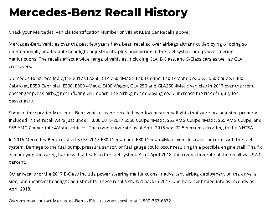

On the subject of comparisons - nothing is immune from quality issues:
Shared not to particularly disparage Mercedes, but rather to point out that it is more a question of frequency of encountered problems, rather than the existence or non-existence of problems.
At least no one will die from some emulsion defects in a roll of 35mm film.
