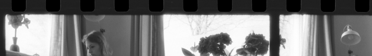

So, how to tell if a film suffers from halation? It's quite easy - just look at the edges of the film frame. Here's a few examples from random rolls of F400; literally the first two rolls I came across going through an old folder.
Note the blooming around the frame edges. Lens used was a fairly modern Canon EF lens, not particularly prone to blooming or haze, and more importantly, the fact that it crosses the frame borders rules out the lens as the culprit. Of course, halation does not only occur at the edges of the frame - it's just easily visible there.
Another one. Overcast day. Note the blooming in the center.

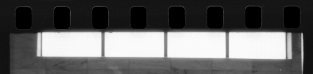

One more. Note how the windows basically 'extend' behind the camera's film gate. The same is visible in the frames between the windows, which suffer degraded contrast as a result

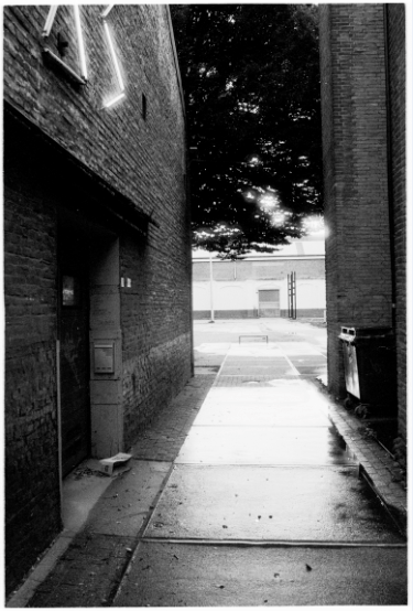

Btw, I just dug up some Foma 400 scans lingering around on a network share.
Note halos again around highlights; the neon sign top left, the specular highlights in the foliage of the tree.
Yes, this one does look rather like my photo with foliage.

One more. Note how the windows basically 'extend' behind the camera's film gate. The same is visible in the frames between the windows, which suffer degraded contrast as a result.

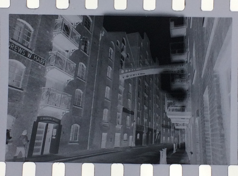

Here's the alley shot. Can you tell from it if it's over-exposed?
Quite noticeable how halation bleeds into the borders. Even a hazy lens couldn't have produced that?

And thank you Lucius for showing that negative. The print was pretty conclusive but this negative eliminates any doubt in my mind. I think that is a classic example of halation.
