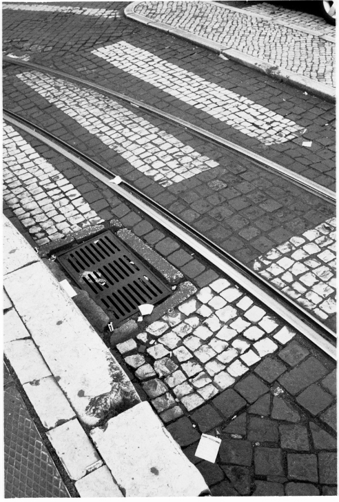

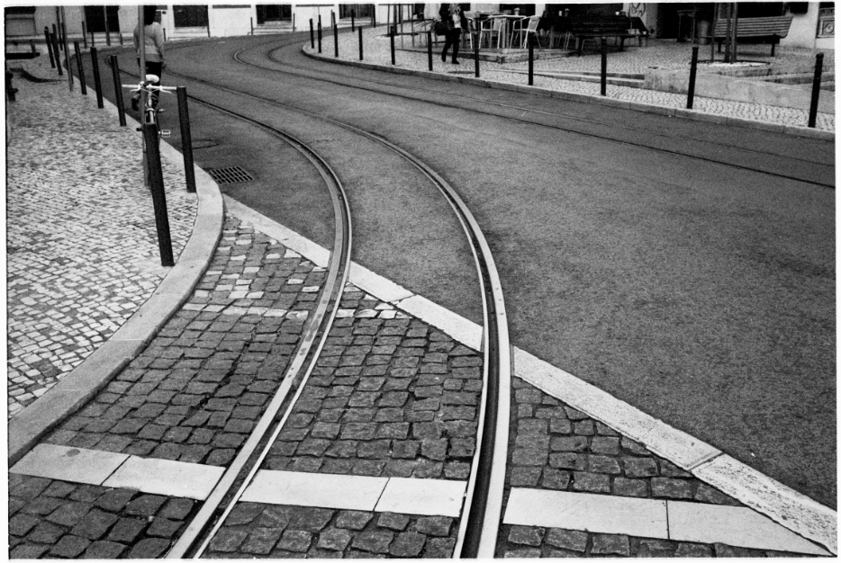

@albireo all of your examples above are 'easy' compositions in terms of halation with a limited SBR and no drastic transitions between very high values of illumination and deep shadows. I agree the film works fine in this respect if you go easy on it. But that does mean choosing not to shoot certain scenes, which I imagine some people (me included) would not want to consider just to suit the quirks of a lower-grade material.
Edit: to illustrate, these are absolutely fine, halation-wise, but it's purely due to scene selection/subject matter, not because the film is somehow better at it - these were taken from the same rolls as the examples posted earlier:
Fair enough, I don't do film photography to 'stress test' the consumables, that's true. Though I'd argue that one man's 'lower grade' is another man's 'creative opportunity'. I don't really enjoy dramatic whitewashed skies and point light sources in my photography so Foma 400 suits me just fine :smile:
Absolutely, I agree with that. For me, it's lower grade.
And not to nitpick, but my examples above were not 'stress tests'. They were just snapshots taken on a trip to Lisbon. The halation issues were entirely unintentional - and I'm afraid also undesirable in my view. Of course, as stated before, not much is lost on those images, so I never lost any sleep over it.
Sorry - I had missed these examples as I was typing as you were probably posting them. I think these are really not a good case in support of your argument. If I interpret the light correctly, these seem to have been taken in dull overcast conditions, with your exposure+dev choices aiming to increase contrast.
So completely different situation from the examples I posted, all in full sun, all of them featuring items at least minimally reflecting the sun.
Several degrees of possibilities as you can see (extreme point light sources, full sun with point light sources, full sun without point light sources, overcast). And Fomapan 400, a 4 Euro product, seems to perform more than acceptably in at least 3/4 of them. Fine by me.
with your exposure+dev choices aiding to increase the contrast
Same roll as the alleyway shot and some others, exposed ei400, all developed the same (same roll after all). Some contrast adjustment after scanning, probably. What those examples show is that there's no halation depending on the scene. Your scenes are likewise easy in this respect, so they don't show halation. It doesn't mean the film isn't sensitive to it, it just means that you unwittingly evaded the issue.
Exactly. Your scenes in the last post are under cloudy overcast conditions. Nobody would expect halation in those cases.
My scenes all features elements of direct sunlight. I would expect at least some halation. There is close to none.
Ergo the 'halation' issue is (as far as I'm concerned) bloated and limited to scenes with extreme contrast and direct point light sources.

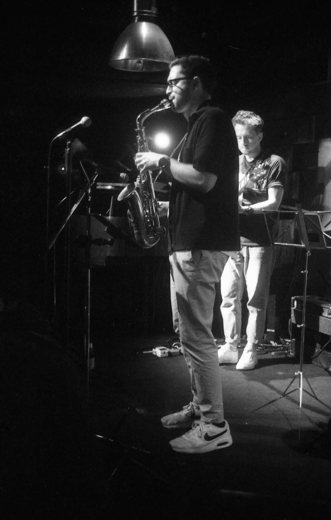

These might help illustrate the effectiveness, or otherwise, of the antihalation on Fomapan 400. 35mm (bulk loaded) pushed to 1600 as a bit of an experiment into something cheaper than HP5+
I actually think the Fomapan did better than I expected, though HP5+ still wins hands down. This certainly isn't what Foma intended the film for!

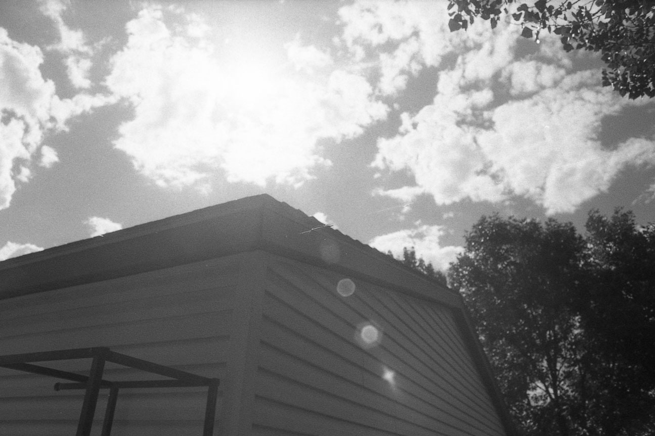

Two days ago Lucius posted a couple of photographs here that were shot with Fomapan 400 that showed a very obvious glow around a source of bright light that had bled into and concealed darker portions of his exposure. He found it unusual and wondered what it was. It was described by another member as an example of halation, a common problem that certain Fomapan 135 films appear to be subject to showing if there is a bright light source in the photograph.
At the time this was posted I found the explanation to be odd since I have been using a lot of Fomapan 400 film over the past few years and had not seen examples of halation in my own work that were that severe. So, being the curious sort, I decided to see if I could recreate that same obscuring glow in some of my own photographs. Using my Pentax LX and a Sigma Superwide II 24mm lens I purposely went looking for circumstances that I felt would cause this same sort of halation. The Sigma Superwide II lens is multi-coated but it is subject to flair from very bright light. I did use a hood but since several of these photos will show the sun directly in the frame I doubt the hood was very effective in protecting the lens to reduce flair. The flair can reduce contrast in the photo but, in my experience, it has never out and out obscured details.
The film I am using is relatively fresh Fomapan 400. I bulk load so this roll of film was loaded from a 100 foot roll of Fomapan 400 that has an expiration date of February 2025. I haven't found the can it came in yet so I don't have the Lot #, but if I find it I will post that later. The film was exposed at an exposure index of 800 so some shadow detail will probably be lacking a bit in some of the photos I will be posting. Since we are looking for the bleeding of very bright light sources into dark surrounding of a photo I didn't think that shadow detail was really an issue.
The film was developed in HC110 1:31 for 9 minutes at 68F. This was the recommendation from the Massive Development Chart on DigitalTruth.com. I agitate continuously for one minute and then 3 times every 30 seconds after. This is a bit more agitation than is really necessary but I kind of assumed that it would enhance the appearance of any halation. It was fixed with Ilford Rapid Fixer and hung to dry overnight.
I scanned the negatives this morning using an old Epson V500 flatbed scanner and Epson Scan software using the 16 bit grayscale mode in the Black and White Negative setting. I have not done any sharpening or other post processing beyond what the software my be doing under the hood for a standard scan. No cropping was done but In this case I doubt this will make any significant difference. The scan was processed in Photoshop and resized for the web. No specific sharpening or other post processing was done. I have done no spotting though I did clone a piece of string out of one of the images.

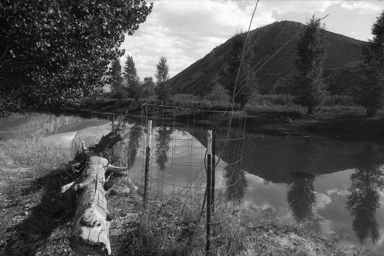

All of these are exposures into bright light sources with darker surroundings at different distances from the light source. You will have to be patient with me as it sometimes takes me a while to get images ready and posted. This first one was one where I definitely expected some halation but, as far as I can tell, it didn't happen. There is a very light glow around the cat's body but, since the ears are pretty well defined and not obscured this actually appears to me to be the reflection of light from the fur, not halation.
More to come.
Another example. There is certainly some veiling flare in evidence here and you can see the flair characteristics of my little Sigma lens. There is contrast reduction where the sun is showing over the roof but it almost seems to be part of the lens flair and not halation itself. The contrast is reduced but the detail is still there. I can't be sure, you tell me.

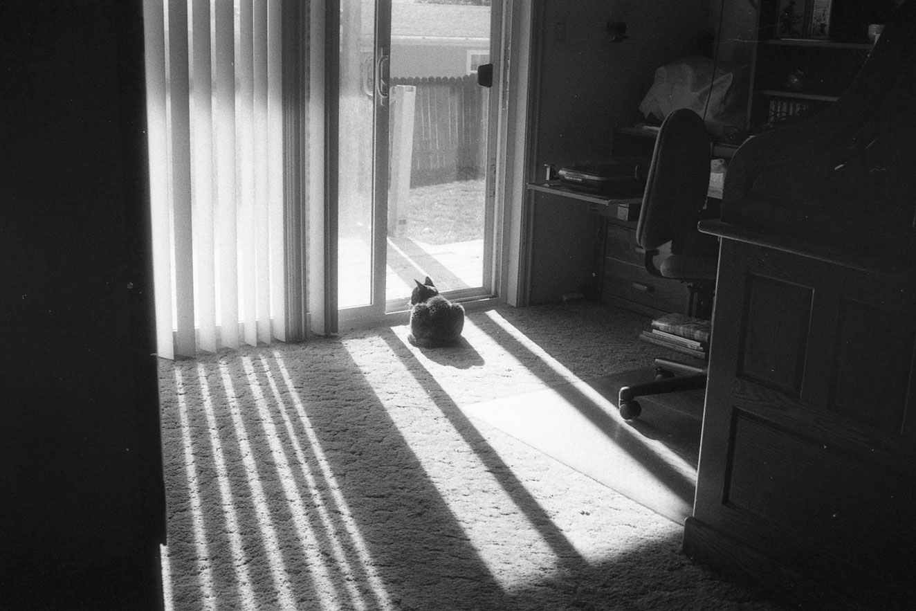

1: It does, but it's limited. It's especially apparent along the left edge of the blinds. It's also there in the window frame just to the left of the cat, and generally in the entire highlight area, but because it sort of looks natural there - it feels natural to have some 'sunny haze' in that area, even if it's actually caused by the film. This is essentially our psychological response to the scene 'fixing' the issue.
2: the intensity of the light in this image and the contrast transition between that highlight and the shadow areas is a far cry from the examples posted before. Just like in albireo's images, we're looking at reflected light. This is different from shots directly imaging bright skies.

You aptly point out methodological issues that make this one problematic to interpret. I think most of what we're looking at here is flare. However, halation likely contributes in areas like the leaves over the bright cloud along the top edge of the frame.
I don't see anything here that somehow disproves the film's propensity towards halation, nor do I see anything inconsistent with my experiences with this film. What I do see is significant difference in scene selection and brightness levels which in my view perfectly explain why halation is more apparent, more present and more problematic in some examples than in others.

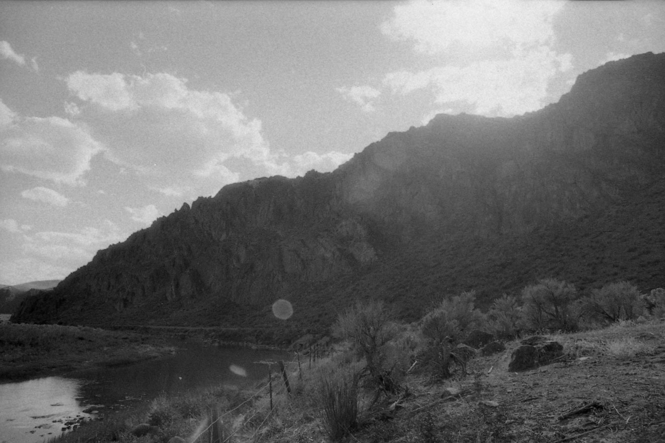

The sun is above the ridge but just out of the frame here. It is still very bright and we certainly veiling flair in evidence but I still can't tell for sure if this is halation. Maybe so and I certainly would not call this photo a keeper but it doesn't seem to be exhibiting that same level of glow we see in Lucius example at the beginning of this thread.
Fomapan 400 is sensitised up to 700nm, putting it in the same league as Delta 400. With its lack of AH layer, I'd be making exposures through a 720 (I've done that successfully with Delta 400) for Wood Effect. I think I have a box of 4x5 in the freezer... 🤔

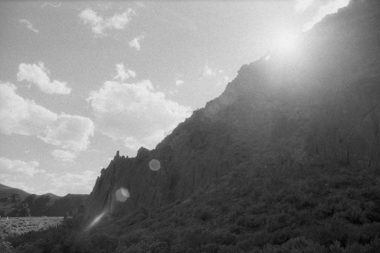

This last one has the sun coming out behind the cloud directly over the ridge and is probably the best example where halation could be present but I still have trouble isolating flair from halation. I may even have to clean my lens as well. It still doesn't seem to show as much glow as comes from Lucius example photo.
