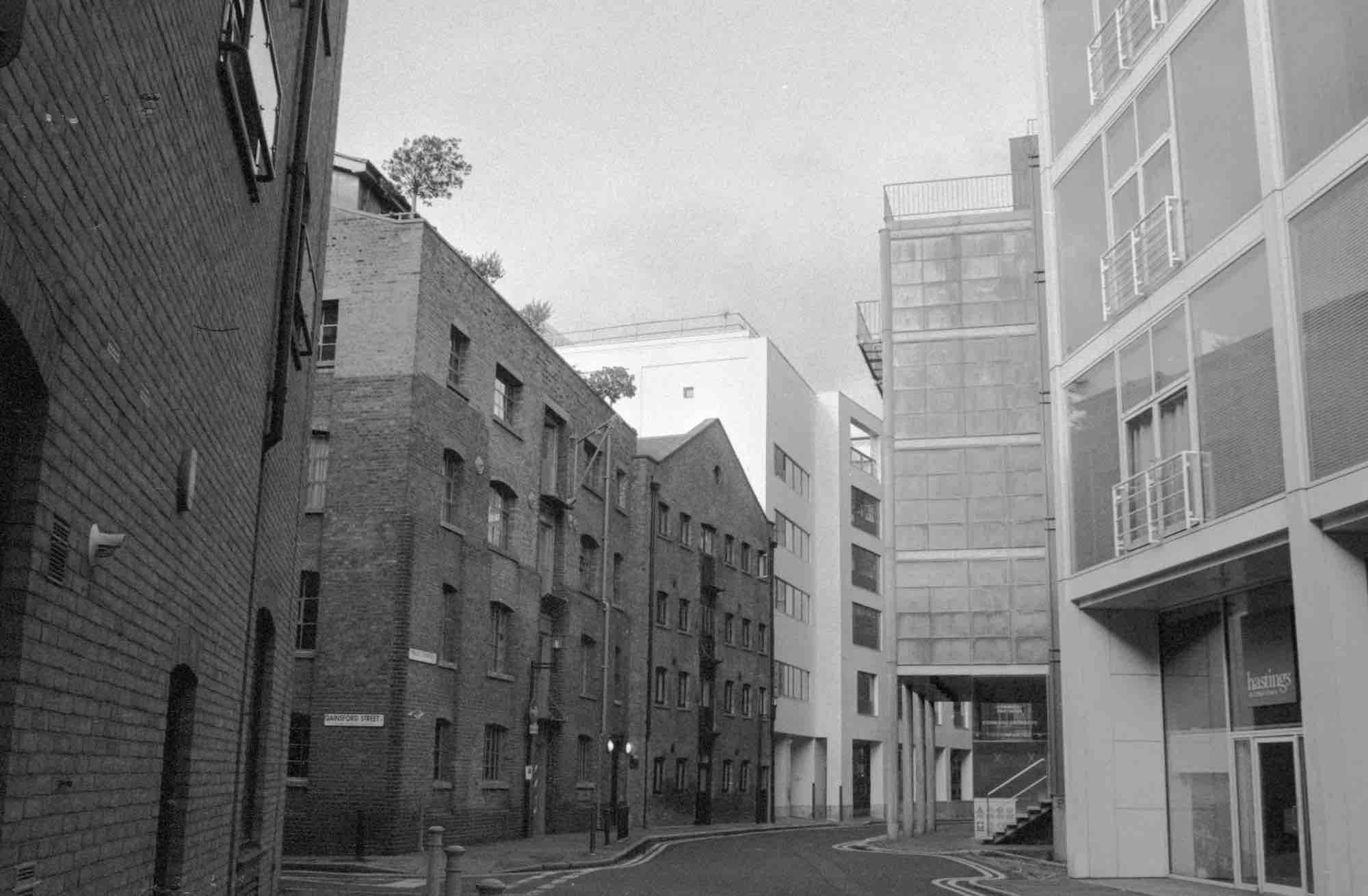

Facing away from the sun, it did seem to behave better.
@Pioneer: that seems to look more like your results?

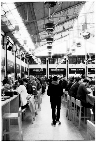

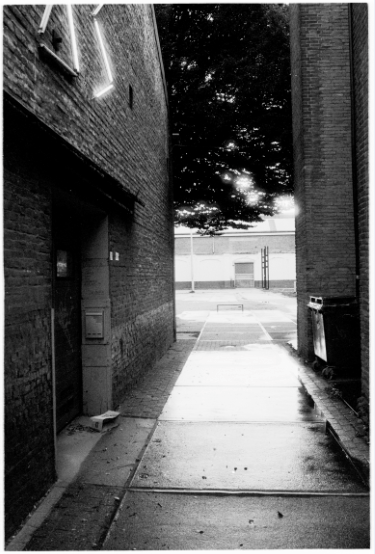

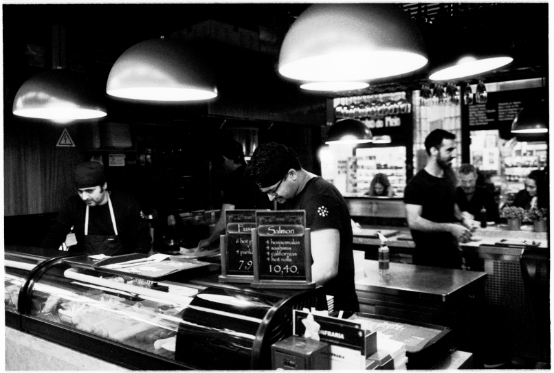

Btw, I just dug up some Foma 400 scans lingering around on a network share.
Background top right part of the cityscape totally obliterated by halation; note also severely degraded contrast around the gutter on the building left of the alleyway.
Pretty much the same, just mirrored. Note building in background at the end of the alley, notably the roof. Also higher levels of the buildings left and right of the alley.
Note entire top area of the frame with the roof structure blown out by halation.
Note halos around all lamps. They're even shaded lamps, so that should logically block much of the problem since the actual light source is kept out of the image, but even then, the film exhibits strong halation effects.
Note halos again around highlights; the neon sign top left, the specular highlights in the foliage of the tree.
Same principle; note strongly compromised contrast along tree branches in the upper half of the image.
Sorry about the overall abysmal quality of the photographs in pretty much every sense. They're picked from two rolls I somehow managed to label correctly, so they were easy to find.
The main differentiator in terms of the severity of the halation is the brightness of a highlight area or light source in combination with the scene contrast range, particularly adjacency between the two of these. But that's pretty much the definition of halation...

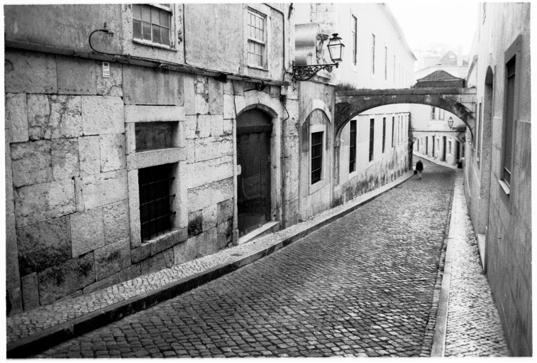

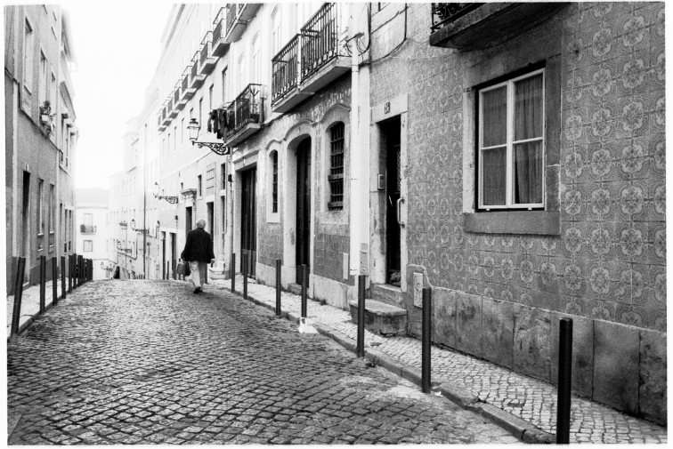

I have some from 2008. These are from a roll of Foma 400 I used in my Fed Mikron. For the first one, you can see I obeyed basic rules and kept the sun behind my shoulder. It's grainy, because it's half-frame and in Rodinal, but has no haloes.
On the same roll, I shot into the light and got haloes:
and later, streetlamps and headlamps also gave me haloes:
Very poor technical quality, but it recalls a dark, wet autumn evening in Leeds quite well for me.
This one is medium format Foma 400, so has no haloes:
I think what you're seeing is straightforward halation, and the solution if you don't like it is to buy different film. That's also cheap and easy to try.

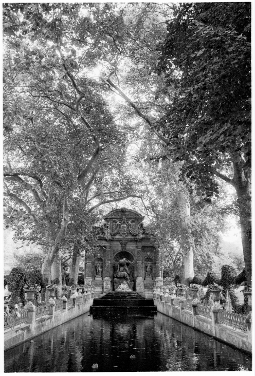

Here is some from 2022. Fomapan 400 in 35mm, mint 50mm lens and a variety of Foma developers. I think this is fine and that what people are seeing is perhaps a combination of a) some halation b) some overexposure c) tricky extreme light in the frame (eg point sources like a street pole at night or direct sun reflected by a mirrored surface) and especially d) mold or dust on the lens.
Aside from that I wouldn't exclude undocumented changes in the material.

One from 2023 so super recent batch.
Fomapan 400 in 35mm in D23 1+1. As above - inversion from linear raw scan with a 3200dpi dedicated film scanner - no edits, no grain reduction etc. Strong mid-afternoon sunlight on the flowers, bench, metallic bits of the barrel, blackboard rim...
