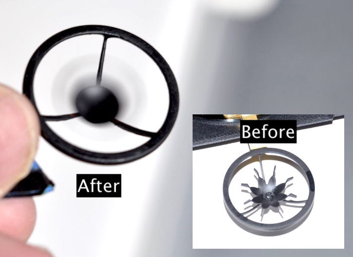

After 3 coats of different flat black paint, I stripped it, used a dremel grinder then metal brush to smooth out the dome and the transition to the screw.
I did not put Loctite on the screw this time.

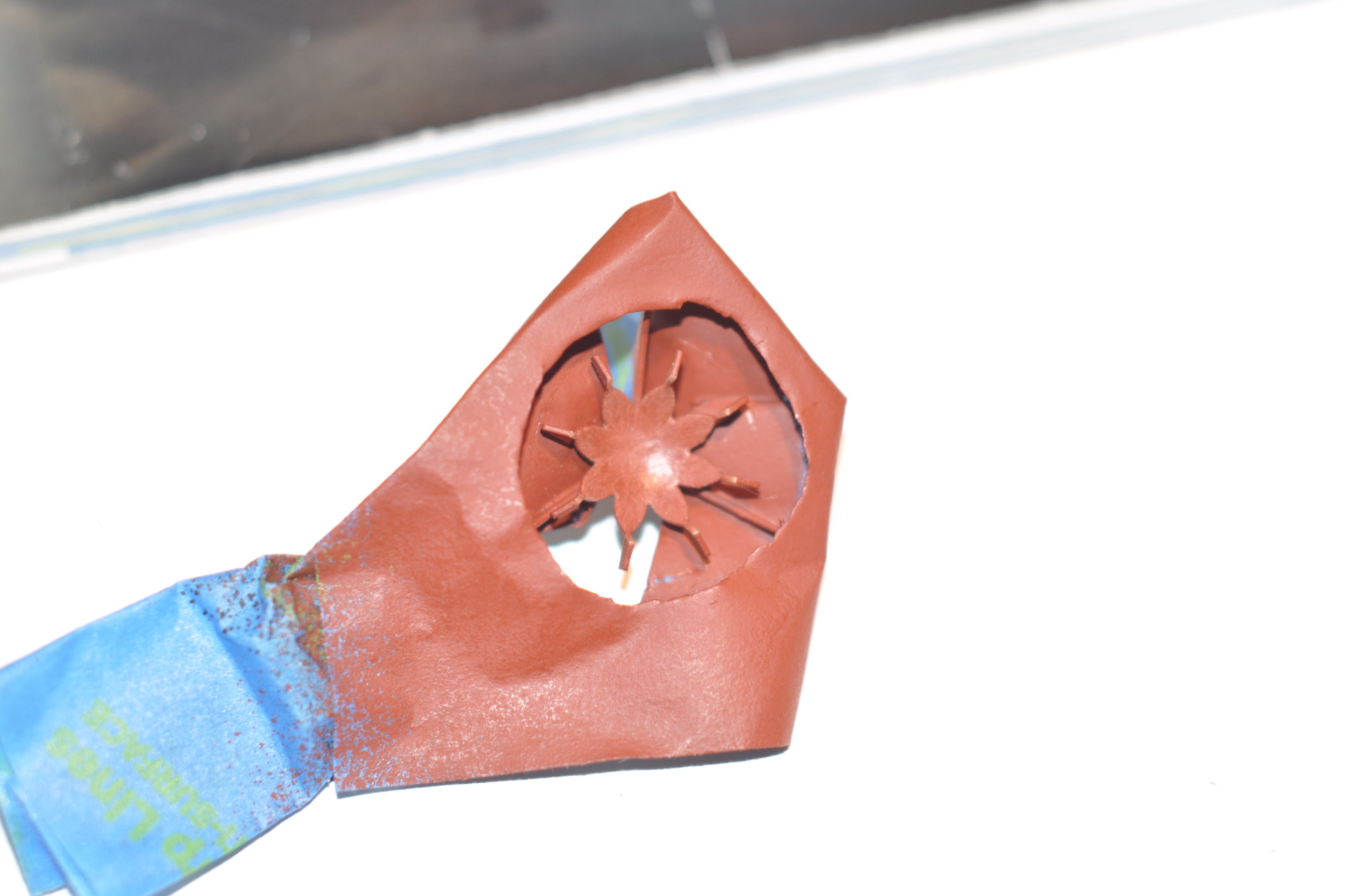

I applied multiple coats of brown primer.
I used sanding wheel and think strips of sandpaper to sand smooth the cup shape so the area of the screw end makes a smooth transition.
Finally I painted it with Testors Flat Black brush paint as that seemed a little blacker than the spray paints I had tried.
After final sanding, just before paint.
Spinning test after final painting.
To answer some questions. Yes I had considered blacking or flocking, but would like to use this lens sooner rather than later, so I'm using what I have available now. Also, no matter what I use to make it black, I wanted the base of the concavity to be smooth first.

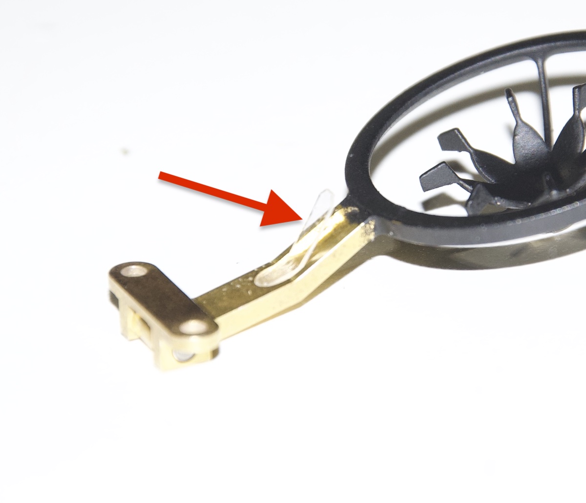

I added a spring to the fan so that it pops off when the string is pulled and put a rubber bumper on the front of the camera where the spinner hits when it files down.

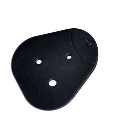

I painted the aperture plate flat black (was shiny metal finish):

Looking back on this whole situation, I'm pretty sure it was the Loctite around the screw that fouled the paint, making the inner surface irregular.

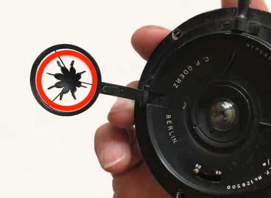

For comparison this is a picture from the internet of a REAL Hypergon's spinner. I was impressed how smooth it was and tried to make mine the same.

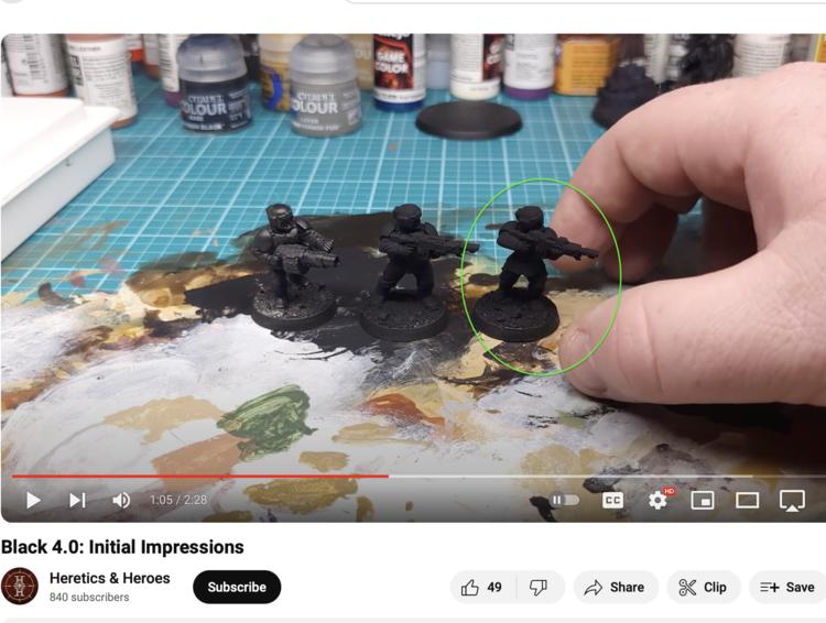

Now that I have the inside of the spinner nice and smooth, I might try the Black 4.0.
I did not rush right to that paint because, although it is darker than regular flat black paint (center figure) it is not a magical paint that makes black things disappear against a black background as youtoobers would want one to believe.
This image shows it best:
I'm surprised the apertures are straight sided. The best Waterhouse stops or wheel apertures are usually tapered slightly at the front. The original Hypergons would have been painted with a lead based matt black paint, these paints are still used for highly specialist purposes, but here in the UK you need a special license and the appropriate safety facilities.

The spring I added to the spinner assembly works great. The spinner pops off when released, even when the camera is pointed slightly upward. The originals had a spring there, but this was left off the reproductions, though the milled area for the spring is there.
One can see the original style spring in post #39 above. Looks to be held in place by a small rivet or screw.

The defect in the center is no longer present.
It was the irregular transition between the screw and the spinner that caused the surface to be prone to reflection. Perhaps from the threadlocker or oil on the bearing tracking down the screw.
In its current state there is no threadlocker on the screw and I'm running the bearing dry.
