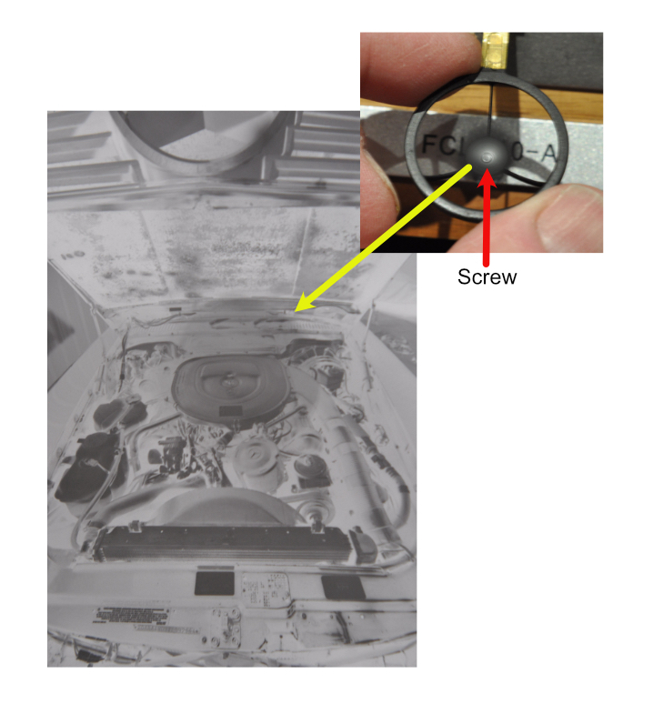

Some background.

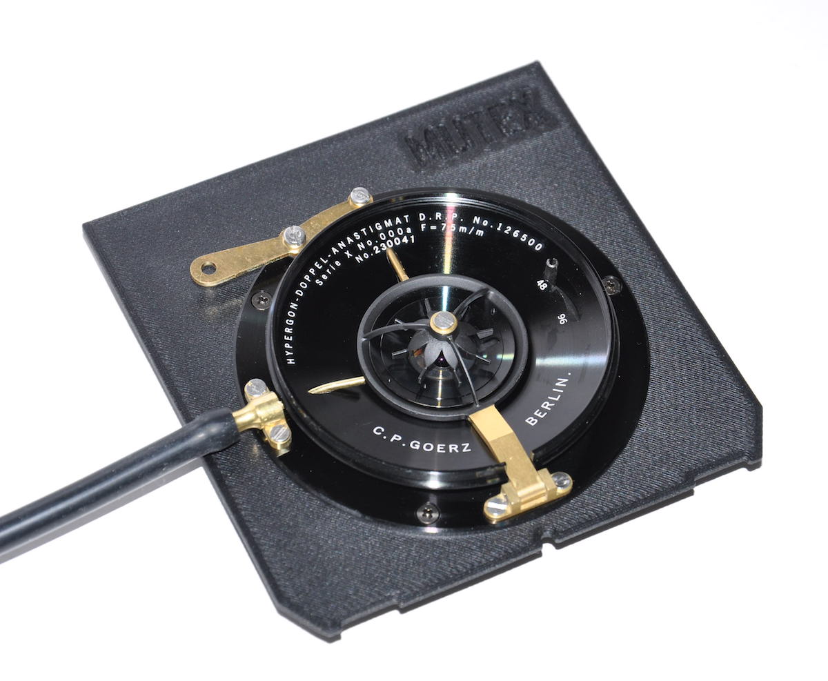

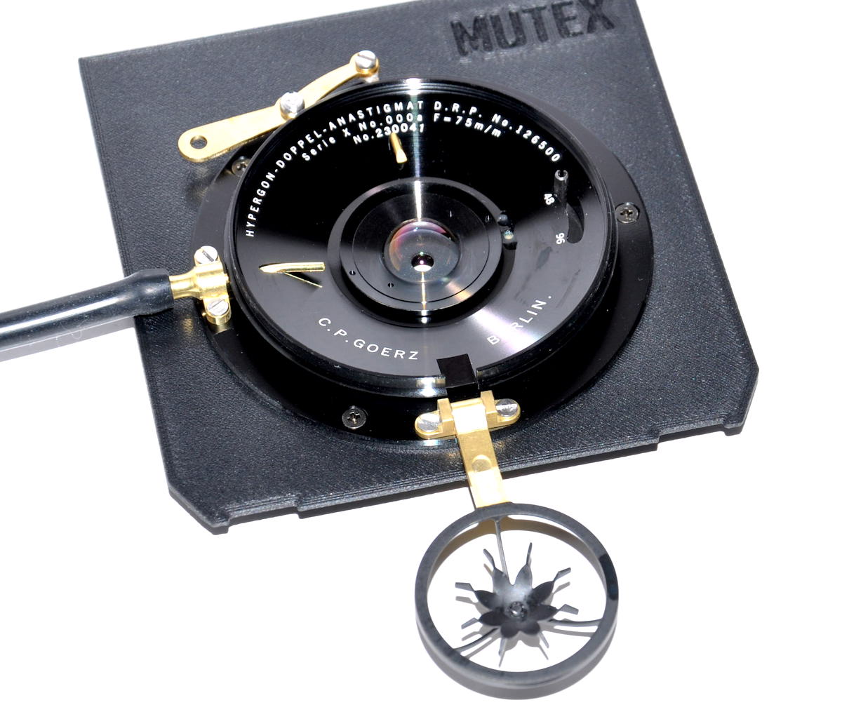

The Goerz Hypergon requires two exposures to counteract a severe light falloff at the perimeter of the image.
The first exposure is with the spinning fan, after which a string attached to the lever at the top, releases the fan to allow for the exposure of the center of the image.
My fan has a flaw, the shiny screw holding it in place is reflective and fogs the film in the center (need to fix this).

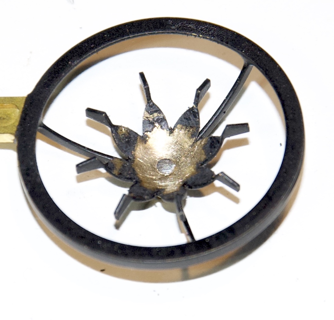

The end of the screw is fogging the image while the fan exposure is taking place. Looks like the paint on the inside of the fan did not stick well to the screw. Need to redo this.
Here is a 20 second exposure with the fan in place the whole exposure. Trying to figure out what is fogging the film. Looks like the end of the screw.
Maybe some "Black 4.0" paint?
I would have to wonder if the light isn't bouncing off the shiny surface of the shutter cover (why did they make it glossy?) to the backside of the propeller?

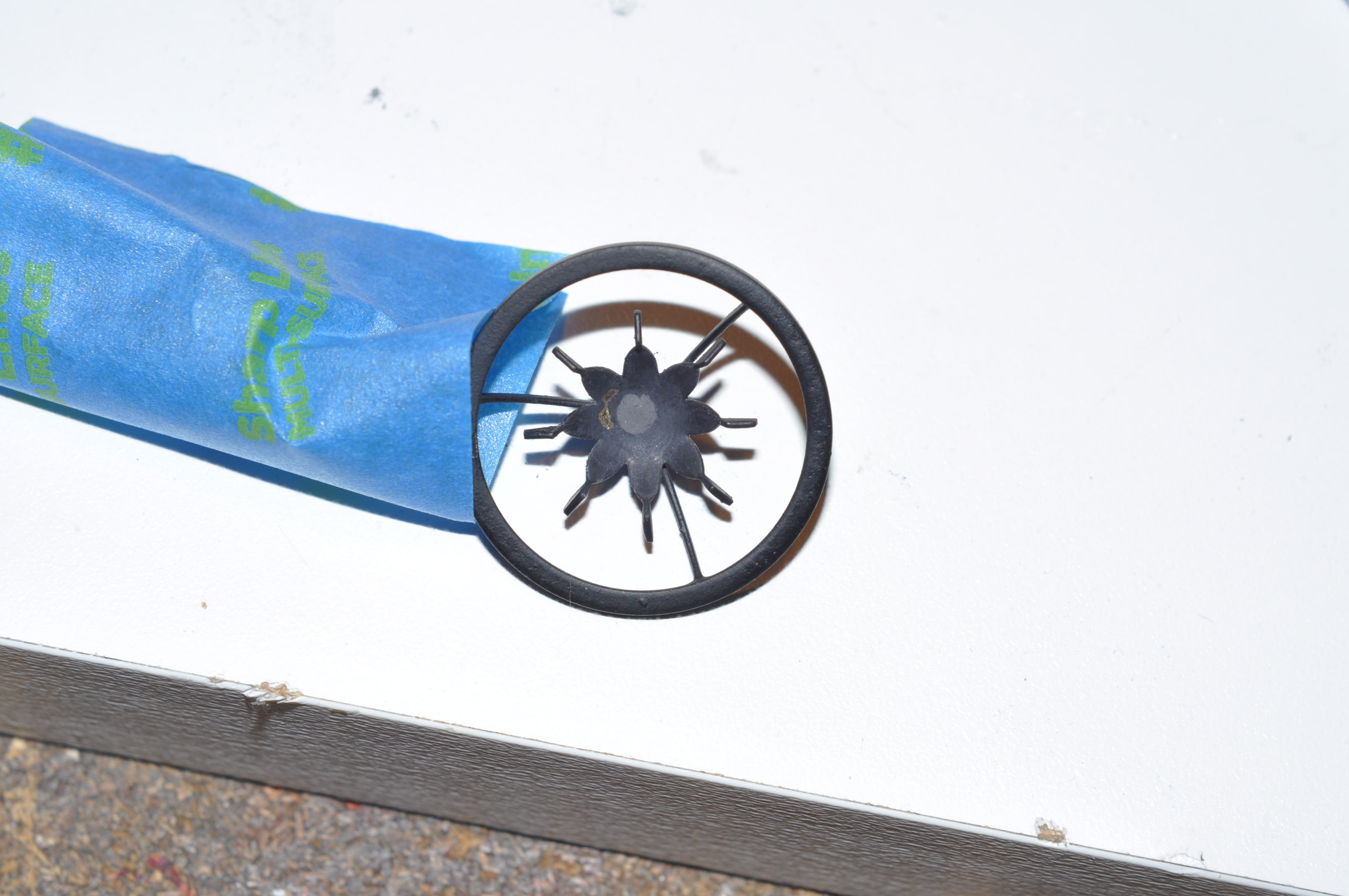

This is frustrating. I have painted thousands of things in my life, including full size automobiles. But there is some issue where the screw pokes through. The paint is not sticking in that area. Maybe the loctite on the screw.

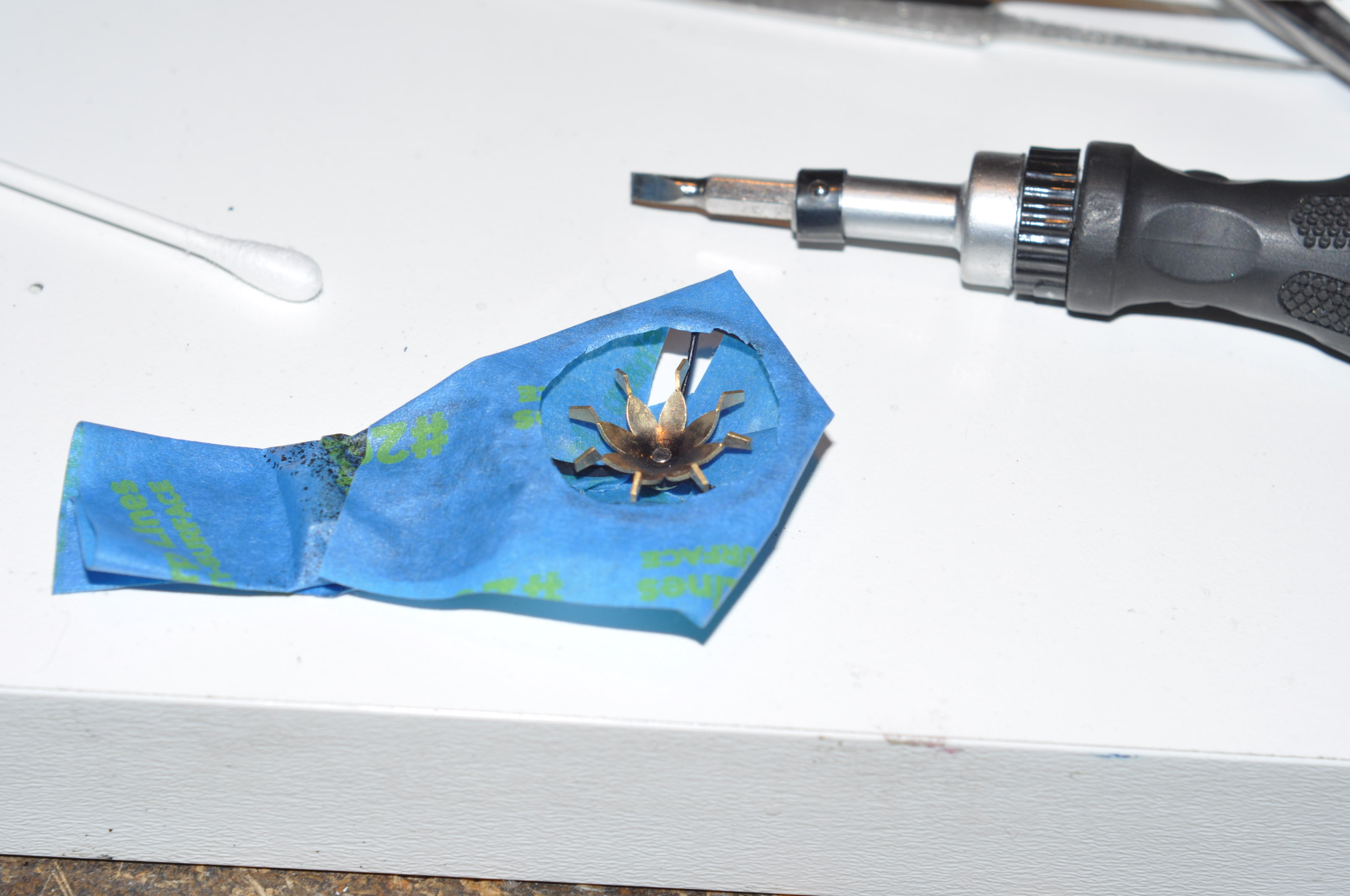

Now I have multiple coats of three different brands of paint and it is still not right. Time to strip all the paint and start over.

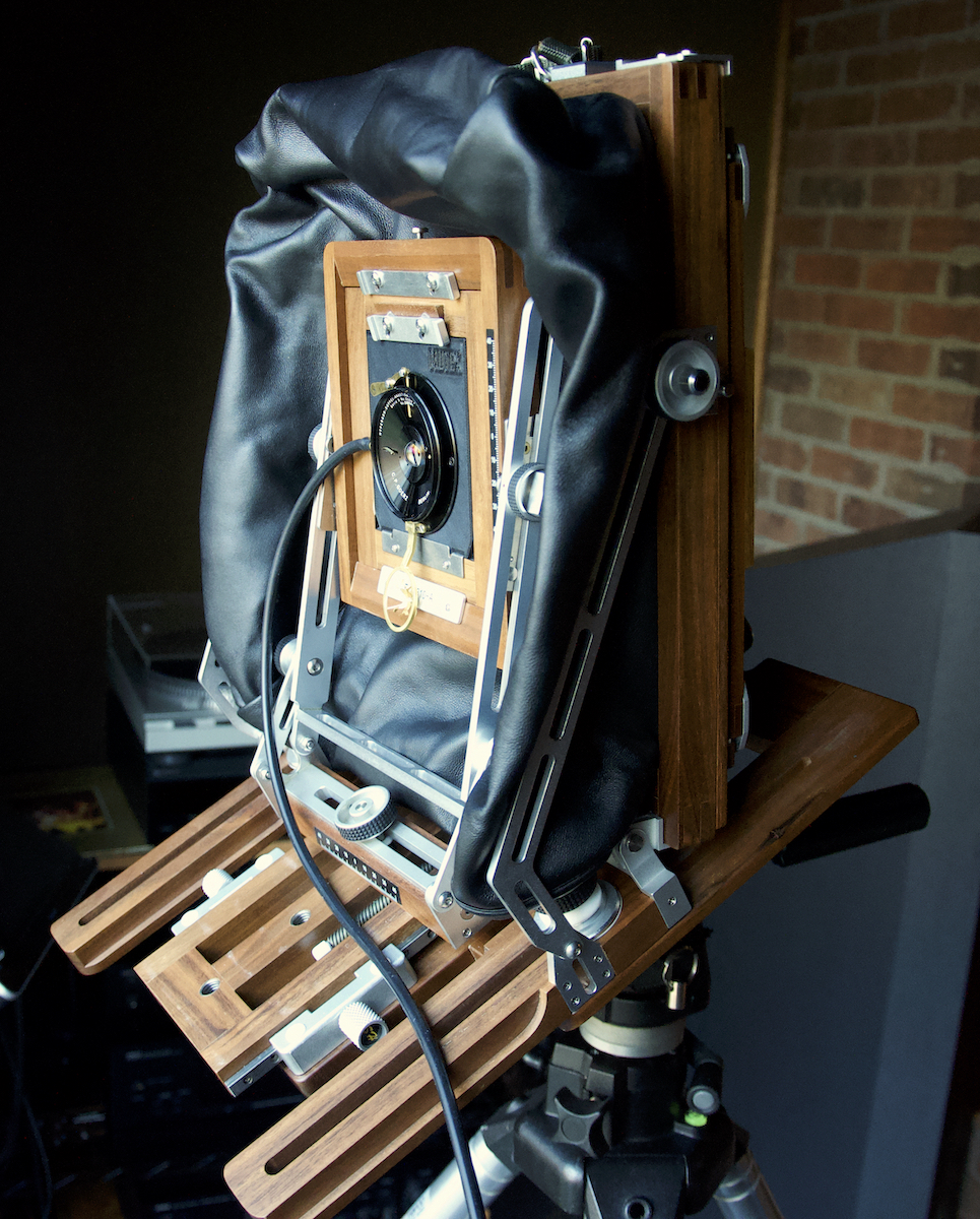

BTW I'm using the lens on my Shen-Hao. Thanks to the front base tilt, I can get the lens as close to the ground glass as I want. It could even touch, so 75mm is no big deal.
Redoing it. It is hard to smooth the transition to the screw as the screw is so much harder metal.

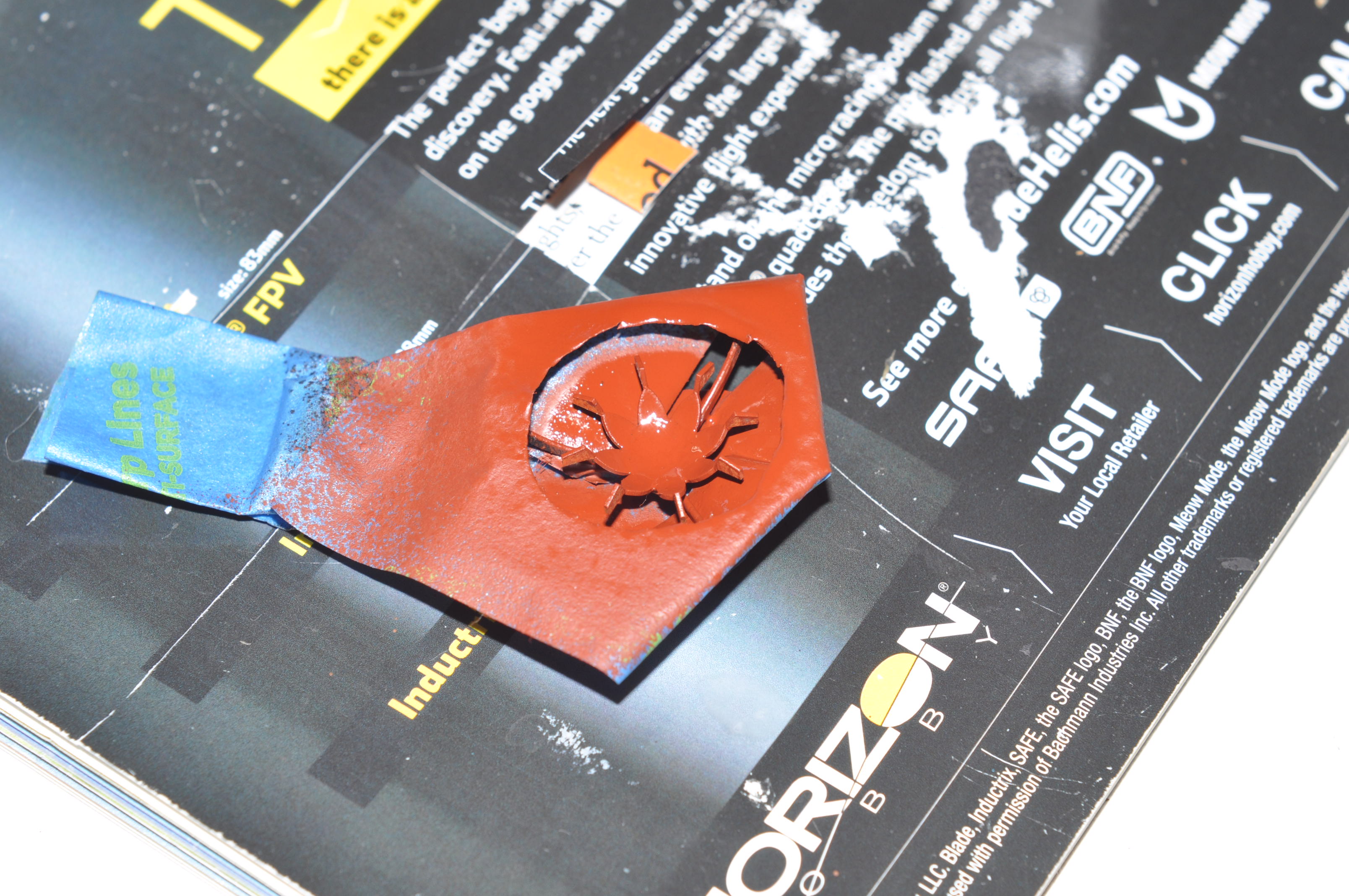

I tried a little dab of JB Weld (epoxy) over the screw, but that left an irregular border after painting.

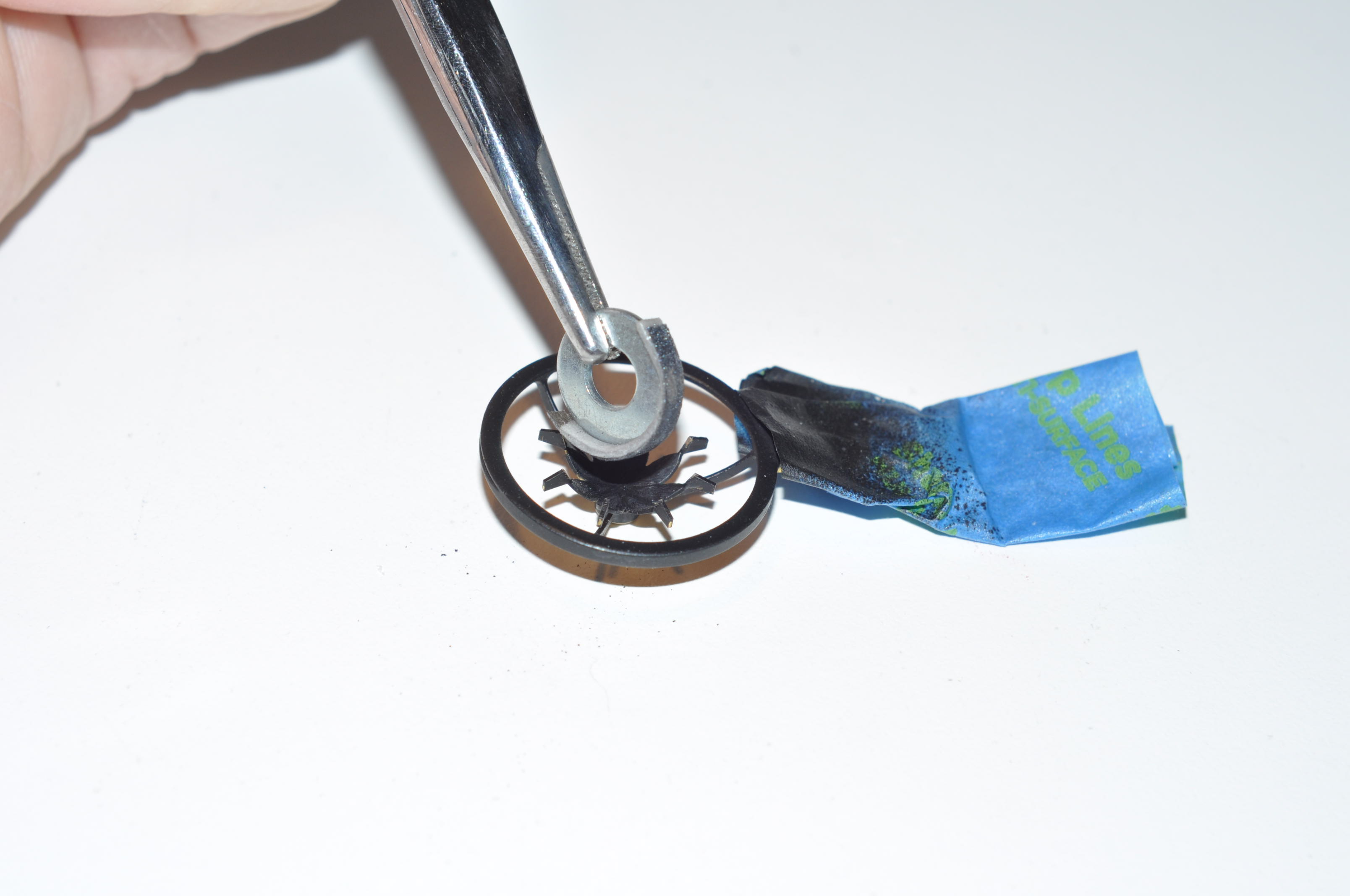

Using a washer of appropriate diameter, some 2 sided tape, and sandpaper, I tried to sand the screw to have the same curvature as the rest of the spinner.
Here I have stripped all the layers of black paint and will build up some primer at the base of the concavity so I can sand a nice smooth surface.

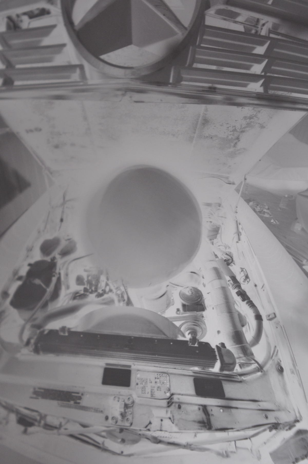

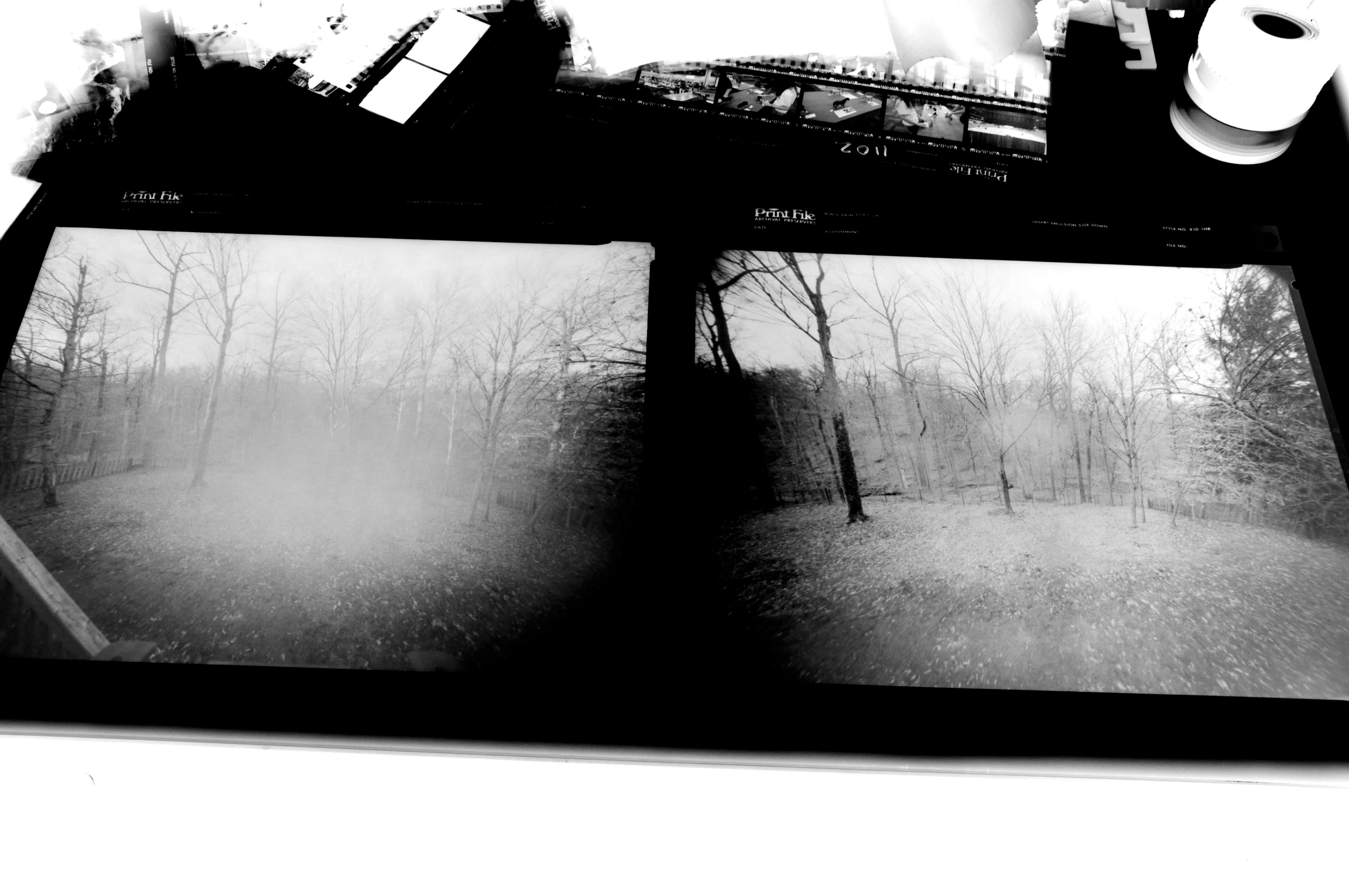

My first images (last December) with the lens (and original unpainted, shiny spinner) looked like this on the LEFT. The first attempt at painting the spinner shows on the RIGHT. But there still is a blush in the center. The negative on the RIGHT was taken with the spinner looking like the image in the first post of this thread. You can see the irregularity in the center of the underside of the spinner. Either oil from the bearing or Loctite seeping around the screw.
