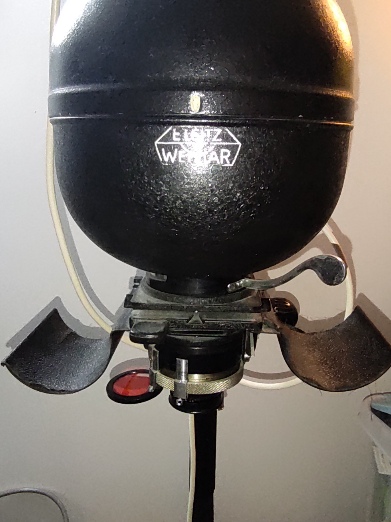

There is a red swing-out under-the-lens filter. That is where you screw in the filter holder for your set.

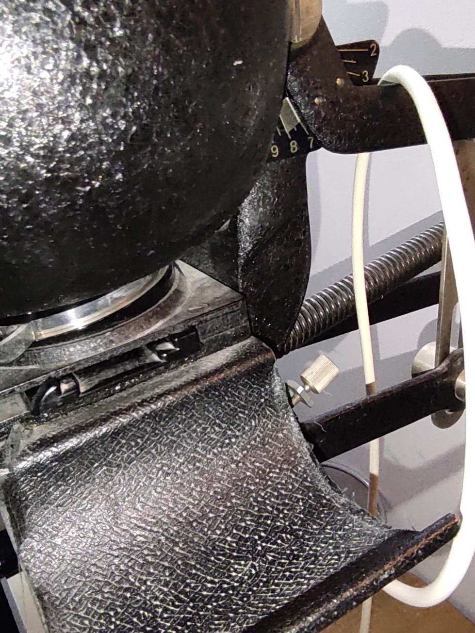

Examine all the wiring closely. I completely rewired mine. All the insulation was dried out, cracked, and flaking off - including the wires that go up the inside of the metal mast.

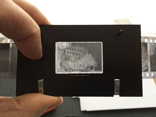

If you notice anti-newton rings in your enlargements, cut a thin piece of plastic or cardboard to serve as a top mask for the negative holder. There is an anti-newton ring condenser (it will look frosted) and there is also an anti-newton-ring cap that can go on the condenser. Hopefully, you have one of those.

Replace the wiring if it needs it. Just wire it directly to the lamphead. No real reason to replace all the wires under the baseboard. I just bought a heavy duty extension cord and used that. Easy to do.
I use below the lens Ilford filters on the Focomat. I rigged up a holder that attaches to the post for the red filter. Works fine. Just keep the filters clean. The Focomat Color had a filter drawer if you are getting one of those. Leica did make a below the lens filter holder but they are hard to find and probably cost Leica prices if you can even find it. I've seen people rig up an Omega I think under the lens holder too if you can find one of those. If you don't have frames for the filters just go on ebay and try to find some. You can even use Kodak frames without an issue. I think they are the same size as Ilfords. Might even have some around here.

You may nee to strip that old wire and renew the plug, I have bypassed the built in switch etc.,

Incidentally, I rewired the entire enlarger because I wanted to restore it to original functionality. And because I could do it - it took about an hour. The easiest thing to do is replace the cord to the light bulb with a cheap extension cord (cut the end off it). I just like that short cord from the head to the top of the post (I didn't need to replace that cord, it's made of different material). But the switch is pretty useless - no one will use the enlarger without a timer.

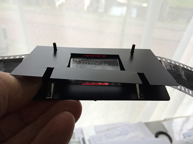

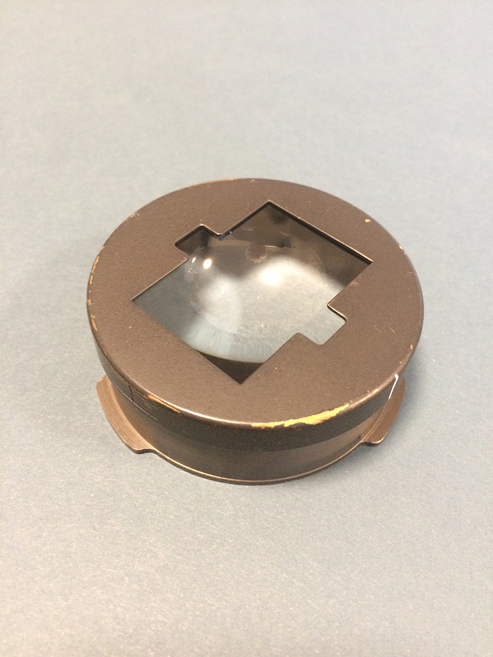

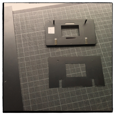

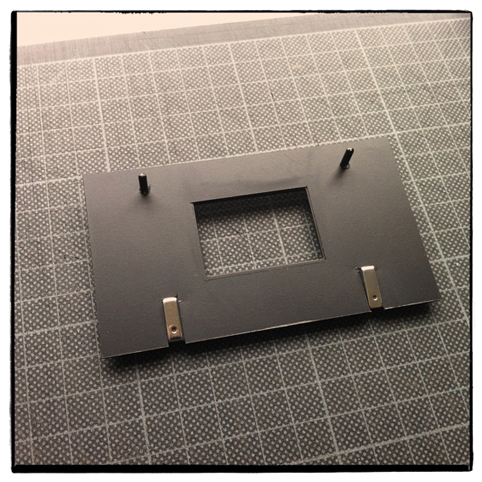

Don_ih: If you notice anti-newton rings in your enlargements, cut a thin piece of plastic or cardboard to serve as a top mask for the negative holder.
- Yes,
for cutting your own mask to prevent AN rings. These were even made at one point, for the Ic and Valoy II. Not by Leitz though.

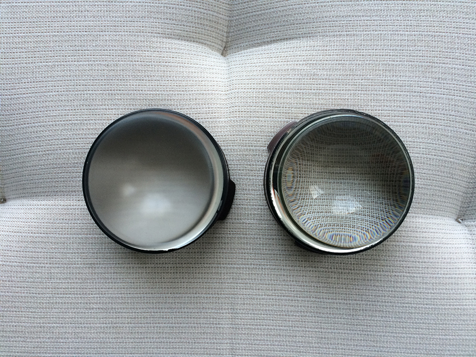

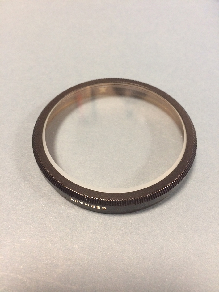

- There is an anti-newton ring condenser (it will look frosted) and there is also an anti-newton-ring cap that can go on the condenser.
Don, the frosted condenser only exists for the Valoy II.
- Yes, for the Ic it is best to have the round AN glass fixed to the condenser and pressing down directly on the negative. For perfection, there exists a 3mm copper ring that should go on the round ridge inside the condenser house, causing the condenser to be lifted up to compensate the difference. Many Ic's do not have this 3mm ring and I don't think it is a problem. Instead, there will be a much thinner spacer there, or nothing.
My own additional remark: the system of lowering the condenser with the attached AN ring onto the negative is fantastic.
Patrick Robert James: - It is called DOOFUS or something like that. Lol. I never get the Leica names for things
- Patrick, this spacer is called DOORX which later on became 17675. This spacer is essential to use with the Ic and the Valoy II.

- my own solution to prevent Newton rings with the Ic and the Valoy II
- a copper AN thing for the Valoy II (I have my doubts about using this one)
- the Ic AN glass
- a clear Valoy II condenser and a later AN Valoy II condenser
Thanks for that correction. I still haven't put a spacer in my enlarger head after adding the AN ring and there doesn't seem to be any problem. Although, now that I think about it, when I push the enlarger down to completely clamp on the negative, it does tend to shift the negative slightly toward the back of the enlarger. Adding the spacer may prevent that. Or it may not...
(Big Snip)...
I have a 1C that has an anti Newton condensor. It is not a ring, but the condenser itself, so maybe
it's just a very rare item. I also have a Valoy II that had a clear condenser when I got it, but I later got
a great deal on a Valoy II head unit that had the anti Newton condenser, negative carrier and a 63mm

I've heard of the insulation in the tube decaying and causing shorts
It's rubber insulated or something that perishes like rubber. They are not difficult at all to rewire, and if any of the insulation is failing, strip all the old wire out and redo it before you get hurt by it. In fact, if any of the wire still looks 'original' at this point in time, just replace it. Don't risk your health for want of a couple of metres of new cable.
Use heatproof cable if you feel it necessary.

Here the AN eliminator, made by S&S. (anyone knows this company?)
