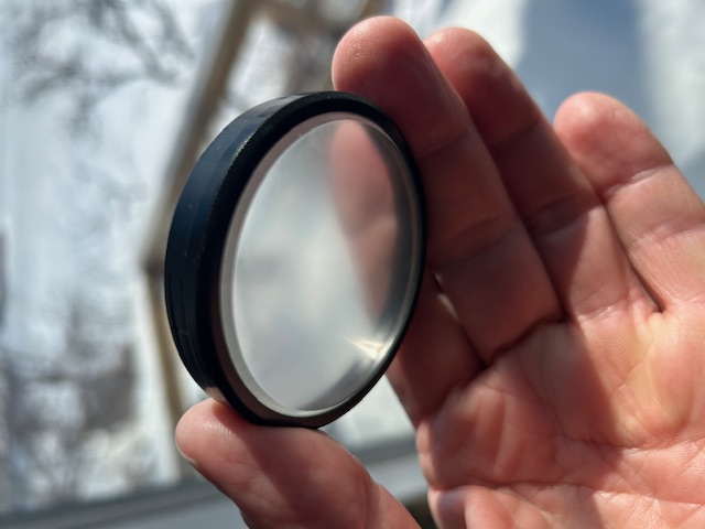

Here are photos of my AN glass. The holder slips on to the condenser. As mentioned above, I still fight Newton rings occasionally with this setup. I will try the masking idea mentioned above.
Perhaps someone can offer a solution to my photos posting sideways? I took these with an iPhone and uploaded them to Photrio with a MacBook Air. They appear correctly on the phone and computer.
Your AN glass looks okay to me, but I can't see if there's any damage on the lower surface. If not, it should work fine.
Is there a lot of humidity where you are, or when you do not use your enlarger, is it cold in the room where you keep it? Turning on a heater just before using a darkroom can lead to Newton rings. I had a friend in Cairns, Australia where it can be extremely humid. He had lots of problems with Newton rings and, if I remember well, the self-made masks were the solution.
Hilo, my AN glass looks fine. I live in the US in the midwest. There is a fair amount of humidity during parts of the year, but I do not believe that is the problem especially since I do most of my printing during winter months in a heated room. The enlarger is stored at room temperature. I have not done much printing lately. When I get back into it I will make a mask and try that when newton rings show up.
Tmax films can be especially prone to Newton rings. The secondary mask should work in every instance.

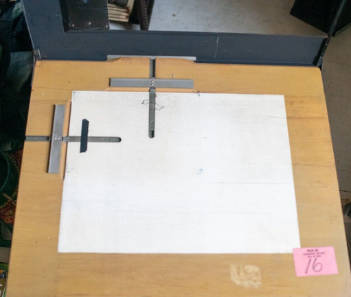

I'll borrow a photo from an ebay listing to show:
Those two grey metal things slide in those slots and can be used to position the paper. The white rectangle is paint and the edge of it is ok for seeing if your paper is square. But if there's any curl to the edge of the sheet of paper, and almost all my paper has some curl, it will move when you lower the easel frame. It's just a little annoying.

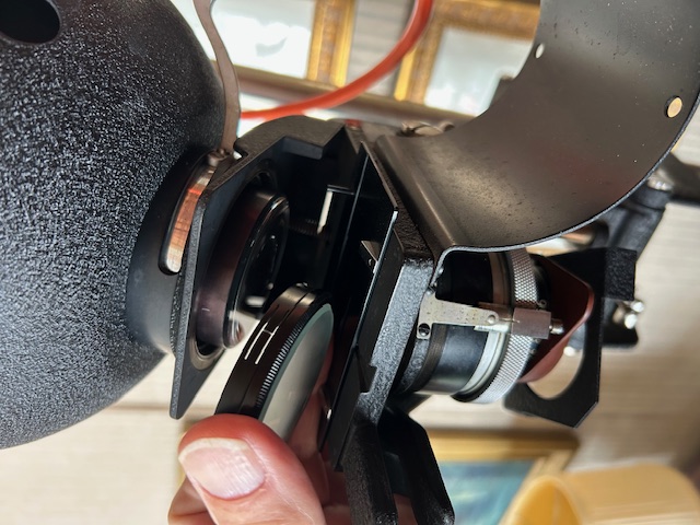

I think Leica enlargers had a single AN glass in the top half of the carriers. Certainly their V35 had one.
The condenser clamps down on the negative. It does not have an AN surface. There is a slip-on AN ring that you'll see on a lot of the enlargers. See post 52 above for a photo of the AN glass. The negative holder is glassless.

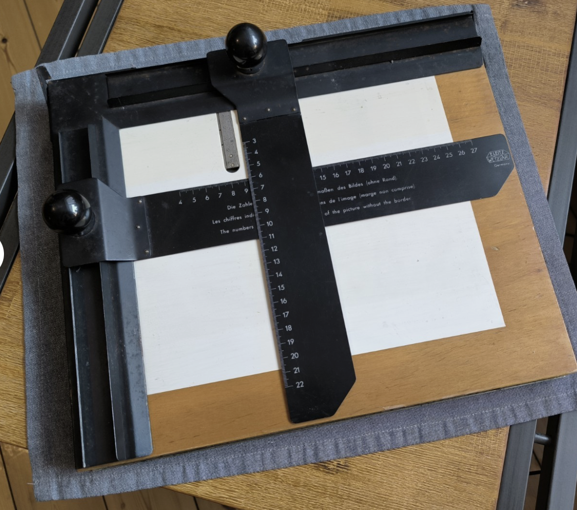

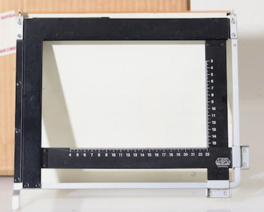

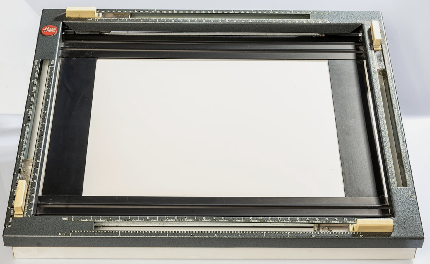

Another question - could somebody please post or link to a picture of one of those "locking" easels, that are being mentioned oftentimes?
I see a few different versions / models on the used market here (see images from eBay, below..)
From what I've gathered, the "autofocus" mechanics of the Focomats are originally set on these (1" thick?) easels, so it would probably be best to get one of those?
What is meant by "locking"? Are they locking into the base plate (how?), or can you angle them up, and they stay up, so you can postion your paper without needing to hold the easel up?

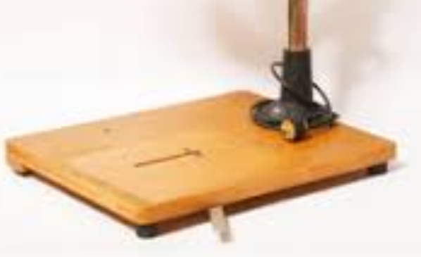

On the baseboard, there is a slot which allows a movable steel to slide forwards and back, which gets clamped down by the lever on the right:
(bad picture found online)
Easels that lock have grooves in the bottom that you slide the piece of steel into. So, with that in place, you position the easel and lock it down to the baseboard using the lever. It's a bit more obvious when you have it in front of you. However, a lot of Focomat baseboards have had that particular contraption removed, since the handle sticking out the side can be a bit irritating - especially if you have no locking easel.
Frankly, the fact that they lock is about all they have going for them. The bigger one is irritating to position the paper on. The smaller one is too small. I find the smaller one very useful when printing postcards for the postcard exchange, though.

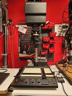

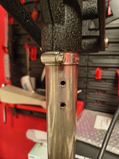

Leitz, when designing the Focomat, knew that there is a mathematical relationship between the negative-to-paper distance and the negative-to-lens distance. The Focomat controls that relationship with a very precisely machined cam (leave that to German machinists) that adjusts the position of the lens plane whenever the enlarger head is moved up or down. In the beginning, I always checked the result with a grain focuser, but I don't do that anymore because it's always spot on! AFAIK, the enlarger is always in tis mechancally-controlled auto focus mode, and it cannot be turned off. The big question is how it knows about the thickness of the base board, apart from assuming the standardLeitz board. The answer may rest with some people in the 'holy' city of Weimar.
That is adjusted by inserting a pin in the right hole in the column:
- the lower hole matches the baseboard, without an easel,
- the upper hole matches the baseboard with a 25mm thick easel (Leitz, Dunco, RRB.....)
For an easel with a different thickness one will need to find a DIY solution, like in my case a hose clamp around the column at the right height to match my Ilford 500 system with automatic easel

You need to calibrate the autofocus. Once calibrated (= setting the focus like with any enlarger, then locking the lens with a screw) it will always be in focus

Note: you need to calibrate the focus with an easel. Best is to use a Leitz easel, the autofocus needs to correspond with the thickness of the easel.
Many models have a very nice mechanism in the base board. When using a Leitz easel, this mechanism allows you to lock/unlock the easel to avoid accidentally moving the easel.
