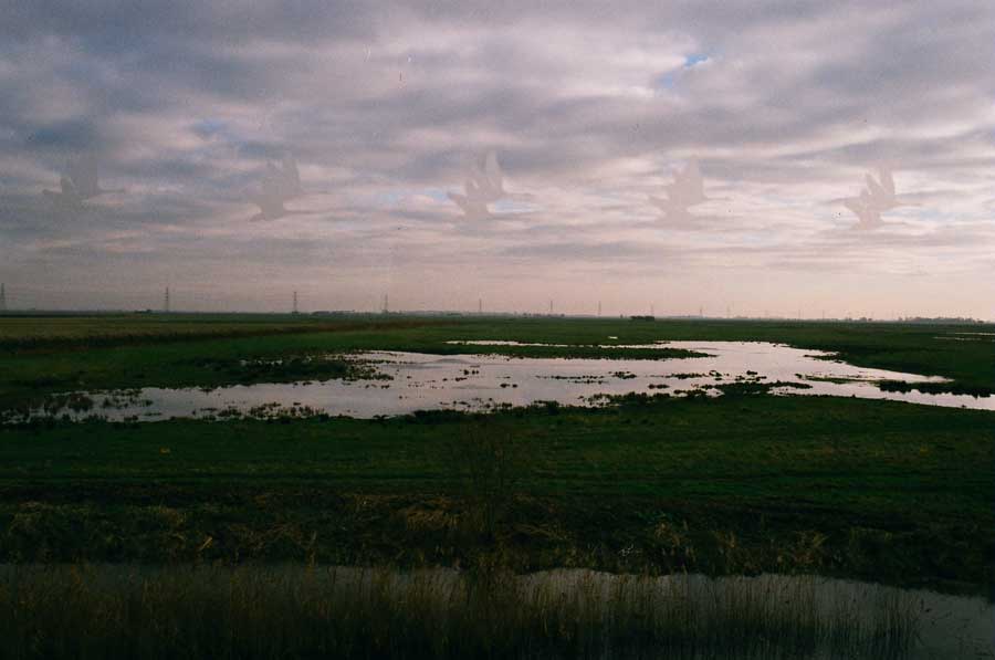

It took me a while to work out what was going on in this photograph. I took a photograph of two swans flying at Welney nature reserve but I have ended up with a series of ghostly swans flying in unison.
My only explanation is that the the swans were flying at the same angular speed as the shutter curtains were moving. Except that would give me two long, distorted swans, not a series. My next thought is that the shutter curtain was moving in a series of jerks - it is a Yashica 230AF camera from 1987 so 30 years old.
Would poor lubrication cause the shutter curtains to move like this? I can think of no other explanation.
Hm, after GIMPing the image a bit it looks like five idetical copies of the swans... is this really truely on the negative? Looks a bit like your camera did some serious copy and paste here :smile: So maybe a reflexion somewhere in the system could explain this? But anyway, a great image! If you are able to reproduce this technique you could start a series.
What puzzles me more is, the whole image is tilte 1deg right and the swans make up a line parallel to the horizon.. is this a scanning artefact?

Scanning artefact? I had not considered that. I did not scan the negative. I shall dig out the negatives and have a look. Thank you for the thought.
I'd have thought it might be due to a strobing flash that is too weak to light up the swans properly. If the shutter speed is low enough for flash (full frame exposed), that would do it. The swans are crisp but under exposed, as is the middle ground. There seems to be some extra light in the extreme foreground.
What would cause the flash to do this, I'm not sure.
I never had a Yashica 230 AF in my hands, but a quick search shows me that it has a vertical copal shutter with several plates. Is it possible that there are gaps between the traveling plates?
The swan images indeed are almost identical but I don't think they truly are. Is it possible you've confused which camera was used to make this image? Is it possible another type of camera was used that was set to take multiple exposures on one frame? If you can't find the film negative then that might hint at an answer to the question:smile:
Yashica 230 with stuck film and continuous motor setting might repeatedly expose the stuck frame about 2 exposures per second.
So, a typical 1.25 meter swan flying at a typical speed of 10 meters per second will appear to travel 5 meters (4 lengths) every 0.5 seconds in a photograph.
Unable to confirm this, as the jpg quality is to low. But isn't it highly improbable, that the swans are flying in a completely synchronized manner (synced to shutter failure AND to one each other)? I'm not sure :smile:
So I keep up my theory: This is a kind of reflexion or artifact in post. But a better scan of the original neg would be of help here, to see if the swans differ...
Have you checked to see if there are any swans left in your scanner......
OP - Did you use or have a flash attached to the camera? Also, do you recall if you used a relatively long shutter speed, like 1/2 to 2 sec?
Other than ic-racer's suggestion that the same frame was exposed 5 times, possibly the flash fired 5 weak bursts while the shutter was open....
Unless you did this intentionally and are just pulling all our legs, to see what crazy theories we'd come up with :errm:
That's not what I meant. I suggested the camera was on a tripod and took multiple exposures with the extremely unlikely speed setting that captured the same pair of birds in multiple positions but nearly precisely the same wing position. I 'hinted' that it might have been a digital camera on some weird exposure setting. This is why I wrote that if he can't find the film negative that might be a hint at what really happened. But jimjm's suggestion of a flash set to multiple pops is a good one.

Notice how ghostly they are. The shutter was tripped too late to capture the swans at all. What you are seeing are the first through fifth harmonics of the swans.

I just noticed that (if only one bird) the bird slowed down as it moved from left to right...the first 4 images were precisely 805mm apart, but the last one was only 802mm ahead of the prior image. It must have encountered a sudden headwind.
If it was a flock of bird recorded in one photo, it must have been the Ternderbirds as they were flying in near perfect formation (except for the lead bird) and in perfect unison of wing flap.
Images moving with the shutter slit at same direction and speed would form a banding, not a recognizable image.

Those multiple exposures are far too dense to be only one of five exposures. Something... ain't... right... here.

It looks like you exposed an image through a glass door or window with those fake etched glass stickers people apply to stop themselves from walking into the glass.
