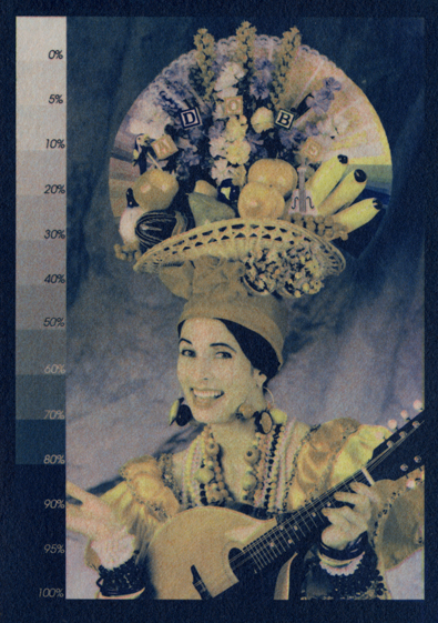

With some renewed energy I wanted to try and get my cyan-gum prints working. As before i am still having problems with the magenta layer. As people suggested I started using the colour ole file to calibrate. The attached image is the cyan and the yellow layer. Am i nearly there to what you should be getting at this stage?
This is even without bonding to aluminium, so at the moment i might forego that stage and try and size the paper to see if that helps my M layer proplems. Can I use any PVA glue or does it have to have a specfic type of PVA? Can I size after the cyanotype and magenta layer? I have seen nerchau caparol binder used, might that be better?

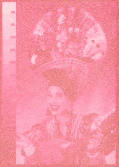

I have also attached a scan of just the magenta layer (PV19), this is on Fab Art (acidified) Clearly I need to try a new method of getting this M layer down.

1) The Yellow pig over Cyan looks about right on my monitor but you won't really know until you have printed the Magenta layer to see the final color balance.
2) What Magenta are you using? I know you listed PV19 but is that Quinacridone Violet or Quinacridone Rose. You may need to try several different brands. If possible try M. Graham Q. Rose. The M. G. watercolors use honey as part of the binder and that seems to make a big difference with some colors.
3) Also use as little mag. pig as possible and coat thinly and expose carefully, Over exposure with the Magenta can be very problematic for development. One of the best solutions for slightly over developed magenta layers is to perform some physical development with a spray bottle that can atomize (a very fine mist) the water spray. Use warm water to.
4) Another key to improving the magenta layer results is to use a blending brush to smooth the layer as the final step in coating.
5) Do you have the Ole Moire with the color patches? I find that one is a good test image also.
I think it is fair to say that many people come to tri-color gum thinking that the process will be a rote process. The truth is that it is anything but that, at least in the darkrooms of individual photographers like us working outside the rhealm of manufacturered media.
thanks
I haven't worked with the ole no moire file, but for color fidelity work it helped me to print the positive separations in aggregate combinations with my printer to see how close I was getting with my gum pigment layers. I print cyanotype-y-m so I printed out the cyan positive, then the cyan + yellow and finally the full file c+y+m. Made for a nice roadmap while I was profiling curves and pigment concentrations and trying to get my head around how the colors combine.

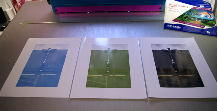

Don, I just delete the channels I want to exclude in each printing, straight from the RGB file. The solo cyan layer positive (or any other single channel) will look like a grayscale image in PS, and the print preview won't look right at all, but the correct cyan info does seem to get sent to the printer driver.
I use printer managed colors, not PS management, because I've been proofing on art paper and need the driver saturation controls to reduce dot gain and get the saturation right. But it seems like it should work with PS management/ regular inkjet paper profiles...But for really critical color work some serious profiling and calibration would be in order.
Here's what it looks like on some cheap Epson glossy-

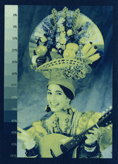

As always thanks Don for taking time to reply and making suggestions, much appriciated. The Magenta I am using Permanent Rose (PV19). I have increased the dichromate to gum ratio, which seems to help a little. When you do this what does it actually do, also vice-versa having a higher gum to dicromate ratio?
I have attached a scan of the final result of cyan-gum print test print. I am quite out at the moment and there is still little traces of fish eyes in Ole face. I will just have to keep trying various methods and different reds, i might try and move the magenta layer to the second coat rather than the last. If you could email me the ole file with colour patches that would be helpful. many thanks (davidchow2002@hotmail.com)

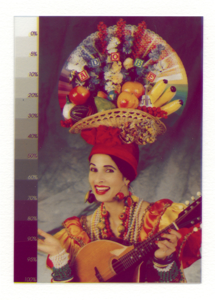

This was such a great idea, I should have thought about doing it earlier!
I printed the CMY layers individually on transparency film and then cut them out and layer them on top of each other and placed on white paper, works a treat (see attached). A really good way of seeing how the process works for those starting out gum printing.
