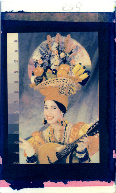

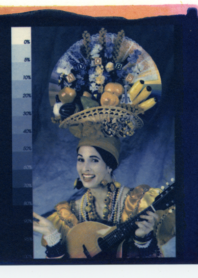

Have been feverishly printing today and have moved the magenta to the first layer, followed by cyanotype then yellow, at the moment it has solved my fish/eye problems. Colours are out but its progress (see attached). Will try and make some larger prints to see how the paper holds up. I have not had to do any pre-treatment to the Cot 320, registration just by eye seems okay but will get a better idea once i try larger sizes.
That's looking pretty darn close. Red a little off? Yellow & blue look good to me, but I'm easy. Good job.

Yea, I'm curious too. How is it registering to yellow? Really like the shot of the doors, very rich colors.

Thanks for the suggestion, at the moment i using the cyanotype as the first layer, its obviously limiting, and i am having to underexpose the C layer as the final CMY print does have a blue hue to it. Like you say there are many ways to do this process you just have to find you own way of working it all out, its pretty challenging but if you get the print you want its worth it.
I think if one aims to get photo-realistic gum prints, in terms of colour, like Keith Taylor it would take a significant amount of calibration, also the fine tuning of ones technique which takes many years.
P.S i like the gum over platinum print of the hand, can you tell me a bit more about it like which platinum technique and what colour pigment, also is it the same negative printed twice for platinum and gum?
Thanks Ron, have attached the latest test which is using the cyanotype first, then magenta then yellow. The reds are not as strong as i would like them yet. I am just testing double coating the M layer (PV19), i.e coat, dry then re-coat. Does anyone else do this? I would prefer this than having to do another M layer exposure.
Have you tried diluting your cyanotype with water to get a lighter blue? Your problem is opposite of my usual issue of too much red and the need for 4th layer of blue to balance it back out and sink the shadows.
I find that a quick coat of PVA diluted 1:1 with water make for a good size after I have a few of layers of gum down.
