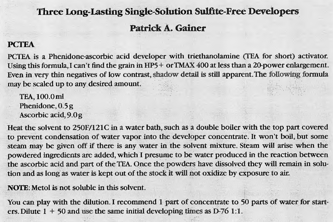

PCTEA is a remarkable and convenient invention, even though it was founed relatively recently (around 2004), there isn't as much test data as D-76. The equivalent information was provided by the inventor, Pat Gainer (R.I.P), and the screenshot is from The Darkroom Cookbook, 4th edition. Gainer actively participated in discussions on the forum and might answer you himself at past. What I want to convey is most that consulting documentation from inventors and salers can resolve many problems.....I may start with PCTEA 1:50 for 8:45, comapre with D-76 1+1, and then make slight adjustments as mentioned above.
