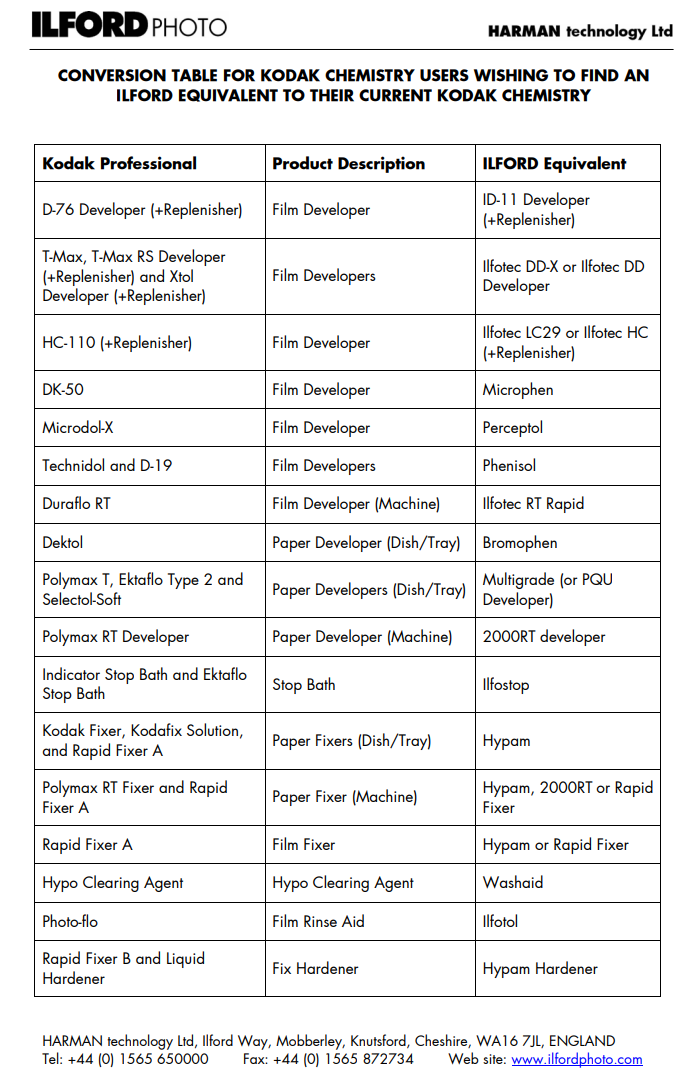

Back in time, developers knew that ID-11 was equivalent of Kodak's D-76 (Ilford was keen to ensure everyone knew this! they send a "kodak-ilford-equivalent.pdf") So, you already know the answer...

Harman only provides instructions for Ilford developers and I think also D-76.
That's enough to infer a good starting point for any given developer.
For those of us who are new.... How would I do that? Let's take Kentmere 200 as a concrete example that I care about. How would I use the posted times for Ilford developers and D-76 to infer a good developing time for Rodinal or PC-TEA? (the developers I have on hand).
