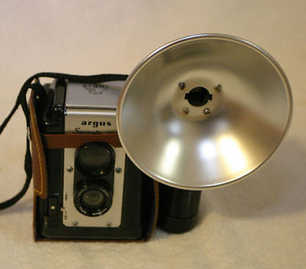

Hi, I've just bought an Argus 75. The flash unit comes with it has a reflector measured about 4.5 inches. Is it considered to be a 5 inches reflector? and what kind of bulb will it take?
I can't say for sure without seeing your unit but the Argus units I have seen in the past took the bulbs with pins on the side of their base. That would be the #5 or Press 25 or bantam 8. With an adaptor they could take the M2, M3, M5, M25 bulbs.
Look on your unit most flashguns gave a distance to subject to use with a listed bulb. The bulb listed is the one you need.
RE

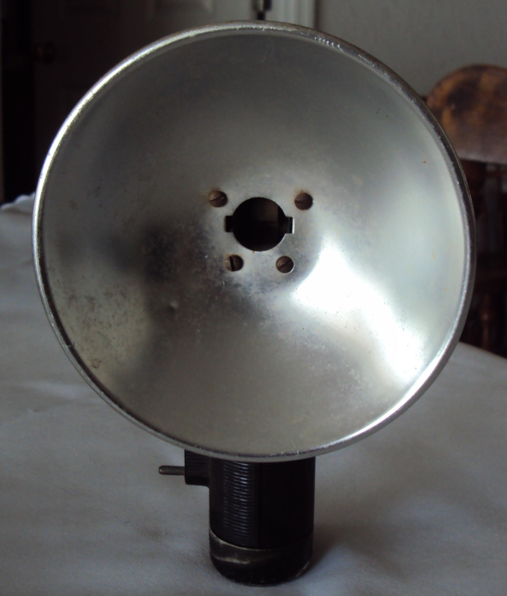

My camera and flash gun look something like this(photos from internet...)
PS: A few bulbs with unknown bulb size(I didn't know how to differentiate the bulb size) come with the camera and they can fit into the flash unit(those bulbs have two small pins at the side each, and just need to push them into the reflector and they stay in there)

The only bulbs with pins I know of are the ones I listed as the first reply to this question about your flash. Any of them should work.

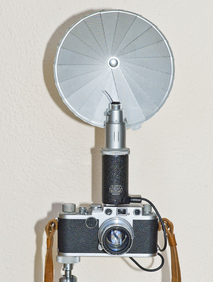

I have decided that bulb flash looks nicer with B&W film, as opposed to the Leica 24-D and 58-D flashes I use with my M8 and 9 cameras. I have recently found a near mint Leitz CEYOO to use with my IIF and M4 Leicas and I had hoped to use it with my Rolleiflex 3.5F Planar TLR as well but the PC lead will not fit, as it is the early shallow push on and turn Leica type. I have been lucky enough to locate a Rolleiflash, complete with ring, arm and reflector for just £12. I have a pair of SBC to small base adaptors and I am on the point of buying an SBC to PF adaptor.
For bulbs, I am proposing to start with PF1 and PF5 for the Leica and M3 for the Rollei. I only really take B&W in film now, so not worried about blue bulbs. Any other suggestions as to good bulbs to start with (taking availability into account, remembering I am in Europe).
I am probably going to replace the capacitor in both flashes. Someone has in the past replaced the Leica capacitor but it looks like some time ago and the soldering is of the splatter and hope variety. Amazon have axial wire 470 μf/35v capacitors but not the original 100 μf. Do folks think that the high value capacitor makes any difference other than taking slightly longer to charge after you put the bulb in.
Below pics of the CEYOO and Rolleiflash

First off as far as capacitors go they are not as needed as in the past. Decades ago the standard zinc-carbon battery held little total charge and had a short shelf life. So even when not in use they would get weak just sitting in the flash gun or in the unopened box on the store shelf.
Several of the Kodak flash guns from the 50s could use regular AA batteries OR a 14 volt battery in combination with a capacitor. The capacitor just ensured that the flash went off if the battery was weak. Since 14 volt batteries are hard to come by today I just uses the AA batteries. With a fresh (unexpired) set of modern Lithium or Alkaline batteries I have never had a problem. Modern batteries are good for years on the shelf and setting a flash off only takes a very small part of their total charge. They should be good for 1,000 of flashes. With old style zinc-carbon batteries Kodak said to replace the batteries after only 100 flashes.
