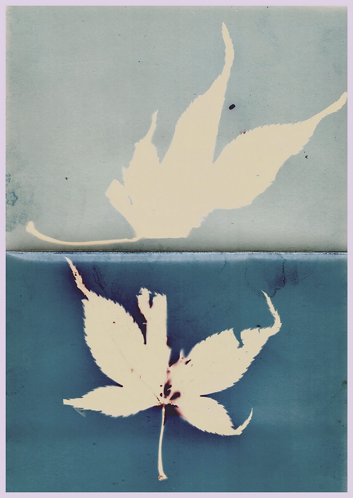

When you expose undeveloped photo paper to light, it will fairly quickly start to change colour - that's what printing out is. Printing out paper was commonly used for making photographic proofs that were given to customers. They would only be viewable for a short period of time because they were unfixed (so they'd just end up black rectangles). You could fix printing out paper to make the print permanent. Enlarging papers are to be developed and they don't print out as strongly as old printing out papers - but they do still develop when exposed to light. If you look up Lumen Prints, you'll see examples of images made on photo paper without the aid of developer.

Look at lumen prints for example. Those prints never touch a developer, the image is instead created by bombarding the silver halides with sunlight. After that the print may be fixed for permanence and lose it's colour, or just kept like it is to preserve the colors for a while.

An unfixed lumen print - in this case a photogram:
That is, however, done with more light than one would find under normal daylight illumination for the time it takes to fix out paper.
