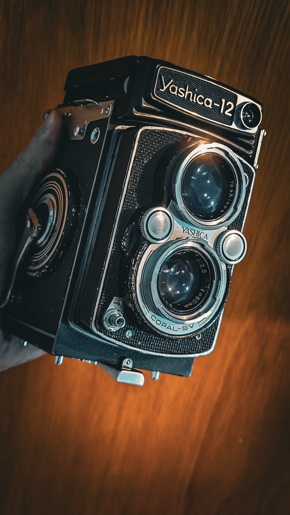

Thank you both for your very, very helpful assessment—it all makes sense now:
And indeed, the winding stop arm was adjusted to the radius of the rotary disc without the claw running inside. It should have been adjusted to the radius of the claw running inside, as can be seen in the monopix video. That's why it kept getting stuck instead of running smoothly.
To my surprise, it could actually be bent into shape by hand without tools, I tried to do the best I could, as the metal seems rather brittle.
Apart from the lack of lubrication, and the now really worn out used film, which gave additional resistance, it now runs perfectly in my opinion.

I tried it yesterday without a film - and it sounds very much like a newer, serviced clean 124G. There will be a noise, but it is not louder than my Olympus 35RC, when advancing. Only the shutter is surprisingly louder than on my Yashica635 - but the later slowly needs some service.
1967 reloaded - and back to duty. This wasn't a camera stored in a vitrine - the patina and dents shows, that it was actually in heavy use! If it could, it would tell stories!
Many Thanks to you @Dan Daniel and @monopix - without your help I wouldn't have it done! I have learned a ton about repair and old cameras. In near future I will solder the sync-cable, but for now I'm happy. And maybe I find some deeper information how the lightmeter is built - it reacts on light, but not the way it meant to be.
