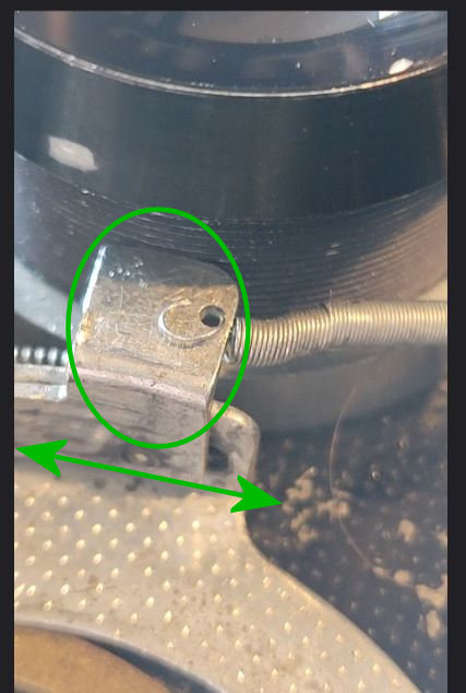

as soon as I put on the lensboard and operate the crank, the tab of the Shutter Cocking Plate Assembly that moves the main spring lever on the Copal shutter seems also to lift the entire lensboard 1-2mm upwards. When lensboard is screwed tight, this creates resistance on cranking and noise on the lensboard when the crank is turned. Without the lensboard, the film transport runs quietly and smoothly, as it should.
I have checked the position of the Copal Shutter housing - all washers and spacer sits correct. I checked the main spring lever - should be o.k., I checked the clearance between the lens board and the tab of the Shutter Cocking Plate Assembly - no contact. I don't really understand where the fault lies, it seems to me somwhow that while cranking it lifts the Main Spring Lever of the copal, and with that the whole lensboard.
But why? And how to solve? Any Ideas?

You've identified the reason - the cocking plate is trying to push the shutter cocking lever beyond it's normal travel. Either the shutter is not fitted properly and needs rotating around a few degrees or the cocking plate is bent.
From your picture, it looks like the shutter is not seated properly - it looks tilted - but maybe it's just the picture. But I would check you have the pin on the back of the shutter properly located into the slot on the front standard.

I checked the proper seating of the shutter several times - the pin is properly in the slot. The cocking plate is flat as it should. The shutter and lens barrel seats tight as it can be.
But indeed there seems to be an "Over Travel" - the rotation linkage lever driven by the crank, which moves the cocking plate will travel till the end on its rail. From some videos and trials I guess usually it should stop 1-2mm before, but here it travels more and begins to lift the whole lens plate. Additional factor: the metal tabs are quite soft, I can see notches made by contact of the levers.
While repair and check with an empty film roll the winding mechanism blocked - then maybe I put too much force on it, which affected the inner mechanism of the linkage arm. Oh my....
Check the tab for bending. And think about bending it to the position that will give you the right travel. This part of the Yashica shutter cocking is prone to this. Watch out for creating new interference like the tab being slanted on the top edge and finding a new place to bind.

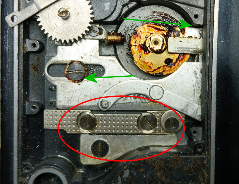

Not sure which screws you've tightened but the height of the arm isn't really adjustable. The height is set by the screw in the slot and top edge of the arm against the chassis (green arrows in my picture). These points need to be well greased. The 'arm ruler key' should be adjusted to keep the arm against these points with no slack. If you slacken the screws I've circled in red, push the arm ruler key up to the focus arm then tighten the three screws in the arm ruler key then adjust the position of the wedge shaped piece underneath to press against the chassis and the arm ruler key to stop it from moving.
This is my understanding of how it should be from observation and trial and error. Feel free to disagree.

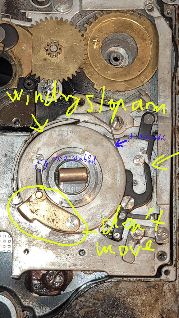

The symptoms are as follows, when follwing conditions are matched:
- Film loaded, pulled to the mark, crank in position pointing towards the lens. Back cover closed.
- The film can now be rewound to ‘1’, and this first image can also be exposed.
If you now want to rewind again, the crank can no longer be turned – neither forwards nor backwards.
I have to open the back cover to be able to turn the crank backwards – forwards is not possible – only after I have released the shutter again.
I opened the side panel (two springs already dissasembled), when replicating the issue:
The part which is circled in yellow and won't move, will sit between the winding stop arm and the rotary disc when the crank is facing towards the lens.
If the crank is not facing the lens, it will sit outside the winding stop arm, and everythings works as it should.
I can't understand why this should make a difference.

The spring at the blue arrow is out of position.
Where is the counter? That is integral to proper operation.
