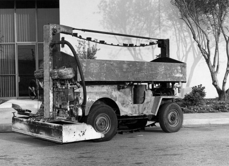

Put some wheels on it and that would make a great Zamboni, and think of how quickly you could coat miles of film!
Good idea. We simply need to find a large tunnel, close both ends to make it light tight and the part where the wheesl drive over the film will be sold to hipsters looking for a special look at double the price :smile:
