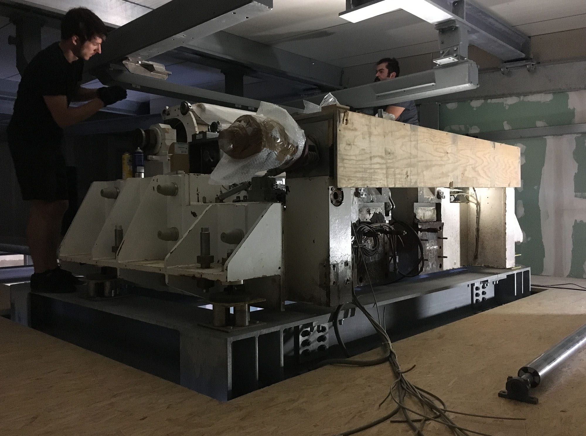

We started working on the coater and web. After 10 years of sleep the Agfa technology was woken up and adopted. Later we will merge her with Ilford´s Swiss technololy.
The dry construction guys (actually a girl) finished the walls of the melting and coating control room. Once the dust has cleared we can continue on the web.
The coating table shown (with main drive, coating roller and measurement rollers) was responsible for millions of sqm´s of Agfa´s Precisa, Vista, Ultra, Scala and APX from 1994 until the end in 2004.
We reinstalled some passive web rollers to simulate the web travel in order to start calculating the new web-tension and torque for the new motors. The old DC motors will be replaced by new direct driven AC motors.
In the front is the swinging (!) coating roller. What a piece of luxury! Gap adjustment via a swinging roller against the cascade slide. Love it!

In Marly we are by now fully operational. We will start producing film soon. This took us almost 4 years and we are happy to have made this achievement.
What you see in the images here is the Agfa coating table with coating roller and main drive before the coating. What you cannot see by now is the actual coating die. This is because we have not mounted it and we do not plan to mount the original Agfa die. Instead we plan to mount one of our swiss coating dies. This is because we want to be able to transfer recipes from one machine to the other and consolidate on the technology. In the short term we will produce everything in Switzerland and use this machine for trial coatings only even though it is larger and more powerfull. The drier will not be completed just the actual coating, stiffing and some web to run a few meters of product and stop. In the long term we want to build a second fully functional machine which we manufacture in house and of which we know every nut and bolt (more importantly every bit and byte of the controlers). It is actually easier to this than to learn everything about the swiss machine. Apart from this producing paper is alreaday prohibitive in Switzerland because of the high costs and low capacity of the small machine.
We will do this with the first batches of Polywarmtone to get onto the market but we will loose money doing so.
So in the long term we need a more productive machine for this and here it is "evolving".

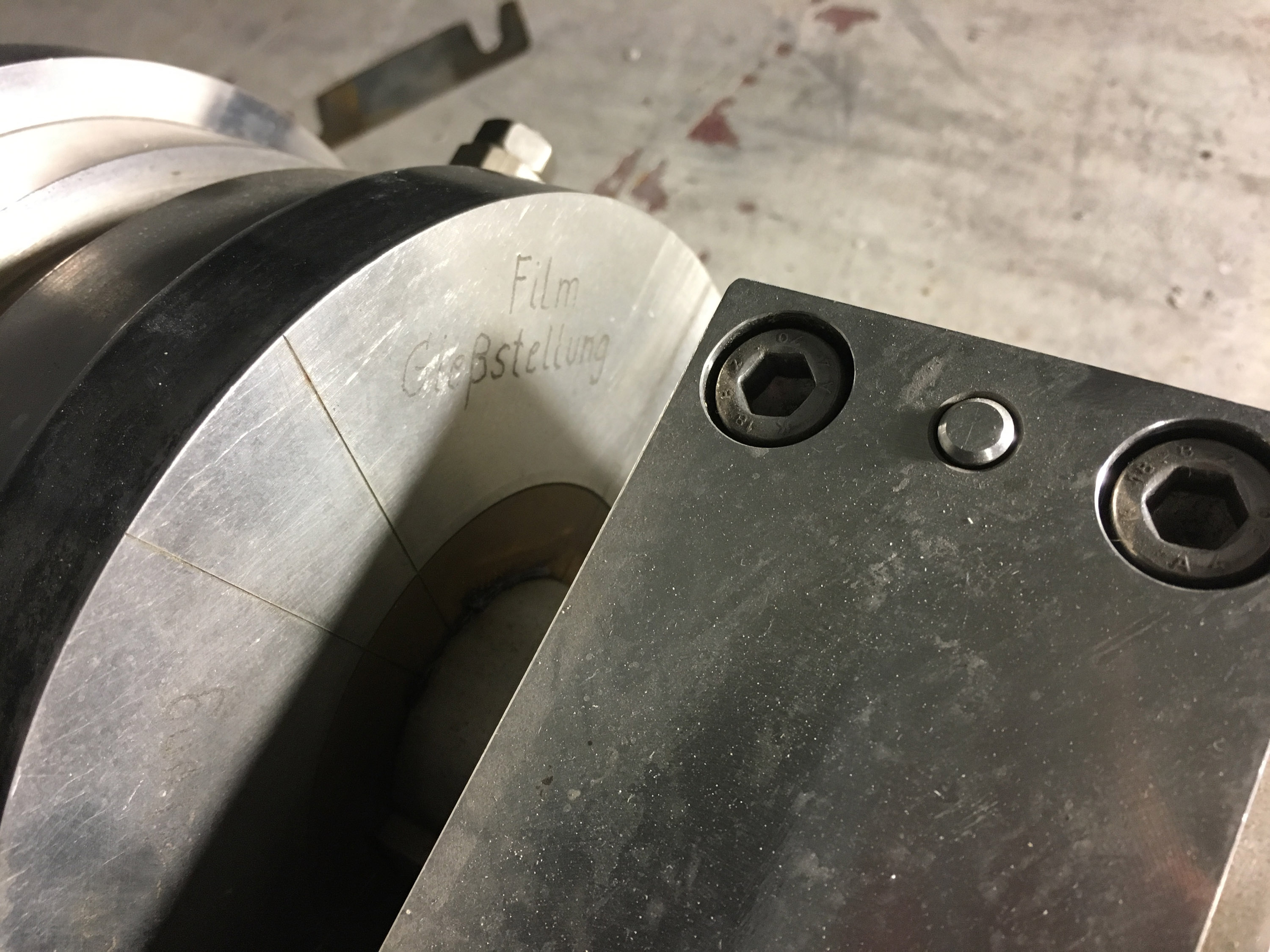

Single layer slot die?
Cascade slide. Not mounted yet. The rust in the front was inbetween the coating table and the arms carrying the die. Agfa never took these off during overhauls. We need to clean this and paint it with an even, thin cover. Not sure how to do this yet. Possibly just oil. Then we will mount the arms. Each arm has 4 ankers wich need to be tightened with a special tool. The original die weighed 1,6 tons. The table weighs 6 tons. This is so the die is perfectly even. We need some adoptions to mount the swiss dies. This requires still some engineering but is doable. The nice thing about this is that the coating roller can be swung away to start and stop the coating. We might do a video on this next week. The die does not need to move with all its mass and hit the gap-stones. So you don´t have scatter in first meters after dipping in.
