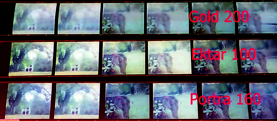

IDK about this, @Andrew O'Neill . The color balance really doesn't look any different on the light table:
What you're comparing is not so much Gold 200 vs. Gold 200 + 1...it's more "Something the Epson software does with Gold 200 vs. something else the Epson software throws me if the negative happens to be overall a little more dense."
At this point it becomes a bit of a philosophical question of course whether you're comparing film/exposures etc. You could argue that the imagine system as a whole for some reason gives you a different color balance - and since it started with a difference in exposure, then it's fair to conclude that the final output is different as shown. However, I personally find it problematic to subscribe to such a view if it turns out (as is the case here) that it's really not the film that's creating these big differences. Instead, it's mostly due to the scanner doing a black-box thing.

The color balance looks very different between both the film and the exposures. Shoot a color chart/gray card and get a consistent white balance. That would be a start.

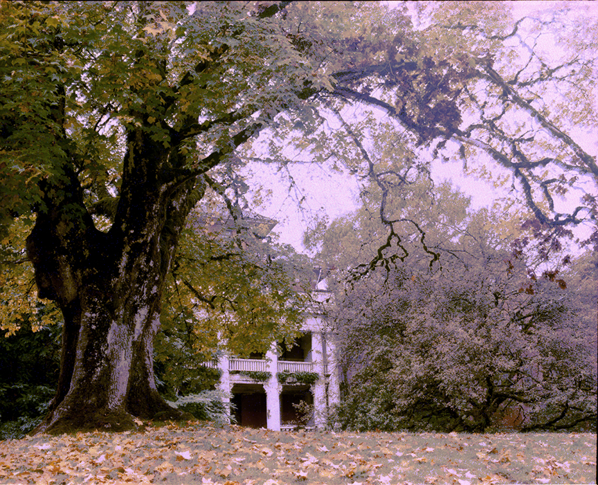

I piddled around with one of the images, following your advice, @koraks. I like this for tri-colour gum, but I'd like to knock a bit more of the pink out of the sky...I could do that, but lost too much colour saturation. It also has a bit of a posterised look, which I don't really care much for...
Yeah, I see the problem; it helps if you scan them as a positive and then invert manually. Ensure nothing clips on the shadow and highlight ends, that's the key thing.
Just to answer your original question (and recognizing that the scans may be misleading, as pointed out by many above), I think that Portra 160 at box speed looks the best, with Ektar at half-box speed close.
