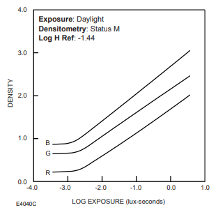

Thanks for the info, Koraks. The curves look interesting. The film has a definite shoulder, unlike Portra's straight-line curves. The red curve isn't parallel to the other two color curves, which is unusual for a color neg film. I've been shooting a lot of Portra 400 lately, but may buy a couple rolls of this to try.
