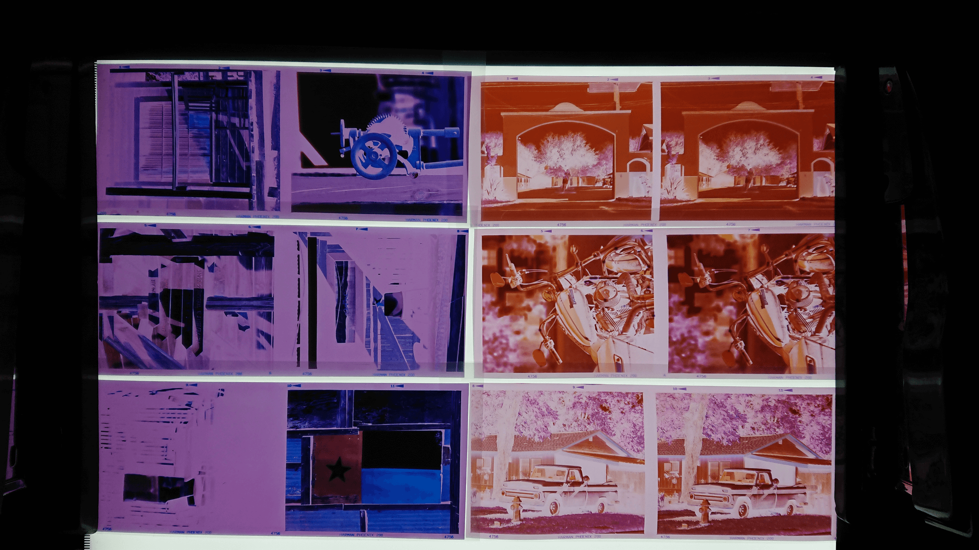

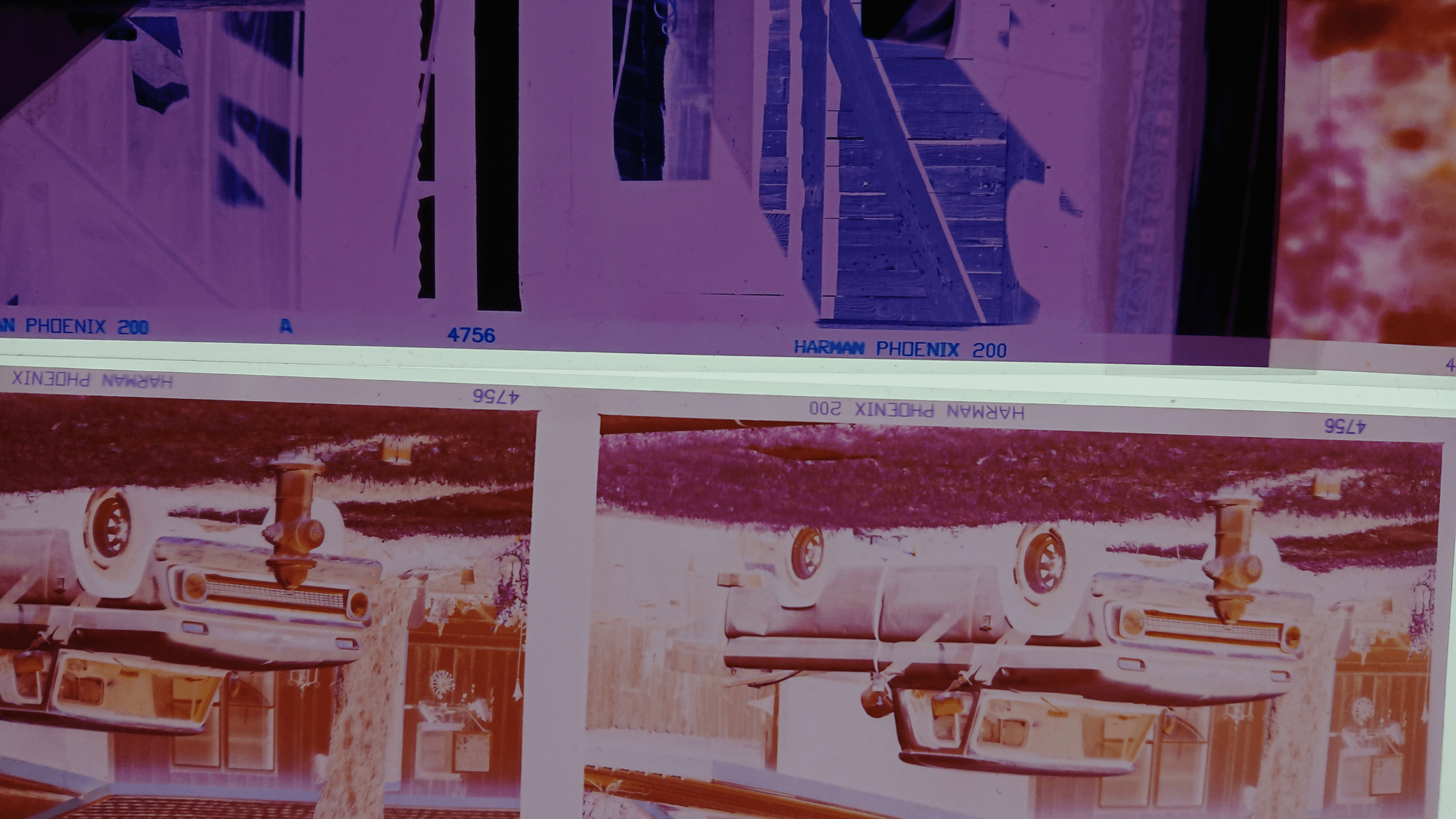

Comparison of standard C-41 at 125 (left) to my method at 25-50 (right):

Thanks; I can see how gamma is still high, but it seems significantly more muted than on the C41 processed film. I also see that in your process the base color is far less dense (btw, your C41-processed Phoenix base looks remarkably dense, but that's probably just due to the digital capture; the hue seems close or idential to what I get.)

I took some quick readings with a TR-927 densitometer (so these are just qualitative).
Standard C-41:
  • base density: 0.67
  • maximum sample density: 2.26 (probably much lower than reality?)
Chalkydri method:
  • base density: 0.34
  • maximum sample density: 1.79
These rolls are from the same batch. I hadn't planned to do more rigorous analysis because I didn't expect this method to work well enough to share.
