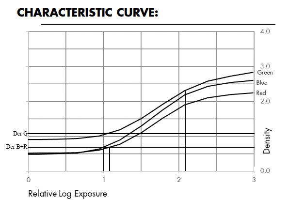

Can someone help me read the characteristic curve graph?
It looks like normal contrast to me, and this book seems to agree http://istoriya-foto.ru/books/item/f00/s00/z0000018/st023.shtml -
G ΔD 1.43 γ0.68
B ΔD 1.7 γ0.85
R ΔD 1.4 γ0,67
perfectly normal contrast compared to standard 0.65 for C41, except in B, but that's probably on my end
But then why in videos the highlights seem to get blown out easily even at ei 200 and in the datasheet there's a line about "highlight control"?

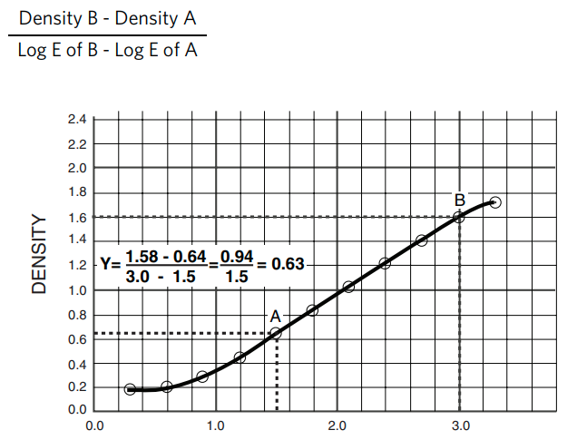

I don't have a degree in sensitometry either, so let's see if I can help with my hobby-level arithmetic and chart-divination.
From here: https://www.kodak.com/content/products-brochures/Film/Basic-Photographic-Sensitometry-Workbook.pdf
Applied to the chart from the Phoenix datasheet:

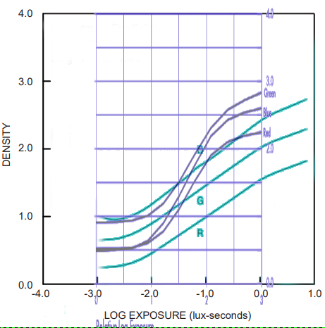

Green channel: for approx. Going from 1.1 to 2.2 is 1.1 unit of change on the X-axis, and that's associated with an increase in density of approx. 1.1 to 2.45 = delta 1.35 --> gamma = 1.23
Blue: same exposure range, density increase of 0.8 to 2.3 = gamma 1.36
Red: density goes from ca. 0.7 to 2.0 --> gamma = 1.18

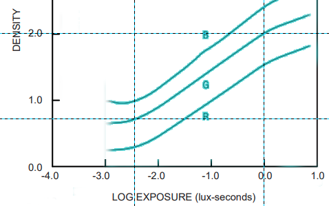

Let's do a reality check and compare the Phoenix curve (plot in blue) to let's say Gold 200 (plot in cyan) which is a similar-speed film.
I guess this makes the difference a little more tangible. Note not just the difference in gamma, but also the dmin in the different colors.
For the plot above, I had to make a call of how to overlay the horizontal axes, since both companies choose to plot relative log exposure (this makes the comparison possible), but choose different reference points (this makes it arbitrary how you overlay the x-axes of both plots, as long as they're scaled to the same units).
To verify, let's calculate the gamma for Gold 200's green channel over its straight-line region:
Exposure range = -2.4 to 0.0 (log) = 2.4
Density range = 0.8 to 2.0 = 1.2
dLogD / dLogE = 1.2/2.4 = 0.5
Blue is a little higher than green, red is similar to green.
The numbers shift around a bit depending on how you define the start and end points, which is something I'll probably get smacked over the head for in the next few posts. But this will hopefully clarify a few more things about assumptions/decisions that need to be made when calculating gamma.
However, I think this paper napkin exercise shows how Phoenix is really 'something else'.
What I find very unfortunate about that web page is that none of the illustrations show example numbers on the axes of the plots. This makes it impossible to verify if you've correctly understood the arithmetic that the authors explain (I assume they do; I didn't read/translate the text). In this sense, the Kodak manual I linked to is better, and I think if you combine both, you have a decent starting point to work from.
