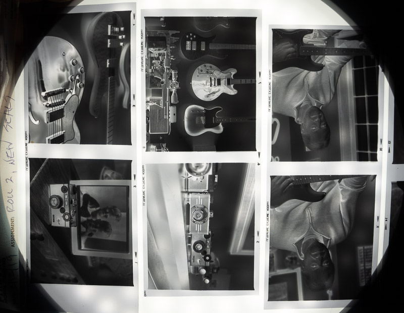

Here's a picture of a sheet of the negatives from this roll. Of course, the "scan" in this case is just a picture of the negative to begin with. Anyway, here's what they look like against a bright back light. Ignore the banding. It was caused by the led lights in the house.

To my mind, those negatives look to be extremely over-developed. They may also be over-exposed.
I'm reluctant to come to a definitive conclusion, because the process of photographing them for the purpose of this thread can add some of the same distortions as scanning them for other purposes.
Here is a link to a website article about assessing negatives. While the illustrations in it aren't perfect, they give a reasonably good indication of what good negatives look like: https://www.ephotozine.com/article/assessing-negatives-4682
It may be that the OP's negatives look better in real life.
EDIT: I realize I should probably take some photos of negatives that print and/or scan well, for use in threads like this.

I am an all-digital person so I looked at first strictly from the point of view of scanning or reproduction. I thought some more about whether the OP needs to adjust the film exposure and/or development. FWIW considering last film I shot or developed or printed was eons ago, I think based on the histogram I would surmise that the film is exposed/developed fine. If it was either overexposed/developed or underexpose/develop, then it would show up in the histograms. In the former case, for example, the unedited inverted histogram should abruptly end at some value on the right side (clipped highlights.) Similarly for under- case on the left side of the histogram (blocked shadows.) Neither seems to be true in OP's case.
:Niranjan.
Addendum: I went back and checked some of the individual frames from the picture posted in #18. They all have "toes" in the highlight areas.

If the negatives are over-developed and I reduce development time, would that not just move the entire range of tones to the left on the histogram? Or does development effect one end of the tonal range more than the other, thus changing the spread of tones and increasing contrast?
Looking at the article quoted above, my negatives look to me to be over-exposed and about correct in development. I've been overexposing a stop intentionally. I'm accustomed to the digital approach where you want to "expose to the right" to maximize highlights, as long as you don't clip. Maybe that doesn't work with film.
I followed development times in the massive dev chart; 12 minutes in 1 + 1 dilution of Xtol. Don't know how reliable they are. I've seen others say that they use more diluted Xtol and shorter development times, but it was with different film.
