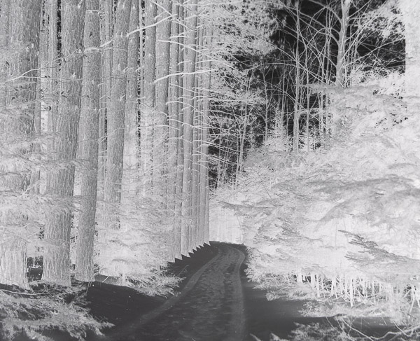

If the negatives are over-developed and I reduce development time, would that not just move the entire range of tones to the left on the histogram? Or does development effect one end of the tonal range more than the other, thus changing the spread of tones and increasing contrast?
Changing development time affects the highlights much more than the shadows. You usually adjust development in order to adjust contrast.
Changing exposure affects the shadows more than the highlights. You usually adjust exposure in order to adjust shadow detail.
Generally speaking, the best negatives don't appear "strong", they appear "subtle".
The negatives that you photographed and shared here look to me to have highlights that are much more dense than would generally lead to easy optical printing or simple and accurate digitization.
Normal films are able to record an extremely wide range of tones. Where you run into a limiting factor is when you attempt to convert that that range into a result that is usable in the later steps in the process - either printing it optically on to photographic paper, or scanning/photographing the negative digitally, for subsequent digital presentation.
A histogram is as much a measure of the scanner or digital camera's response to a negative as it is to the negative itself.
The scientific, purely objective way to evaluate a negative involves a calibrated light source and a densitometer. That equipment is totally different from what you are using, in that there is no firmware, no programming, no automatic adjustments, no algorithms and no attempts to "normalize" the result.

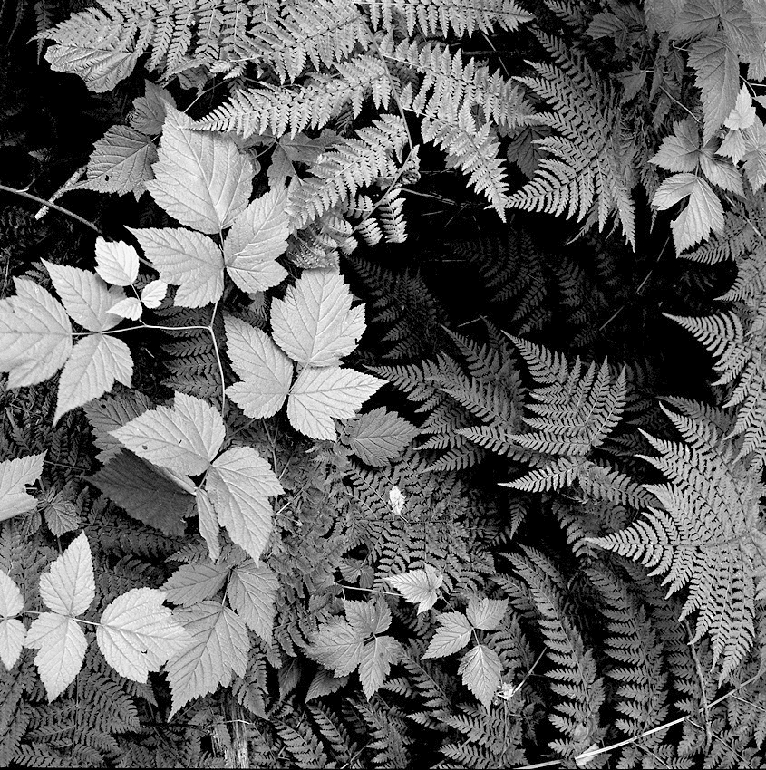

I've posted the image above number of times, but I'll post it again as an illustration. The negative that it corresponds to is almost ghostly, it is so subtle. As such, it scans wonderfully, and prints very nicely as well.

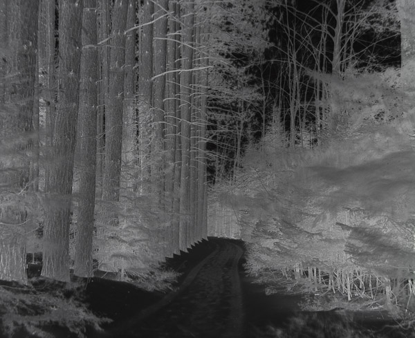

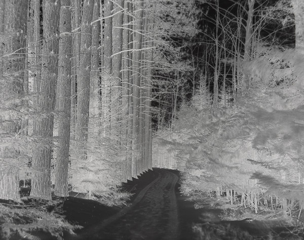

Matt, once again a thoughtful, and helpful post. My goal for output at this point is partly online posting, and preferably digital printing at relatively small scales. I used to do big digital prints for sale in a gallery that represented me, but I'm no longer doing that, so these will mostly be for personal enjoyment. Though you never know whether I might try to sell them at some future time. I enjoy putting my work into book form and printing through Blurb. That's an option too, but again mostly for my own and a few friend's enjoyment.
Today I did more testing. I shot a roll (ten exposures), bracketing a couple of shots minus one stop, correct exposure, and one stop over, which is where I had been exposing. I also reduced my development time from 12 minutes to just over 10 minutes. The results are perhaps better, but not wildly different than before. The exception is that the underexposed negatives are definitely thinner than before. So here are three sample negatives.
To my eye, the underexposed negative looks best, offering deeper shadows and more contrast. However, when I adjusted the images in Lightroom, I found that the correctly exposed image yielded what I consider the best looking image. That is a matter of preference, but clearly the under and normal exposure images work best. The overexposed image required a lot of heavy darkening to look usable. Here they are in order of exposure, from under to over.
The underexposed negative had the widest spread of values, reasonably centered in the histogram. The normal and overexposed negatives pushed further and further to the highlights and got narrower with more exposure. It seems clear to me that overexposing doesn't work at all. In the underexposed negative, the shadows are pretty good. They are well to the right on the histogram, without clipping. There is room for more density in the highlights, which could mean I went to far in reducing development time.
But I feel like the correctly exposed negative yielded the best looking print (on screen at least). There is more contrast and more punch in the mid-tones. The fact that I had to drag the shadows far to the left on the histogram actually seems to have yielded a better look than a negative with a wider spread of values to begin with. Interesting, but a bit confusing to me.

With respect to your test itself, it seems to me that you have picked a subject that creates some difficulties. Your subject ranges from bright sky to shaded areas under trees, as well as snow in the foreground. The information you glean from these tests may very well be more applicable to subjects like this than to more general subjects.
With respect to the negatives, and subject to my concerns about the reliability of how things are displaying on my monitor, my initial reaction is that the first negative appears properly exposed, the second negative appears to exhibit overly generous exposure which can probably be easily dealt with at the "printing" stage and the third negative appears to exhibit too much exposure, which may very well lead to impaired highlight rendition.
The contrast of the first two negatives looks good. The increased exposure of the third negative makes it harder to evaluate the contrast of that negative.
The positive images that you display do show the problems that you reference, but I believe that if the negative images are accurate representations of the film negatives themselves, then the positive problems arise from the digitization parts of your process and/or your post-processing steps after that.
