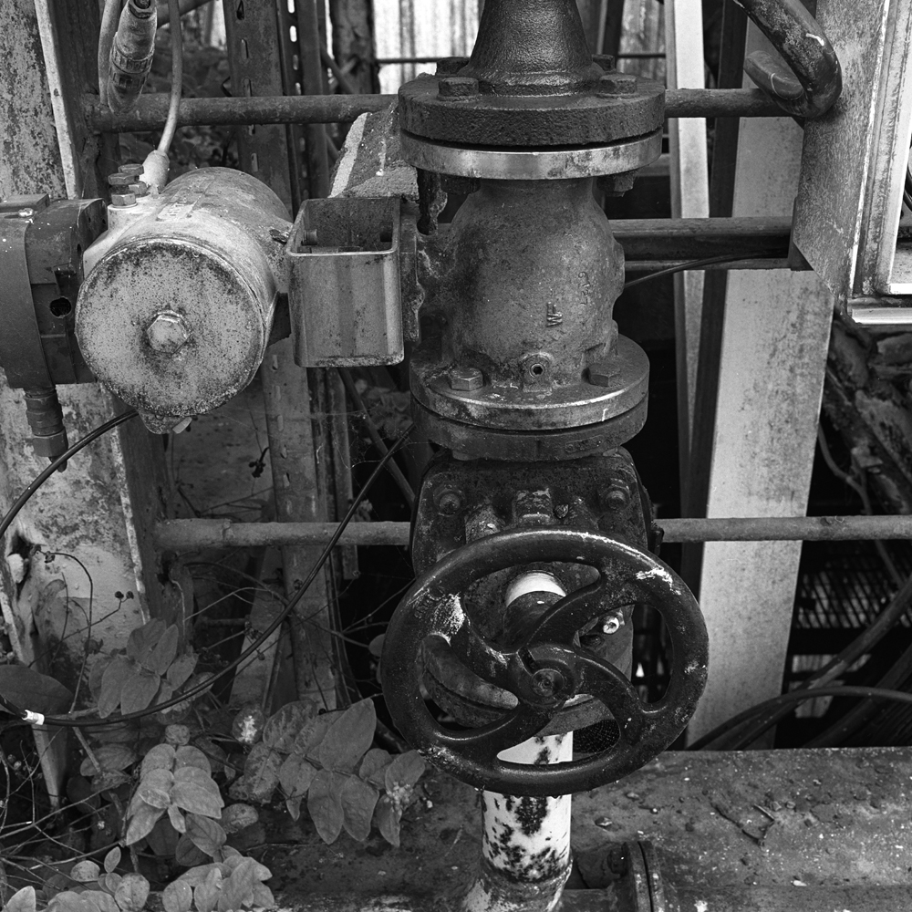

This is my 55mm at f/16, TMAX400, tripod and paramender.
