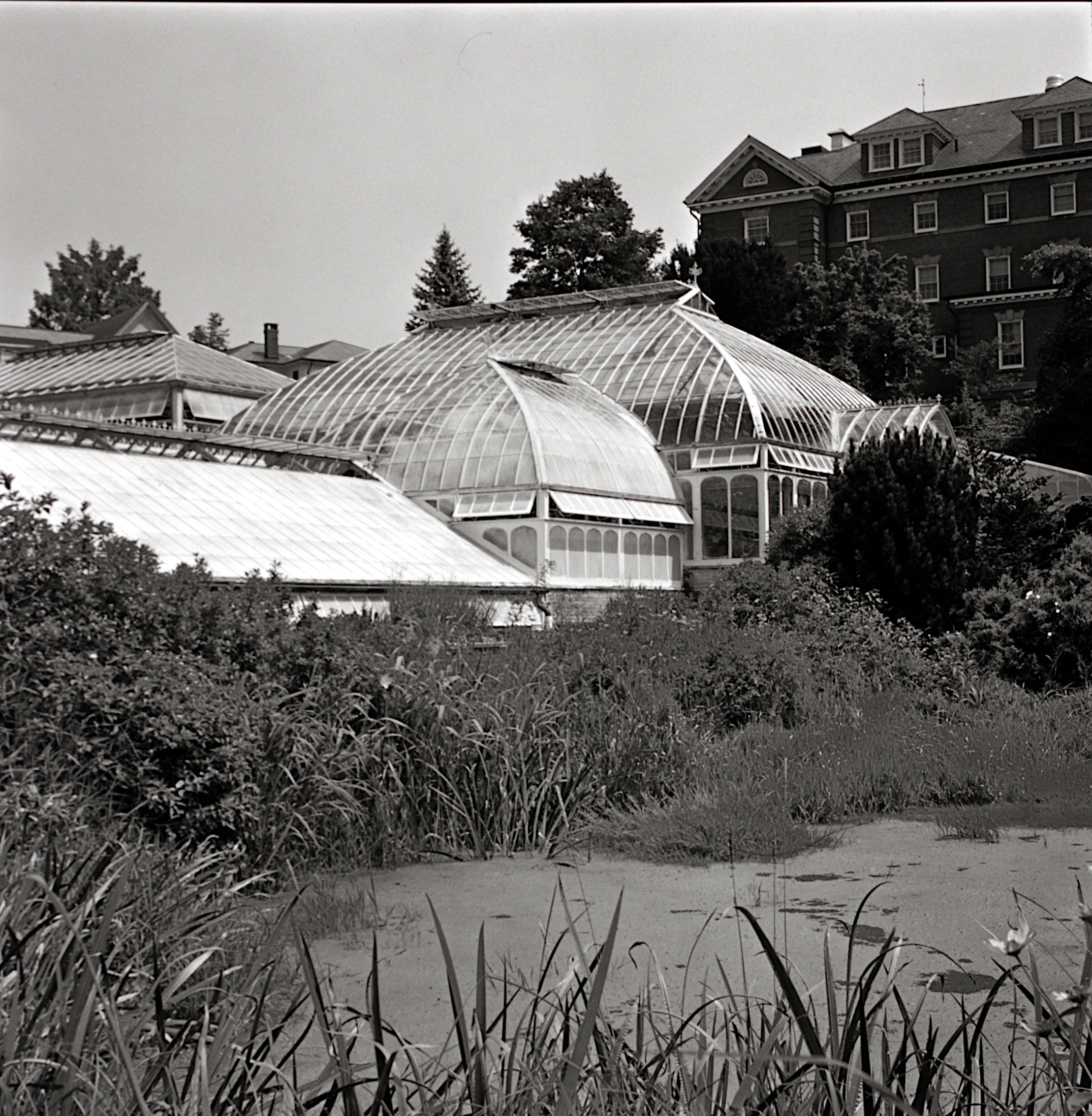

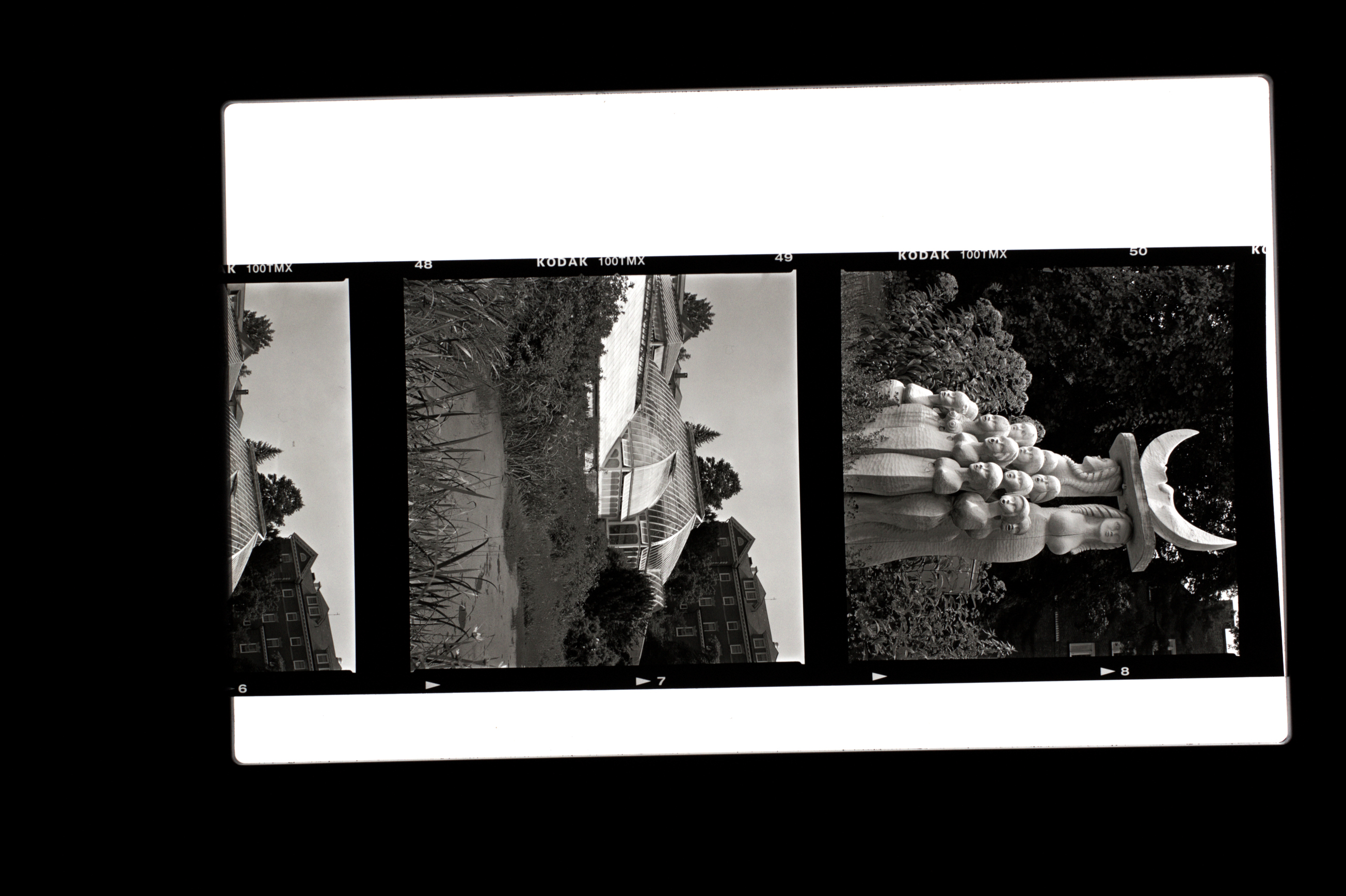

I just finished cleaning up. Negatives are hanging to dry and they look very much neutral!! Best to wait until they dry and view them under daylight to make sure. They do look a lot better. There is a little bit of sparkle to these that the other three rolls didn't have when using the dichromate.
Exposures look to be spot-on. Shadows have nice detail in them. Box speed still seems to be the winner here.

The T5 grabs are exaggerating things. The T5 is recording the image as sort of an olive tone but the strips look very neutral. I think a film scanner would do a much better job at this. I just have to fiddle with things to get them to what my eye is seeing things.
Hasselblad 501C with 80mm lens, T-Max 100 at box speed. PQ Universal reversal.
