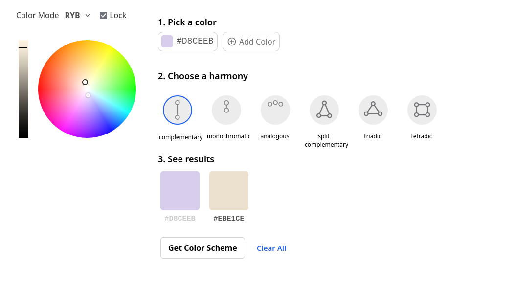

With that in mind: Out of curiosity I went to a site that has a color wheel and I came across something that is making me think. I put in a color that is close to what the dye would look like on T-Max film and then clicked for the compliment color and got pretty darn close to the very same tint that my reversal processed film resembles: Brownish! I was of the thought that the bleach or the clearing bath would be able to take out that dye but from what I just saw from the color example I don't know. I don't know if there is any correlation between the dye and my own results. Is the dye removed, is it being masked, is the bleaching or something else taking the place of where the dye was or am I thinking way out to planet Jupiter?
Maybe there is something to this? Maybe this is the nature of using this combination of development process and type of film or something could be off with my routine. I have thought about bleach issues, washing enough in between the bleach and clearing, am I clearing long enough, is the second development long enough. I read that dichromate tans things such as wood. Does the same apply for films?

Update: I know this is black and white film and complimentary colors technically wouldn't apply. I'm just throwing possibilities out there. It is surprising to me seeing the color examples of the purple and the brownish tint.

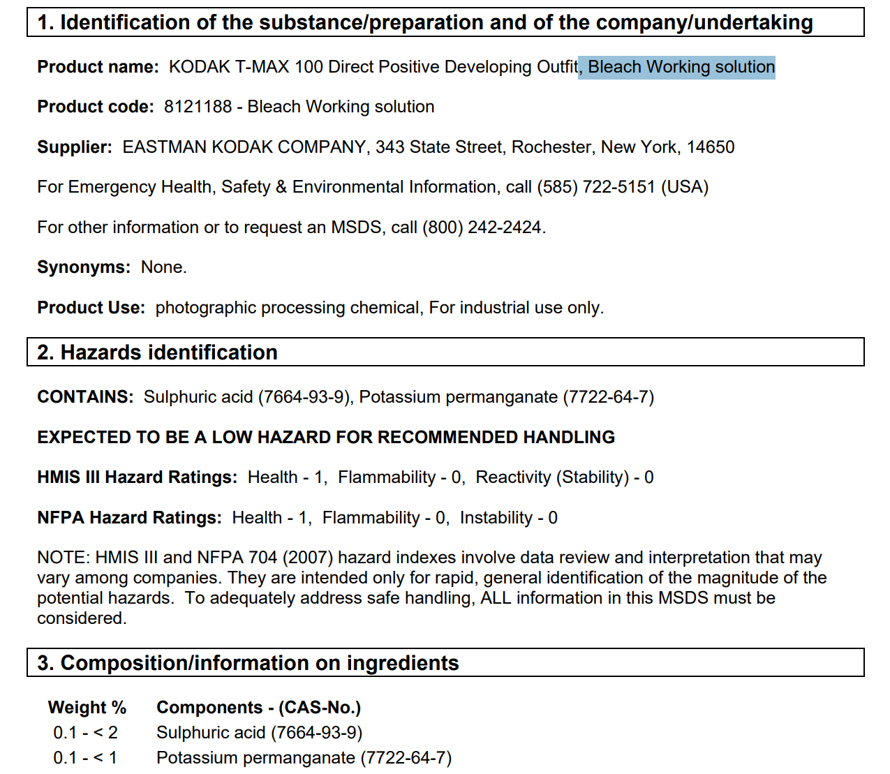

Looking at MSDS of KODAK T-MAX 100 Direct Positive Film Developing Outfit, the bleach that came with the kit is Permanganate based. So, it might work well to get rid of the tint, who knows.
According to MSDS, the weight % of Potassium Permanganate in the bleach working solution is 0.1 - < 1. So this gives some idea of what strength bleach would be ideal.
Thanks for the MSDS sheet. Kodak shows more information than Ilford for this type of process. Ilford not having its own kit probably being the reason.
