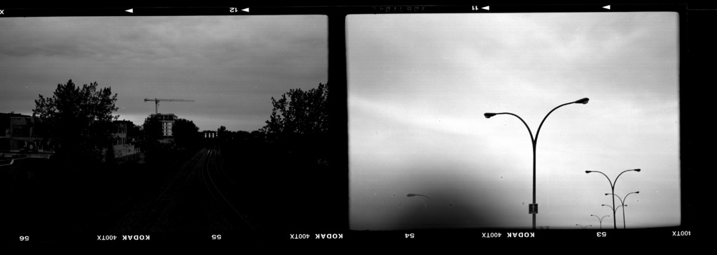

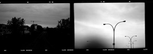

First the Kodak 120 negative numbers are for 6x6 (I think) and this roll was shot 6x9 AND I advanced a bit too far from going frame 2 --> 3 (argh), so I decided to skip a 645 frame and use the second window from then on (luckily the last frame fit with some excess for handling).
This is a scan from last two frames:
attachment.php
trying to match the backing paper with the camera red window and the negative I am guessing that in this case the numbers were transmitted through the rear. However, I can't say for sure due to the 645 frame offset plus it's at the end of the roll so one winding is maybe 35-40mm so it could just be the other case.
If the numbers were printing to the film through transmission through the paper from through the back (as from a red window), then the numbers would be in the finished image upside down compared to how they appear through the red window, but not flipped...imagine a view camera.
The same would be the case if they transferred to the film from the front of the film (as from contact between the emulsion side and the backing paper).
In neither case would the numerals appear "backwards".
It should be easy to determine if the numbers are transmitted from the back or the front : if the ghost number visible is the same frame number as the exposure, it was transmitted through from the rear.
He he, not as easy as I thought!
attachment.php
The backing paper should have numbers for 12 and 8 exposures if you don't get both sets of numbers it is probable not ink transfer, unless your camera has a light leak into the film rear which could print both sets.
Eg rotten foam with non red window camera.
Ink transfer will be offset from normal frame position, with an offset which varies along the film, light leak will be exact to frame position(edit in a red window camera).
You align the uncut film with backing paper?
You are supposed to go slow when the little dots are visible!
400 ISO is exposed (ie risky) with red windows designed for 100 ISO or slower.
