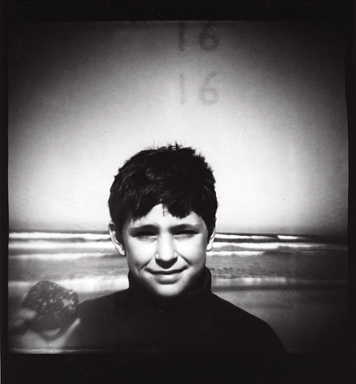

I have no idea why...
But out-dated Kodak film (I believe it was Tech Pan) in a Diana Camera.

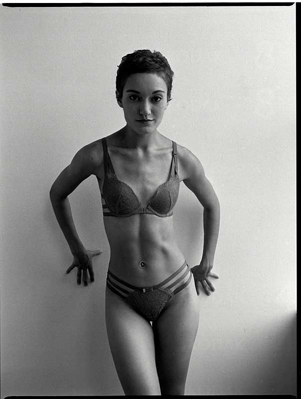

All good suggestions. In my case, film was loaded and unloaded indoors in subdued light. The camera is a Bronica ETRSi that has no (similar to at least one other affected party) red window.
Film was bought recently from B&H, assumed to be fresh, and has never been refrigerated by me.
Multiple affected frames; here is one, where you can see "Kodak" and "8" in the upper third of the negative, and "4" in the lower third, along the right edge:

I have no idea why...But out-dated Kodak film (I believe it was Tech Pan) in a Diana Camera.
Well, maybe an idea...mine could have been exposure thru the red window (photographing along the Oregon coast in actual sun!). Which could explain the darker numbers, rather than lighter, and why there are two '16s' as I rolled the film forward.
Alex was 13 yrs old -- too bad the numbers did not match! That would have been cool! The print is 8x8 inches on glossy VC paper. Just a quick straight print to see what the negative looked like.
In this case, in the original post the OP described a Fuji GF670 with no red window and supplied an image that appears a beautifully even exposure other than for the numbers. I would posit that rules out the first two items. But for sure we need to keep good procedures in mind. I have minimized refrigerated storage as I think it invites as many problems as it may solve (for me -- I don't maintain large stocks).
