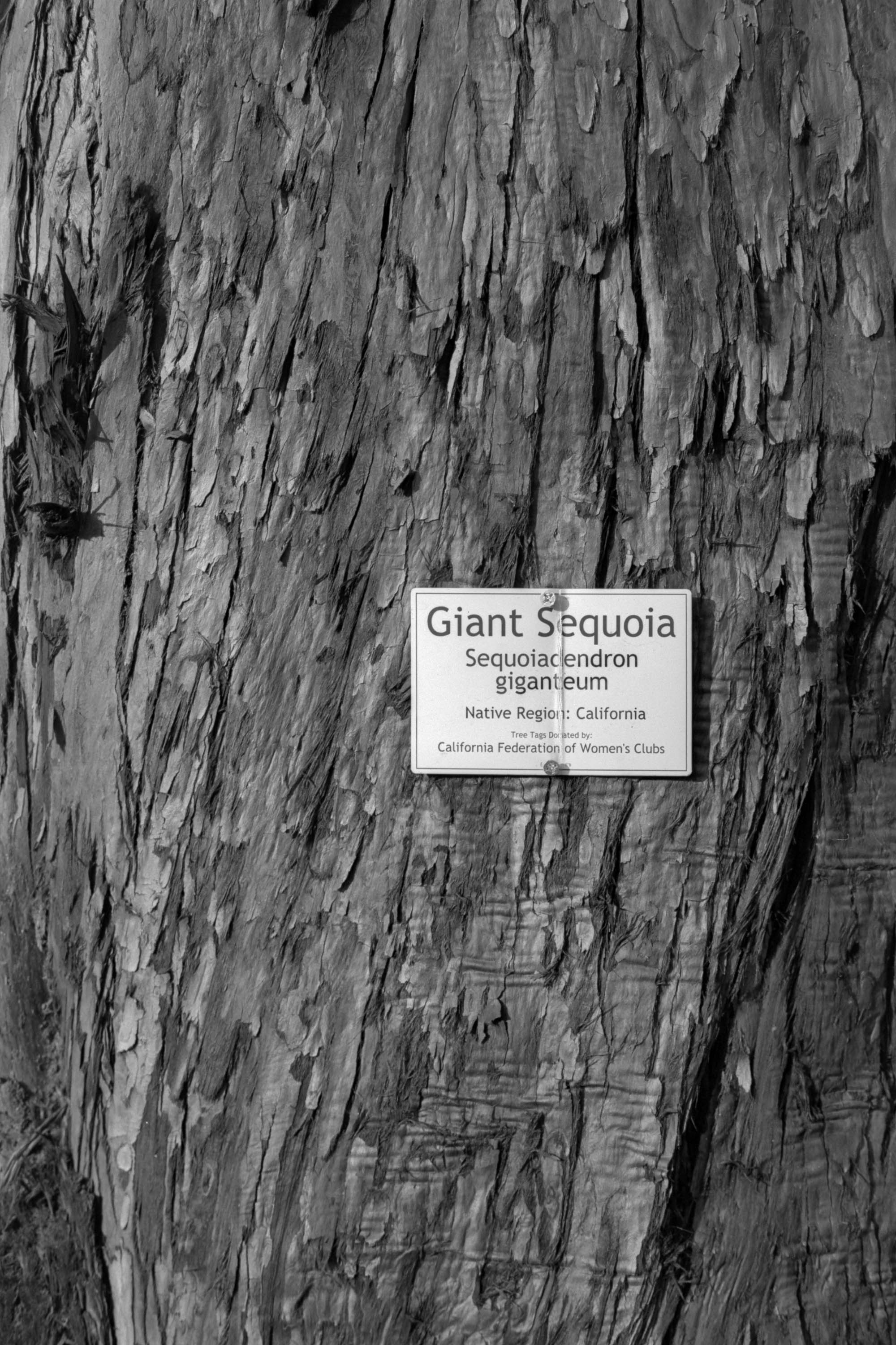

Here are the results form the Adox Rodinal Semi-Stand technique.
1:100, 68F, 1 minute initial agitation followed by an inversion at 15, 30 and 45 minutes. Water stop bath, TF-4 fix 5 minutes. I sat the tank in a bowl of 68F water as it is winter and my house is cold. The final temp after 1 hour was 67F, so there was not much of a drop.
The workflow: I let these dry in a cabinet overnight, scan them on a Pakon F135 to raw/planar, convert using colorperfect, no other modifications.
Some of these images are similar to my TMAX roll. I returned to Capitol park at the same time, same lighting conditions and camera (Nikon F6/Nikkor 85mm f/2).
The rest are here on flickr: https://www.flickr.com/photos/thekurgan/albums/72157667363512069

She is my Cookie Monster. I took all of these shots with the Nikon F6 and Nikkor's 85mm f/2 lens. Spot metering was used for all images and the zone system was adhered too.
Wow, folks see these posts fast!

I'm glad people like the images. They are as flat as can be when scanned as raw. I will admit I was skeptical for fear of speed loss using Rodinal highly diluted, but the 15m inversion helped it seems. There is quite a contrast from TMAX's milky grays, as opposed to the classic Rodinal grays. I like both and will be printing some perhaps this weekend. I exclusively use colorperfect's inversion software as it has the nearest approximation of a real print.
