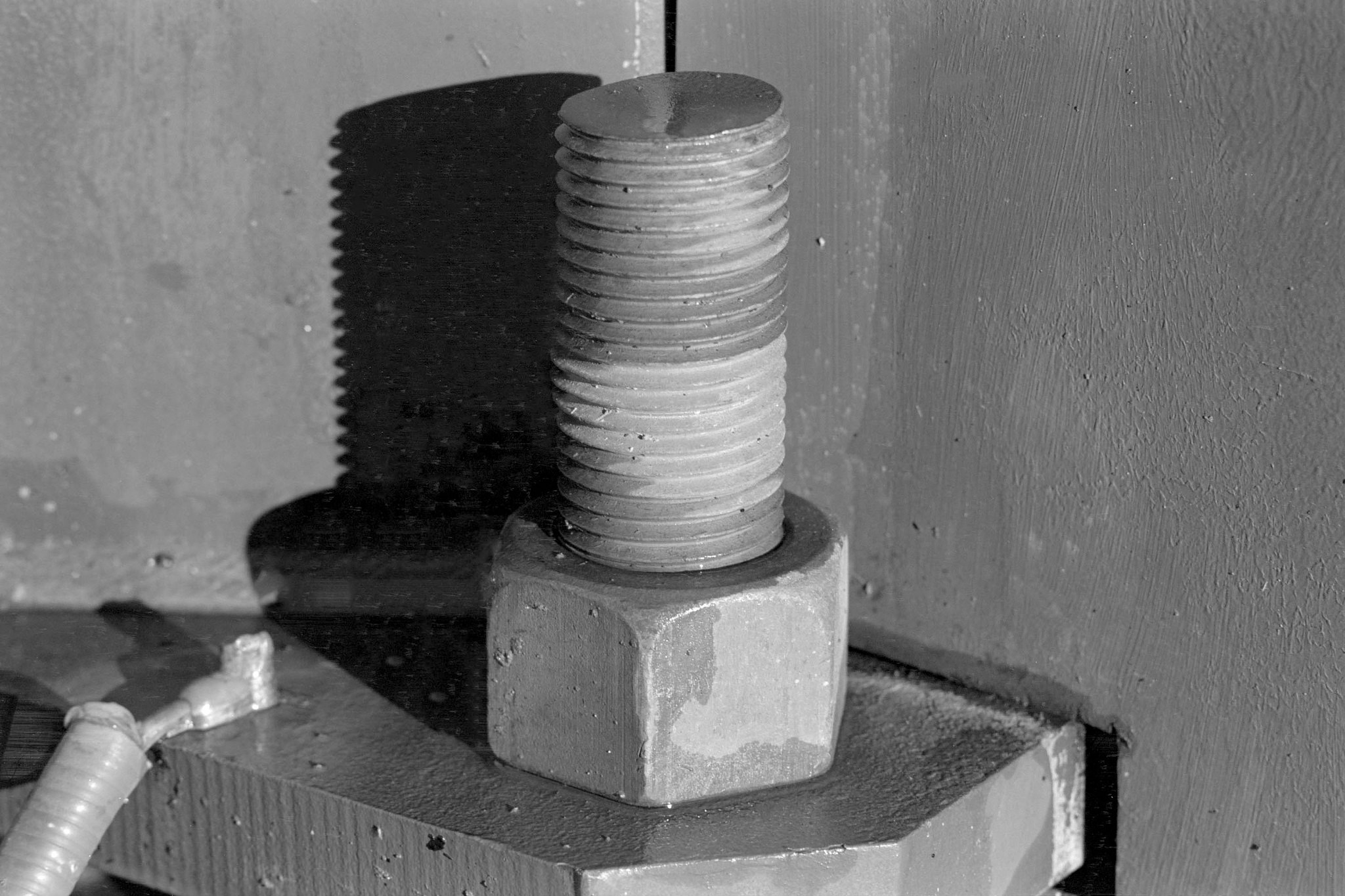

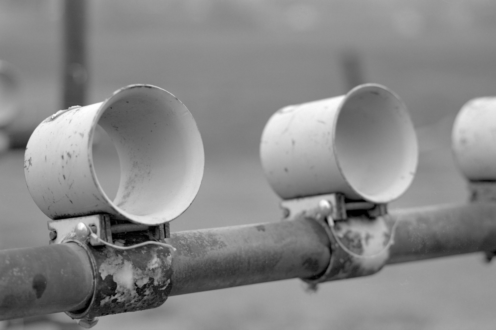

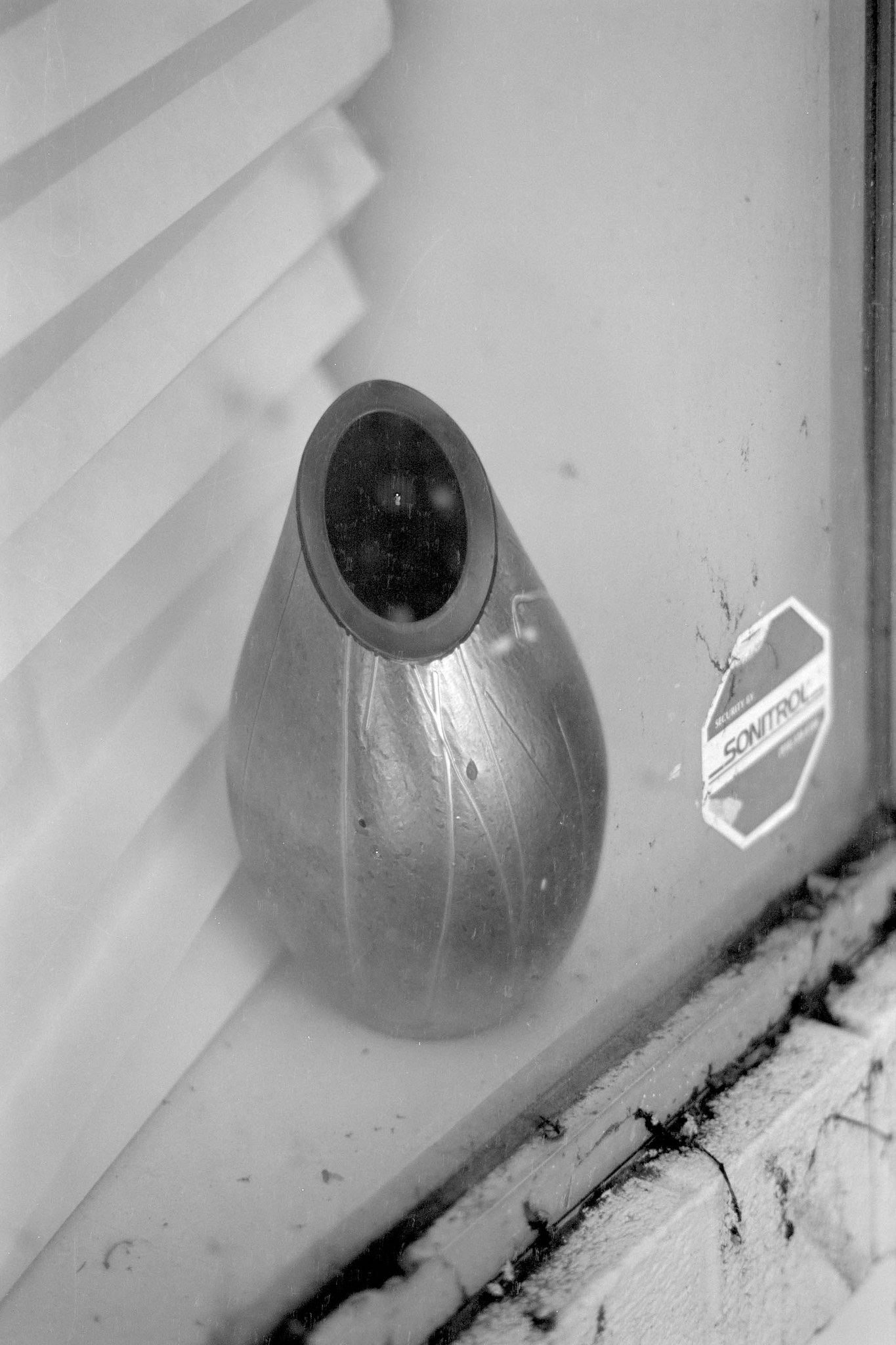

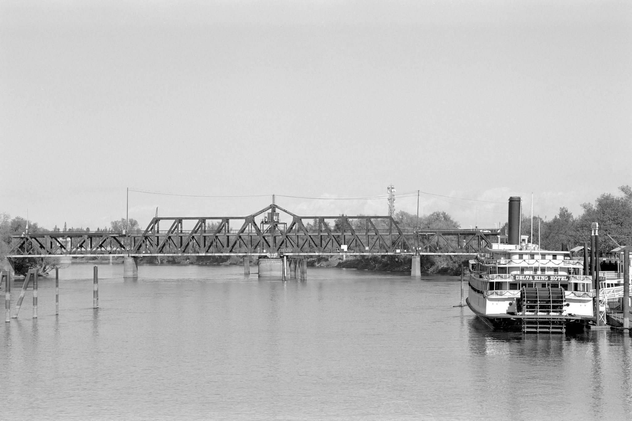

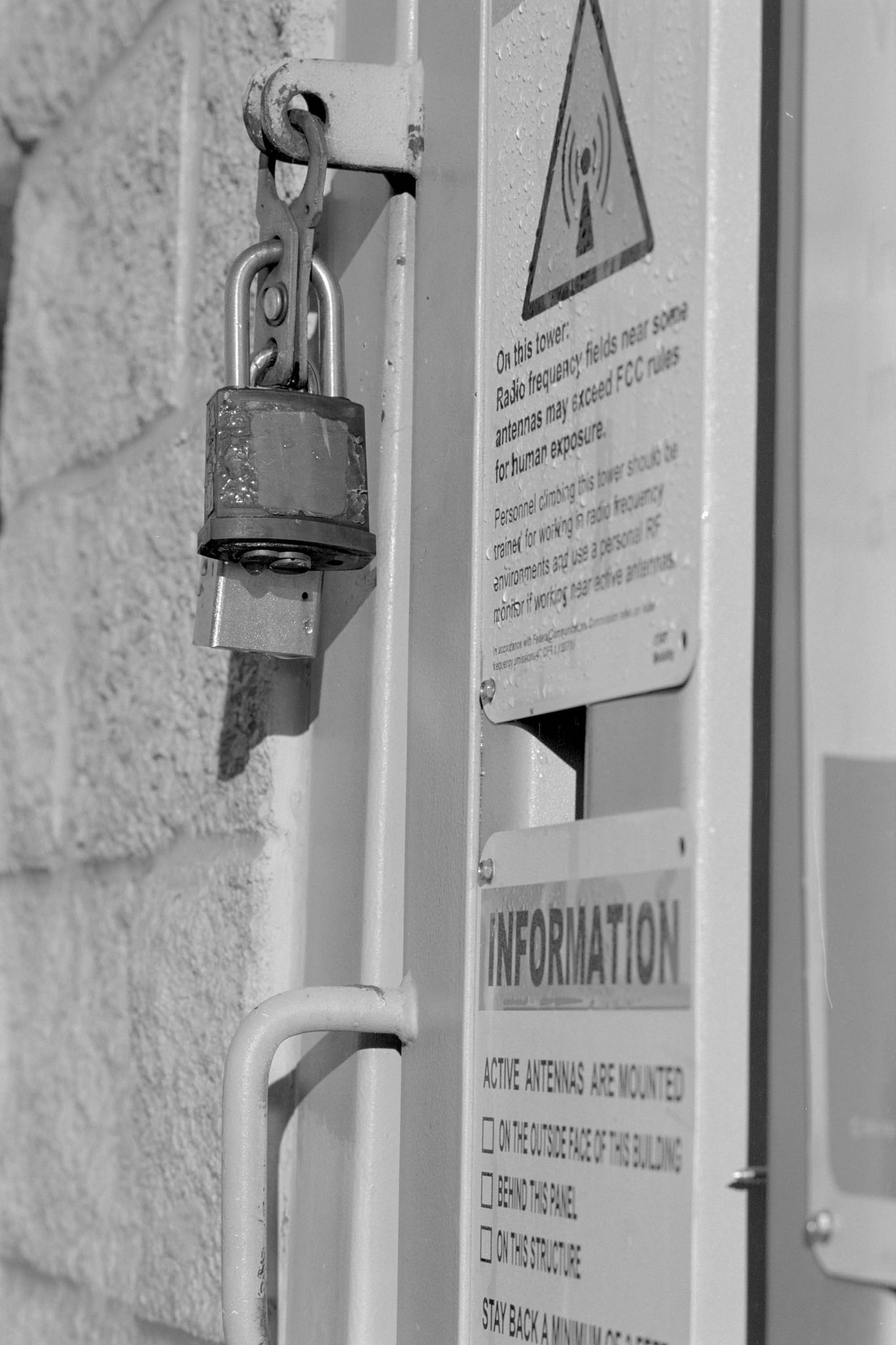

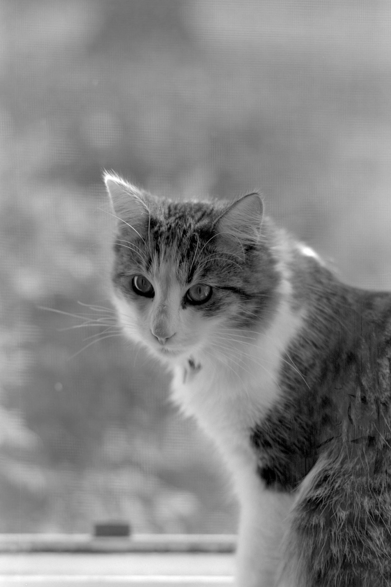

Nikon F6/Nikkor 85mm f/2, 80ASA, Developed in Kodak TMAX Developer, 1:6 @ 24C for 7 minutes. Kodak TMAX agitation: 5-7 rapid inversions initial 30s and 5-7 each 30s. Water stop bath, TF-4 fix for 5 minutes, Ilford wash method, photo flo and cabinet dry. Scanned via Pakon F135 to raw, inverted using colorperfect, no other modifications.
I like the cat one but can't help but observe that one of the pupils( right one from the cat's perspective) is much bigger than the left one but both seem to be subject to the same amount of light falling on them. Is this a peculiarity of the cat's eyes?
Not relevant to the thread I know but I am curious.
Thanks
pentaxuser
Thanks
pentaxuser
I belive it is just the shading, they appear the same to me, but he rarely sits still long enough to get a thorough examination. :smile:
