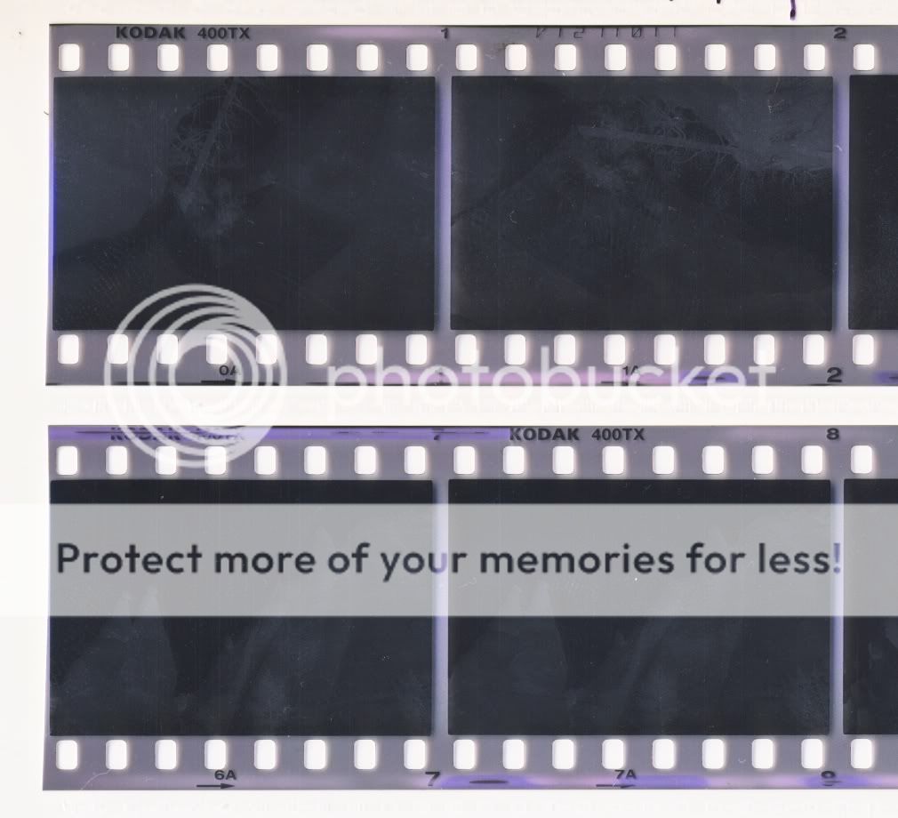

As you can see, the film edges are far more developed than the center. It is more obvious when there is something light enough to be blown out by the difference at the edge, but it is always there. I have fiddled with nearly every variable I can think of (ceteris paribus, of course) but my negs always display this result. The only time they do not is when a lab does my processing. I have tried replacing my camera's light seals (needed to be done anyway) with no improvement, and the bands show up in both prints and scans (even when completely flattened, as my film is often curled), so I am led to believe it is a development issue.
I have tried different chemicals; first new dilutions, then completely different brands. I have tried different tanks (both SS), thinking my single-roll tank could have caused the problem, as well as different reels. I have tried filling the tank part-way (so the film leaves the chemicals when inverted) and to-the-brim with developer. I have used different methods of agitation; inversion (with all sorts of agitation schedules and movements save stand development), figure-8, and plain 'ol shaking. Changing film makes no difference, though I have been limited to 35mm. I have tried changing the temperature of my chemicals, if that is relevant. I have even developed film in different climates. None of these changes has yielded any improvement in my negatives. :mad:
I am completely dumbfounded, so any solutions/ideas/musings would be greatly appreciated. I have some important rolls to be developed and I would like to avoid using the lab if possible. :smile:

Is your film format 35mm? Looks like edge surge - over development as you suspect. Usually caused by inadequate, or too vigorous, agitation.
I had this with 35mm years ago from too vigorous an agitation technique, which seems to cause a "drag" from the edges, but usually you can see the sprocket hole pattern in the overdeveloped areas. A more gentle inverted swirl motion solved it for me.
With 120 film, I seem to need more vigorous agitation to make sure the middle portions of the frame receive the same chemical exchange as the edges, but only with some developers.

First of all, if anything the negatives are far more developed at the edges (the edges of the negative must be darker to produce the lighter positive). It really looks like light leaks but that would be evident in the film beyond the image area.
As suggested above, a post of the entire film width would be helpful.

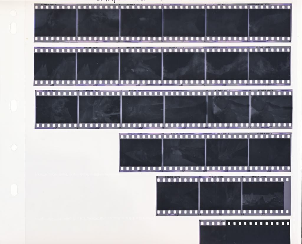

Here is a whole film (not the one with the above photo, but this roll has the same problem). The digital camera method wasn't working so well so I just scanned it on platen mode. There seems to be a bit of ghosting, but hopefully it is still helpful.
Zoomed in on the top-left:

I think I detect surge marks coming from the sprocket area of your enlarged contact. I may be wrong.
And even over-development along film edges is, very often, from rotary processors. If you are "rolling" your tank as well as inverting it, that might be the cause.
With SS tank and reels, inversion should be so gentle that the movement of the reels in the tank should make a "click" sound about half the volume of the gentle opening of a snap-open beverage can. Any louder and one is agitating with too much vigor, in my experience.
And if you are souping fewer rolls than the max the tank can hold, be sure to place an empty reel(s) in the tank to keep the reel with the film loaded in it from sloshing back and forth, which leads to over agitation.

I just shot/developed a test roll today. I tried a number of the suggestions posted in this thread, so hopefully this comes out well. If not... must be voodoo. :D I'll post more details and the results when the negs are done drying.
Scruff McGruff
Dec 4, 2008
56
SF Bay Area
Success! Well, some anyway. The film edges are still ever-so-slightly overdeveloped, but nothing like before. It isn't even noticeable on some frames.
If I were smart I would have done some portrait-orientation shots with the sky in them, but I think this one does a good job of showing how edge highlights aren't completely blown out. Yes, it's a little underdeveloped (stupid math error on my part, I got the time wrong), but probably not enough to invalidate the test.
I gave my reels a good scrub-down with hot water and a toothbrush, I loaded my reel tightly, left a bit of airspace in the tank, and I increased my agitation (thinking I just wasn't getting any fresh developer to most of the film). Ideally I should have done a few test rolls changing one thing at a time so I could single-out the problem, but patience isn't one of my virtues! I'll keep experimenting, especially with agitation, but I've at least made some progress thanks to all your help.

Ugh.
I was excited and hopeful until I developed the next roll which turned out to be a complete disaster. I did notice something that I hadn't before though:
Can anyone explain why there is a gap in the overdeveloped edges? The only explanation I can come up with is that the reel is affecting development somehow despite the good scrub-down I gave it. This is incredibly frustrating, enough to make me consider throwing in the towel. It's just not worth it if I can't produce a decent negative.
