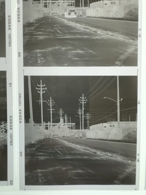

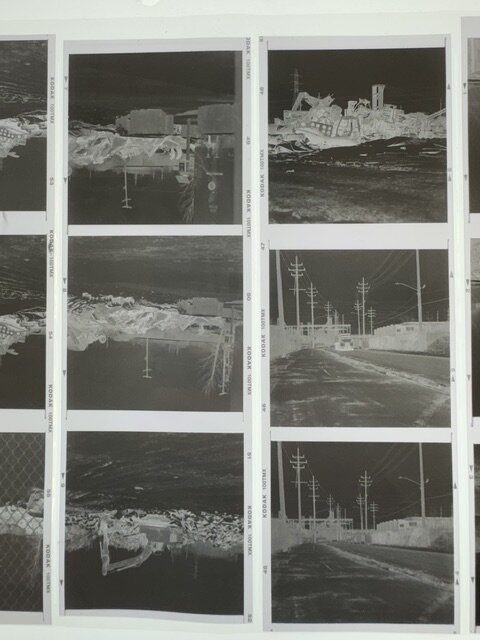

I've developed a few rolls of TriX 400 on a Mamiya c330 pro, and the negatives have been fine aside from excessive linear silver density at the sides of most frames. These linear densities extend beyond the bounds of the frame. The negatives themselves are fine otherwise with no fogging or dents. The printed images are lighter on edges where these densities are. See attached images.
I'm developing in Rodinol 1:50 at 20degC for 9minutes with typical agitation for first 30s then 10s/minute thereafter. citric acid stop, ilford rapid fix. I'm using a Nikor stainless steel tank and reels with 15 oz (450mL) developer as per instructions. This leaves adequate headroom. I do not think these are edge effects, though I could be wrong. They almost look like light reflections from the silver-colored film guides inside the camera. Any ideas are much appreciated. Thanks!

Honestly, I am having trouble seeing the problem with your example negatives. But when you say, "excessive linear silver density at the sides of most frames" it sounds a lot like a problem I was having with developing my 120 negatives. Certainly, I was also having the problem of, "...printed images are lighter on edges where these densities are."
Would you say what you are seeing is similar to what I described in this thread?
(scroll down to posts #25-26-27 for better examples of what I was seeing)
It is similar. My development method is as standard as I can make it. It's possible that changing agitation vigor will change things...

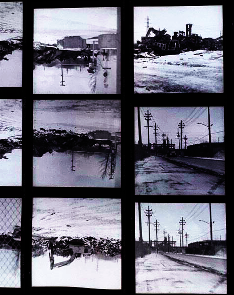

After inverting it and enhancing the contrast, it is easier to see a line where the density changes noticeably along with what looks like a couple of circular areas of differing density. This does not look like a processing defect, but some odd kind of mechanical exposure issue. But first - is the film within the expiration date and did it go through any odd storage or handling situation before or after you used it? Has any film you shot with this camera come out completely normal?
A reflection from the silver-colored film guides inside the camera would require some errant light rays inside the camera body, so generally I would check out the camera's light seals, lens mount and film back for any small light leaks.

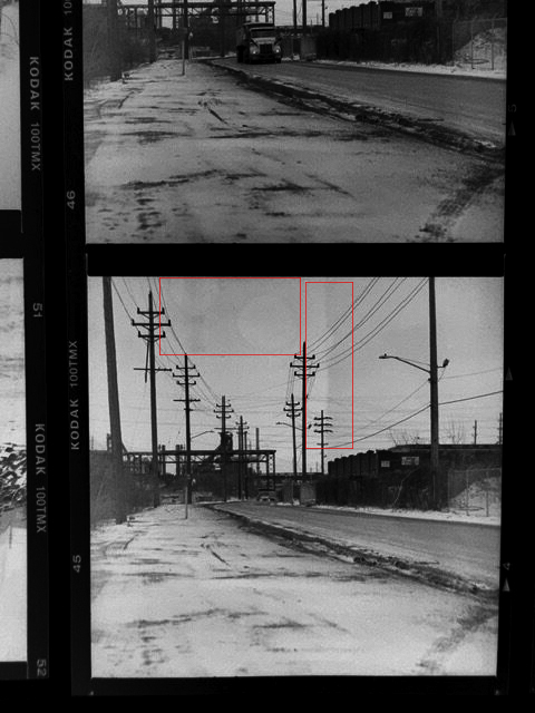

The artifacts in red are likely a reflection of my iphone as I photographed the negatives in sleeves on a light table. The film is not expired, and I kept it light safe. All of the rolls on this body have had these linear densities on side of frames parallel to long axis of film (as opposed to between frames).

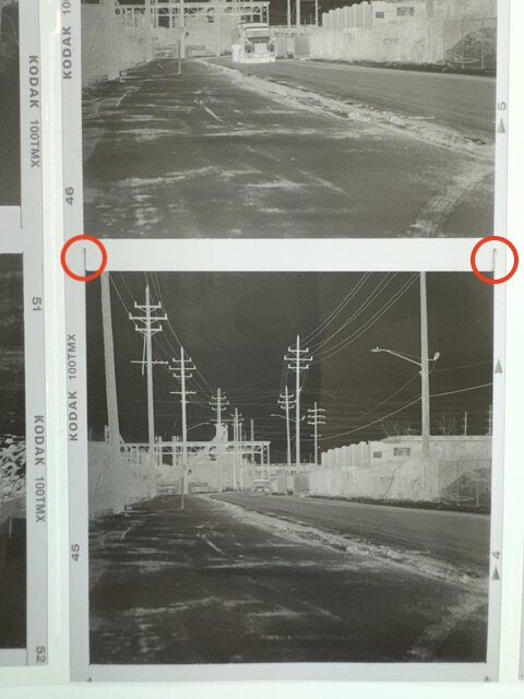

Okay, now we're on the same page.
So the problem is not that you have a band of added density within the image frame, along the edge.
The problem is the thin line extending from the corners of the image frame.
You may be able to find the culprit by inspecting the back and see where the light seeps past the frame gate. Maybe it's possible to fill that gap somehow. But personally I'd just consider this to be a 'feature', not a bug.
Now I am really confused.
@instantcrow, are you talking about only the thin line circled in red?
What! Is that all we are talking about! Well spotted.

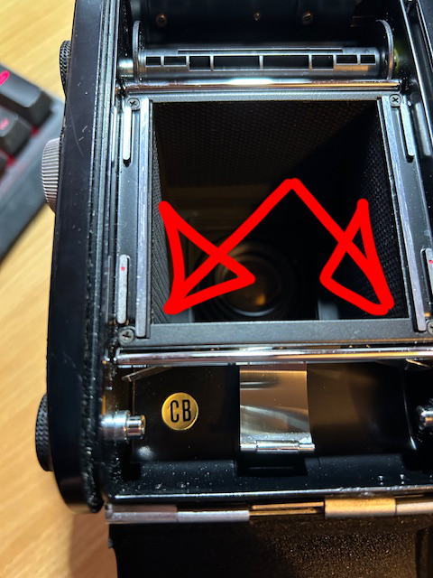

The way the Mamiya is constructed it leaves a small gap each side of the film gate, shown here, and easily seen if looking for a culprit especially given the image is projected upside down onto the film. You can fit a fingernail into the gap.
It is so much easier to have these sorts of discussions in real life.
I've seen those little lines between frames on C330 negatives for almost 50 years, so I just assumed that that @instantcrow couldn't have been referring to them!
