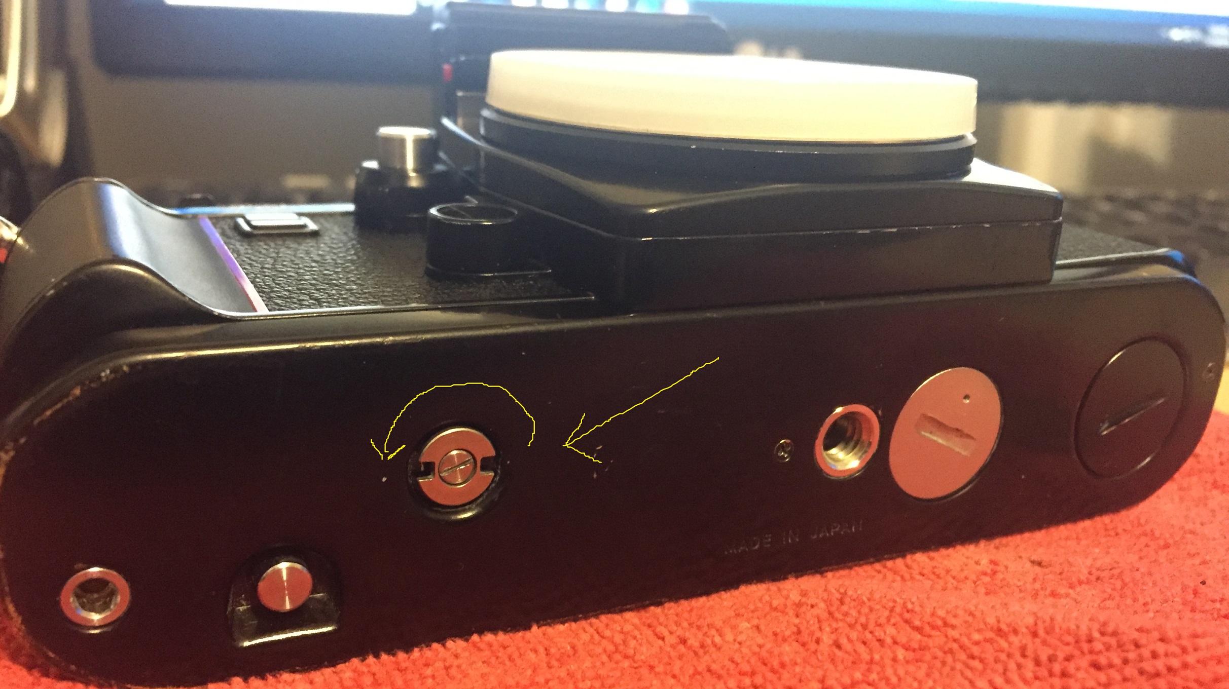

View attachment 234620 You could try charging the shutter via the motor drive connector to see if that will cock the shutter. It turns 1 revolution anti-clockwise to cock the shutter. You may have to hold down the shutter release to do this (at your own risk, of course!).
With the motordrive attached and the shutter button pressed down in either single or continuous ; nothing happens .
