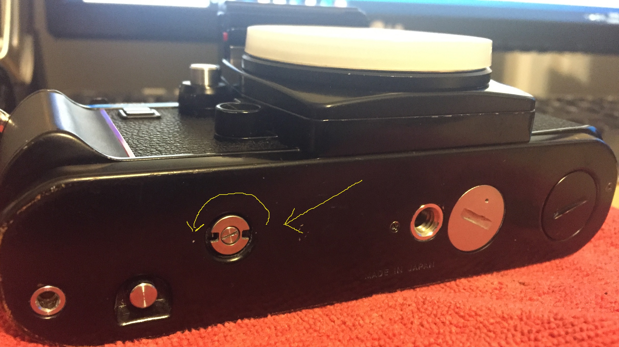

When the back is opened I think the take up spool was fairly firm , and the the part with the two cogs on is fixed solid .
When the rewind release on the bottom is press , both turn freely .
When the back is shut , the rewind button remains pressed in , rather than popping back out , and the film advance lever is still unable to be moved beyond the first twenty or so degrees .
That’s not right. It’s wind mechanism is jammed. Check the “door closed” lever on the top rail of the door housing. That tells camera to reset the rewind button and put the wind lever back in action.
Figure that out first rather than fussing over shutter cocking and meter operation.

You asked if the camera had to be cocked before the meter works; I said NO it doesn't have to be cocked before the meter works.
If that motor drive connector is immovable CCW with the shutter button pressed, it is almost certainly jammed.
True, but Not worthy it if the wind mechanism is jammed. Unless your thinking that might unjam it. I’m no so sure if it would or not.
That was my thought; it might possibly unjam it, but then again, it might not.
I think the indisputable clue of a wind mechanism jam is that the rewind button isn’t popping out...
