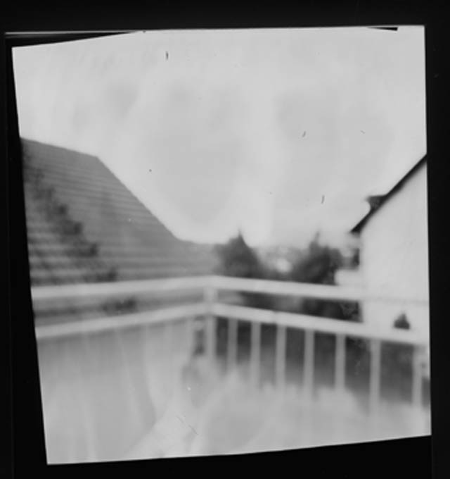

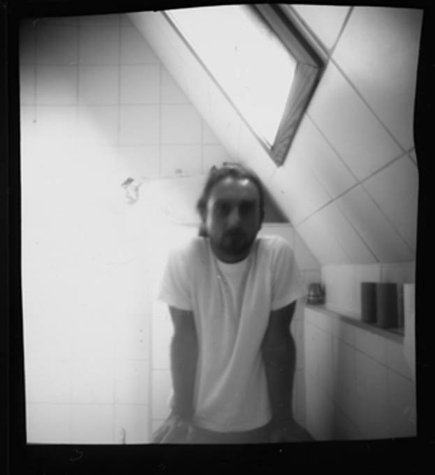

I made the first test today. 1 min exposute:
But it is not in focus at all. Now I don't know if the hole is too big or too small. Or if the problem is something else. Maybe the problem is the paper going forwards?
If that is full bright sunshine in a white bathroom then 1 minute might be about right. Otherwise it seems like too short an exposure for a camera that is more than f/300 and a paper negative indoors. I'm guessing the pinhole might be too big. But it seems to be too much... I think it would have to be too big by a lot to produce this level of blur. Maybe the camera moved? I advise to try again, careful not to move the camera before spending time on another pinhole.
I actually calculated it again and now it seems to be f/36.
This seccond shot was 2 sec about. Bright day but clouds hiding the sun.
I am sure the camera didn't move at all. I will try make a hole smaller on a black hard paper to cover the original hole.
I'd use the pinhole calculator others have posted and find the 'optimum' pinhole size and go for that. Remember, they won't be terribly sharp no matter. I thought the first one was interesting the way it was.
