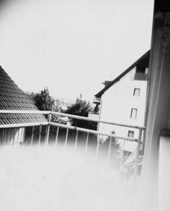

It's is sharp now:
It is f200, 45sec exposure.
I think the white part was a light leak which I can fix easy. :smile:
And as the test show it is ISO 6.

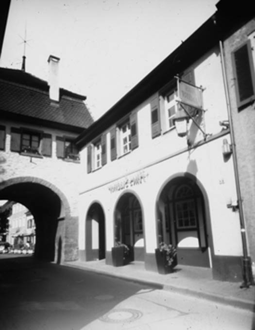

This two images were taken with a 0.420mm pinhole and the same time exposure 25min.
Do you think the flare is actually UV light. If I use UV filter does it solve this flare problem?

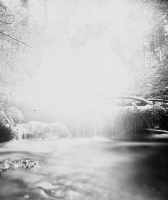

And this is from 0.390mm pinhole:
My first guess would be light reflections inside the camera. Did you paint the inside matt black and cover the metal of the pinhole with black tape?
Or did you take the photo into direct sunlight? I supose you don't have light leaks?

I don't have light leak.
I covered the metal around the pinhole but a little bite is not covered. Or maybe the larger hole which is curved may reflect the light. I will try to correct it.
Edited:

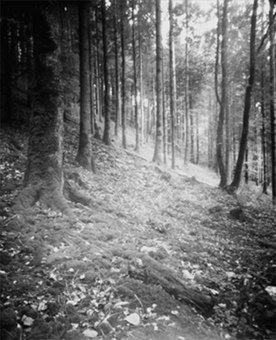

Actually I don't think there is any reflection inside because these photos doesn't have flare:
This flare seems to come from straight sky light, but none of them were direct from sun light.

I don't know. I have seen something like that when the sun reflected into the pinhole. One of my cameras has a 1/4" drilled hole in the side of a can, and the pinhole is taped inside the can. The edges of the 1/4" hole are shiny, and a glint of sun can reflect directly onto the pinhole. It causes something similar.
The exposure in the 2nd one looks very good.
I like UV reflection in the air or mist, but I don't think it could be that strong.
