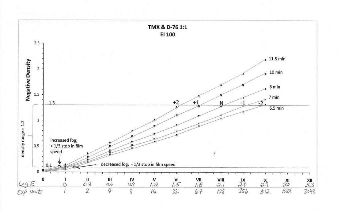

Apart from all that, it's good advice to expose the wedge in the camera to submit the wedge and the film to the same equipment that will be used in practical applications.

I'm not here to contest your math or the graph, or get into the rightness or wrongness of AA and the ZS, that's never been my intention, there's plenty of that going around. The info you submit is surely interesting but it doesn't prove anything as far as I can tell, IMO.
I can speak only of my own practical field applications and your assertions simply can't be confirmed by me. I have no added density in my shadow placements (BTW, I place shadows from zone I to IV, not always 4 stops down, as you suggested, why so inflexible an application?) as a result of flare. Or if it is there, then it is so small as to be irrelevant so that not even my densitometer says that my Zone II placement has a density of almost Zone III or more. Therefore, I have to believe that the testing certainly does take all the factors involved (aperture, shutter, flare, processing, etc...) and places them in my direct control when I develop my negatives to the same density range each time, no matter if it is +2, +1, N, -1, -2, or -3 development. I take the traditional ZS approach and develop to a range of 1.2, it works for me so far. I have one attachment that shows the range I develop to.
I never implied that the technique doesn't produce quality images. I am saying that the theory is wrong. As they say in Princess Bride, "I don't think that means what you think that means." There is a distinction between the concept of film speed and the pragmatic act of making an exposure. I'm trying to discuss the concept of film speed. It's immaterial whether technique A or B works for you or not. BTW, film curves are practically meaningless on their own. The key is in the interpretation. Look at your own curves. As I've said, tone reproduction theory (that means lots of real world testing by scientists) show that the average scene produces an average flare factor of at least one stop. That means that a seven stop scene will appear as a six stop scene at the film plane. In other words, you are processing film for a six stop range for normal even though the actual scene is seven stops. Look at your own curves for normal. What is the density for Zone VII? That value is consistent with the ISO standard in determination of paper grades. And in case you are not aware, Contrast Index or slope is a way of determining density range (i.e. the comparative math I did). Speaking of Contrast Index, a fixed flare value can't be used to find the aim Contrast Index over a range of various subject luminance ranges because the average flare value changes with a change in the subject luminance range. A fact many systems miss in their contrast determination (Way Beyond Monochrome for one).
You've also misunderstood my statement about placement. Traditional ZS film speed testing is to meter the card and stop down four stops to find the speed point for Zone I. This is about testing and not about shooting. They are two different subjects.
Have you ever tested specifically for flare? It's there and it's variable. From your posts, I have the impression you've limited yourself to the world of the Zone System. There are other books out there. Adams didn't invent sensitometry. In The Negative's acknowledgments, Adams thanks C.E. Kenneth Mees for "the immense help I received." Mees set-up and ran Kodak's R&D department. Loyd Jones ran the physics department under Mees and is responsible for pretty much all of what we consider modern exposure and tone reproduction theory. This includes film speed, log exposure range of papers, average subject luminance range, average daylight illuminance, and much more. He chaired the subcommittee on colorimetry which created the definition of color (yes, a true definition of color didn't exist until 1942 and for the record, color is psychophysical). I've sourced some of Jones papers over on the Understanding ISO thread for those interested. Who do you think understands the principles of photography more, Adams or Jones? If you want to better understand the principles of photography a good book to start with is Materials and Processes.
It so happens that I've done some flare testing. One of the tests used a shadow box which is a dark box with a shaded opening. The reason for the box is that in a zero flare environment, the box interior won't produce any detectable density. I then made a number of cards consisting of different tones and combination of tones. I cut a hole in the center of the cards to make a space for the shadow box opening. I took a reading off an 18% gray card and opened up 1/2 stop from the recommended reading (the reason can wait for another thread). The exposure didn't change for any of the tests. The only variable was the different cards place around the shadow box opening. If no flare existed, the dark box value should be the same as the film base. If flare didn't vary depending on the surrounding differences in the luminance range and distribution of the luminance range, then all the results would be at the same density. The attached graph illustrates the results. The 0.39 log-H difference equals 1 1/3 stop exposure difference caused by the influence of flare.
BTW, how does using a camera to contact a step tablet reflect real world use? The actual subject is on the outside of the camera. Don't get me wrong. I'm not talking about the practical and appropriate method of contacting a step tablet. I'm not even talking about the question of evenness with testing a step tablet in a camera, but your statement that you do it because it is "the same equipment that will be used in practical applications" isn't logical. From your previous posts, I know you don't incorporate camera exposure values into your test. So, how is this approach in exposing a wedge different than simply using an enlarger (not that you can't figure exposure values with an enlarger)?
Also, you have never mentioned how you actually calculate film speed once you determine the speed point.
I'm not questioning your intelligence. I just believe you have limited yourself to a single subset of photography, namely the Zone System. There's nothing wrong with that. Everybody's at different levels of expertise, interest, and experience and there's nothing wrong with that either. I also know people tend to hear things when they are ready to hear them. What I question is not being open to the facts.
